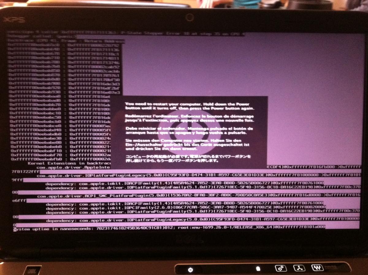

drdeviant Posted May 18, 2012 Share Posted May 18, 2012 @drdeviant, tjpapas is right, just edit the plist file. I changed it that way in the package but changed it back this afternoon after birdibird pointed out that people need it . I ended up doing something silly but to cut a long story short, I used bootrec fixmbr and fixboot to get into the Windows side which worked, and tried to get back into OS X using the RBootLE CD using -v -f GraphicsEnabler=No cpus=1 busratio=20 flags but I get the attached error. Can anyone help me please? Am fairly new to this, clearly. Link to comment https://www.insanelymac.com/forum/topic/257950-guide-dell-xps-15-l502x-early-2011-snow-leopard-install-possibly-l702x-too/page/61/#findComment-1821402 Share on other sites More sharing options...
DoiX Posted May 18, 2012 Share Posted May 18, 2012 @drdeviant, you didn't install the new DSDT... anyway boot with -s then write /sbin/mount -uw / cd /System/Library/Extensions/FakeSMC.kext/Contents/Plugins/ rm -R GeForceX.kext kextcache -system-prelinked-kernel reboot @darren cox, the DSDT fixes the restart only... i have no idea whatsoever about A06+ bioses and the sleep bug... Link to comment https://www.insanelymac.com/forum/topic/257950-guide-dell-xps-15-l502x-early-2011-snow-leopard-install-possibly-l702x-too/page/61/#findComment-1821406 Share on other sites More sharing options...
drdeviant Posted May 18, 2012 Share Posted May 18, 2012 @drdeviant, you didn't install the new DSDT... anyway boot with -s then write /sbin/mount -uw / cd /System/Library/Extensions/FakeSMC.kext/Contents/Plugins/ rm -R GeForceX.kext kextcache -system-prelinked-kernel reboot @darren cox, the DSDT fixes the restart only... i have no idea whatsoever about A06+ bioses and the sleep bug... Hi DoiX - Similar thing happens with: -s -v -f GraphicsEnabler=No cpus=1 busratio=20 (Just -s alone didn't do much.) I did run the v7 installer so if that didn't install the DSDT then would it have worked still after that? Because 10.7.4 worked fine until I messed up the MBR / boot manager. Link to comment https://www.insanelymac.com/forum/topic/257950-guide-dell-xps-15-l502x-early-2011-snow-leopard-install-possibly-l702x-too/page/61/#findComment-1821417 Share on other sites More sharing options...

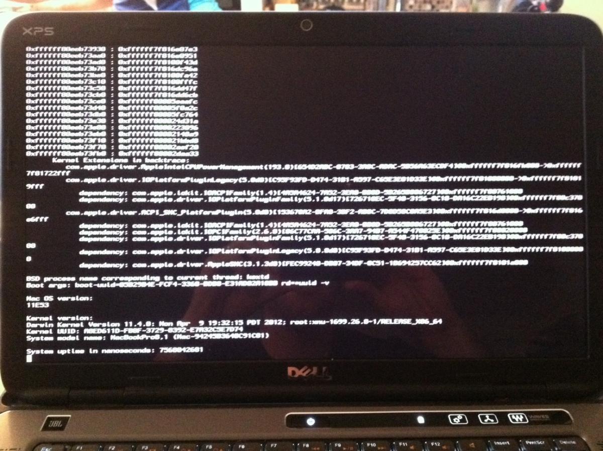

DoiX Posted May 18, 2012 Share Posted May 18, 2012 I did run the v7 installer so if that didn't install the DSDT then would it have worked still after that? Because 10.7.4 worked fine until I messed up the MBR / boot manager. -v -f GraphicsEnabler=No cpus=1 busratio=20 < this was only for installing from iAtkos dvd. Boot just with DSDT=/Extra/DSDT14May.aml -v That kernel panic is caused by GeForceX.kext plugin because you booted with the old dsdt where Nvidia GPU isn't deactivated or with no DSDT... Now, the V7 installer copies the DSDT into Extra/ folder... so i'll go ahead and assume you have another DSDT file in your root partition / so chimera loads that up. So... just boot with the command i posted couple lines before. If anyone wonders, i've added that GeForceX.kext for when our Nvidia GPUs will be working. Link to comment https://www.insanelymac.com/forum/topic/257950-guide-dell-xps-15-l502x-early-2011-snow-leopard-install-possibly-l702x-too/page/61/#findComment-1821436 Share on other sites More sharing options...
drdeviant Posted May 18, 2012 Share Posted May 18, 2012 -v -f GraphicsEnabler=No cpus=1 busratio=20 < this was only for installing from iAtkos dvd. Boot just with DSDT=/Extra/DSDT14May.aml -v That kernel panic is caused by GeForceX.kext plugin because you booted with the old dsdt where Nvidia GPU isn't deactivated or with no DSDT... Now, the V7 installer copies the DSDT into Extra/ folder... so i'll go ahead and assume you have another DSDT file in your root partition / so chimera loads that up. So... just boot with the command i posted couple lines before. If anyone wonders, i've added that GeForceX.kext for when our Nvidia GPUs will be working. Ok - Looks like its falling over on the geforce still. It booted with DSDT=/Extra/DSDT14May.aml -v resulting in the screenshot error. Since I can edit the file names via Windows, I also tried renaming DSDT14May.aml -> DSDT.aml, with just -v but got the same thing. Here is what's in the root directory: .DocumentRevisions-V100 .MobileBackups .dbfseventsd .file .voodoops2 Applications Developer Extra Library Network SSDT.aml <--- something to do with this? No DSDT here. System Users updatecaches Link to comment https://www.insanelymac.com/forum/topic/257950-guide-dell-xps-15-l502x-early-2011-snow-leopard-install-possibly-l702x-too/page/61/#findComment-1821444 Share on other sites More sharing options...
DoiX Posted May 18, 2012 Share Posted May 18, 2012 What the... Boot with DSDT=/Extra/DSDT14May.aml -v GraphicsEnabler=No Link to comment https://www.insanelymac.com/forum/topic/257950-guide-dell-xps-15-l502x-early-2011-snow-leopard-install-possibly-l702x-too/page/61/#findComment-1821446 Share on other sites More sharing options...
