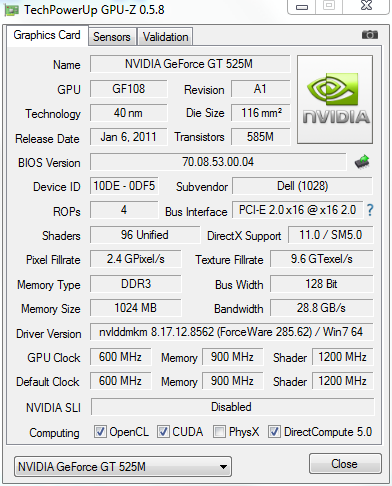

Alright noob moment: How do I determine how much VRAM that I have? I've looked in windows but it only gives the properties of the Intel graphics card
Looks like 1GB
Wait: guess you don't need it now that you deleted your post? lol
Either way, posted a GPU-Z screenshot just in case you need more info
Edited by AKennedy_4
Yeah, the second i posted i facepalmed myself :D i just googled versions of l502x and found what i needed :P thanks anyway. Since you have GPU-Z, could you try to dump the bios? (click the small icon, on the right of the BIOS Version field) I get an error on windows, need confirmation it's not just me.

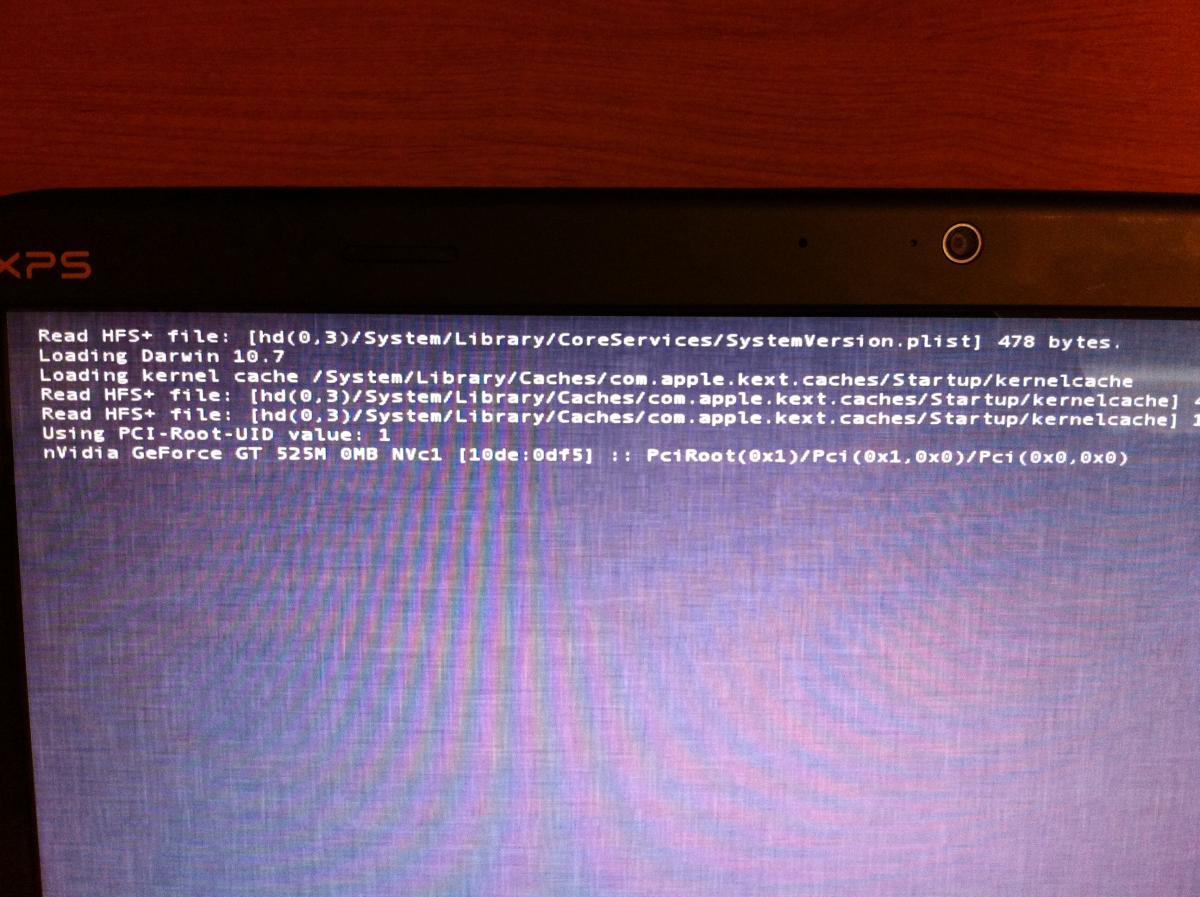

Update: Well, after months of on and off work, i managed to use the nvidia GPU on OS X for a brief but wonderful 3 seconds then it rebooted.
1. Why only 3 seconds? - because in the 25 restarts/reboots i went through, only one of them actually got me through the verbose mode to the screen to see my wallpaper before suddenly restarting.
NVDAResman is causing this coupled with my DSDT. The way the card is activated is imperfect and i can't find the proper way without a full SSDT dump from someone with 3D display or modded bios and nvidia set as primary to guide myself from, there isn't exactly a cheat sheet for the nvidia ACPI functions.
2. How did i manage? - using a modified bios dump (UseNvidiaROM=Yes) coupled with GraphicsEnabler=Yes, modified IOPCIFamily.kext and a new DSDT that activates the nvidia framebuffer, or at least i think it is the FB.
3. Can it be done? - via the path i went... yes it can be done, but frankly, i think it's easier to just mod the freaking bios. But if i can get my hands on the before mentioned SSDT dump... there's a good chance that it will be the missing piece of the puzzle.
