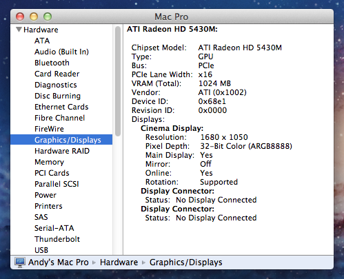

gibsonic Posted July 21, 2011 Share Posted July 21, 2011 Visiontek AMD HD5450 works (with full CI/QE) using ATI5000Injector.kext (originally developed for SL) and copied to /S/L/E in Lion. You are a lifesaver. My Sapphire HD5450 is now working (almost) perfectly with Lion. Just used the download from here dropped it in /SL/E, turned GraphicsEnabler back on and all is well: DVD Player and Geekbench are working perfectly. Card is identified by Chameleon as an ATI Radeon HD 5430M and that's what appears in System Profiler. The almost is because the display now won't sleep. It stops updating when display sleep is requested (current image is frozen on display) and updates as normal once you have left display sleep by tapping a key. Thank you for the pointer! Link to comment https://www.insanelymac.com/forum/topic/256103-supported-graphics-cards-with-full-qeqi/page/8/#findComment-1718935 Share on other sites More sharing options...
