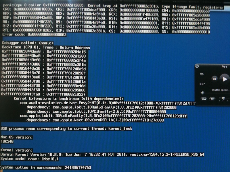

THX Posted July 14, 2011 Share Posted July 14, 2011 Sleep doesn't working correctly with ESI Juli@ for me. Got kernel panic after waking up and when try to play some audio. Any suggestions? Link to comment https://www.insanelymac.com/forum/topic/25145-esi-juli-envy-24-with-osx86-any-progress/page/38/#findComment-1714475 Share on other sites More sharing options...

tuxianer Posted July 24, 2011 Share Posted July 24, 2011 Sound is working for me in Lion. I use Envy24HT. But if i wake up from sleep the sound is disabled. kextload does not fix the problem. Link to comment https://www.insanelymac.com/forum/topic/25145-esi-juli-envy-24-with-osx86-any-progress/page/38/#findComment-1721286 Share on other sites More sharing options...

tuxianer Posted July 24, 2011 Share Posted July 24, 2011 Can anybody test if kextload after sleep ist possible? because if I don´t unload the kext before sleep, i get a KP (the problem is already known and thats the workaround for it). Edit: System Log after loading: 24.07.11 23:36:30,000 kernel: WaitForI2C() failed! 24.07.11 23:36:35,000 kernel: WaitForI2C() failed! 24.07.11 23:36:41,000 kernel: WaitForI2C() failed! 24.07.11 23:36:46,000 kernel: WaitForI2C() failed! 24.07.11 23:36:51,000 kernel: WaitForI2C() failed! 24.07.11 23:36:57,000 kernel: WaitForI2C() failed! 24.07.11 23:37:02,000 kernel: WaitForI2C() failed! 24.07.11 23:37:08,000 kernel: WaitForI2C() failed! 24.07.11 23:37:13,000 kernel: WaitForI2C() failed! 24.07.11 23:37:18,000 kernel: WaitForI2C() failed! 24.07.11 23:37:24,000 kernel: WaitForI2C() failed! 24.07.11 23:37:29,000 kernel: WaitForI2C() failed! 24.07.11 23:37:34,000 kernel: WaitForI2C() failed! 24.07.11 23:37:40,000 kernel: WaitForI2C() failed! 24.07.11 23:37:45,000 kernel: WaitForI2C() failed! 24.07.11 23:37:51,000 kernel: WaitForI2C() failed! 24.07.11 23:37:56,000 kernel: This specific Envy24HT card with subvendor id ffffffff is not supported! 24.07.11 23:37:56,000 kernel: This Envy24HT driver only supports Terratec Aureon Sky, Space, Phase 22 and 28, M-Audio Revolution 5.1/7.1 and ESI Juli@ 24.07.11 23:37:56,000 kernel: Something failed! Thanks. Link to comment https://www.insanelymac.com/forum/topic/25145-esi-juli-envy-24-with-osx86-any-progress/page/38/#findComment-1721612 Share on other sites More sharing options...

fredemmott Posted August 26, 2011 Share Posted August 26, 2011 Hey, patched Envy24HT kext fixing sleep/wake issues available here: https://github.com/fredemmott/Envy24HT (click 'Downloads', then pick the .kext.tar.bz2' underneath 'Download Packages', not either of the top options) Specific fix: https://github.com/fredemmott/Envy24HT/comm...333396e6b9b08bb WARNING: I've only tested this on 64-bit Lion with a Terratec Phase 22 card. Your milage may vary. Link to comment https://www.insanelymac.com/forum/topic/25145-esi-juli-envy-24-with-osx86-any-progress/page/38/#findComment-1740459 Share on other sites More sharing options...
20S7737 Posted August 28, 2011 Share Posted August 28, 2011 Great work, fredemmott I'm suffering from sleep/wake issues with Envy24 driver. Sleepwatcher is not a complete solution for me. Could you patch Envy24_SL.0.22 too? Thanks. Link to comment https://www.insanelymac.com/forum/topic/25145-esi-juli-envy-24-with-osx86-any-progress/page/38/#findComment-1741036 Share on other sites More sharing options...
cdn Posted October 5, 2011 Share Posted October 5, 2011 Can anybody test if kextload after sleep ist possible? because if I don´t unload the kext before sleep, i get a KP (the problem is already known and thats the workaround for it). Hi Tuxianer. Sorry for reviving an old thread but have you (or anyone else) come up with a solution to your problem? I have the same error with my Audiophile 2496. Link to comment https://www.insanelymac.com/forum/topic/25145-esi-juli-envy-24-with-osx86-any-progress/page/38/#findComment-1756196 Share on other sites More sharing options...
