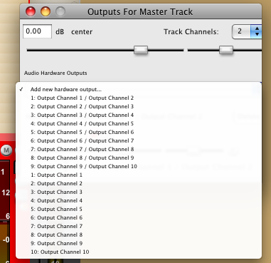

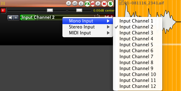

axel99092 Posted November 16, 2008 Share Posted November 16, 2008 Let me know if this works for you. Again, cards that are NOT listed will NOT work, no need to try since the subvendor ID check will fail. Hi, thank you for your work! I tested it on 10.5.4 with Audiophile 2496. My DAW (Reaper) show me 12 Inputs and 10 Outputs. Input recording works on channel 1 and channel 2, also on channel 11 and 12 (but here is the signal from both inputs). Output is not working. Later I will test it on my second computer. Here I have a Delta 66. edit: Now I have tested it with the Delta 66. Reaper shows the same, 12 Inputs and 10 Outputs. Inputs 1 - 4 recording works! Outputs 1 - 4 works! On Input 11 & 12 the same as on the 2496. All Inputs are on this channel. But that is not a problem. I can disable the channels 5 - 12. Reaper shows latency 3.5ms I have make you a donation. Now I can say goodbye to Windows... Link to comment https://www.insanelymac.com/forum/topic/25145-esi-juli-envy-24-with-osx86-any-progress/page/10/#findComment-968293 Share on other sites More sharing options...

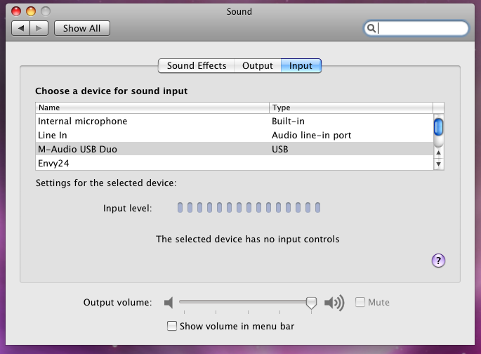

arqui Posted November 17, 2008 Share Posted November 17, 2008 Do you not see it in System Preferences / Sound? Here is my picture and there is Envy24. I cant see it there in that sound preferences tab. But as audiodriverwriter said it seems that mine isn't supported yet! So have to wait and see! Thanks Link to comment https://www.insanelymac.com/forum/topic/25145-esi-juli-envy-24-with-osx86-any-progress/page/10/#findComment-968841 Share on other sites More sharing options...

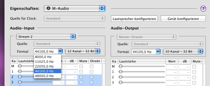

axel99092 Posted November 17, 2008 Share Posted November 17, 2008 Ok, people with the M-Audio Delta 2496 card, please test version 0.2.0 from the website.Please report if audio output is now working. Remember to select the Envy24 version, not the Envy24HT version for this card! Audiophile 2496 output works now. that's great! (only in 32bit) Link to comment https://www.insanelymac.com/forum/topic/25145-esi-juli-envy-24-with-osx86-any-progress/page/10/#findComment-969406 Share on other sites More sharing options...

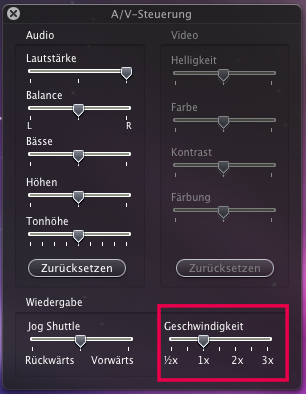

Aram Vartanian Posted November 17, 2008 Share Posted November 17, 2008 Same to me! The strange thing is that it's playing on a slower tempo with QuikTime! But with other products like GarageBand it's all running fine! :censored2: Thanks!!!! Link to comment https://www.insanelymac.com/forum/topic/25145-esi-juli-envy-24-with-osx86-any-progress/page/10/#findComment-969446 Share on other sites More sharing options...
axel99092 Posted November 18, 2008 Share Posted November 18, 2008 Same to me! The strange thing is that it's playing on a slower tempo with QuikTime! But with other products like GarageBand it's all running fine! Thanks!!!! Go to Quicktime, command+K and look that it is on 1x Link to comment https://www.insanelymac.com/forum/topic/25145-esi-juli-envy-24-with-osx86-any-progress/page/10/#findComment-969546 Share on other sites More sharing options...
