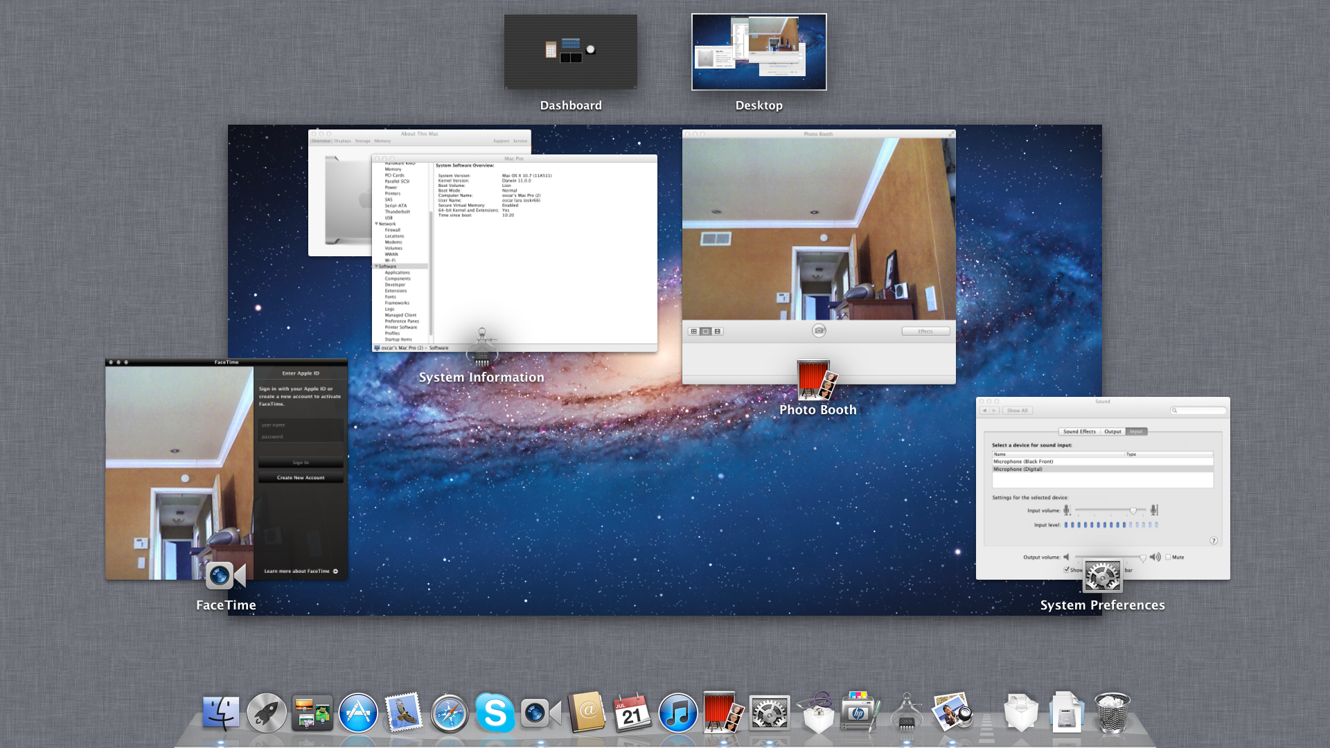

I had installed LION on my Dv8 , no problems , everything works
Camera
Wi-Fi Wireless
Sound : with voodoo kext , can't control volume , mic works , this needs upgrade
Graphics at full resolution, have not tried to do the brightness + -
FaceTime works
All USB's work
Created a new DSDT with auto patcher after installation with all fixes
Battery works with voodoo battery kext
Sleep works , : closing and opening screen wakes and sleeps with the latest sleepEnabler kext
The only problem : it needs a new " Mach-Kernel" to fix the Lapic problem , since we can't start without the cpus=1 and the busratio=12 , making this awesome system run on only one core .
so if we could get the Higher " GODS" to fix our kernel and fix our audio I could make an easy guide.
