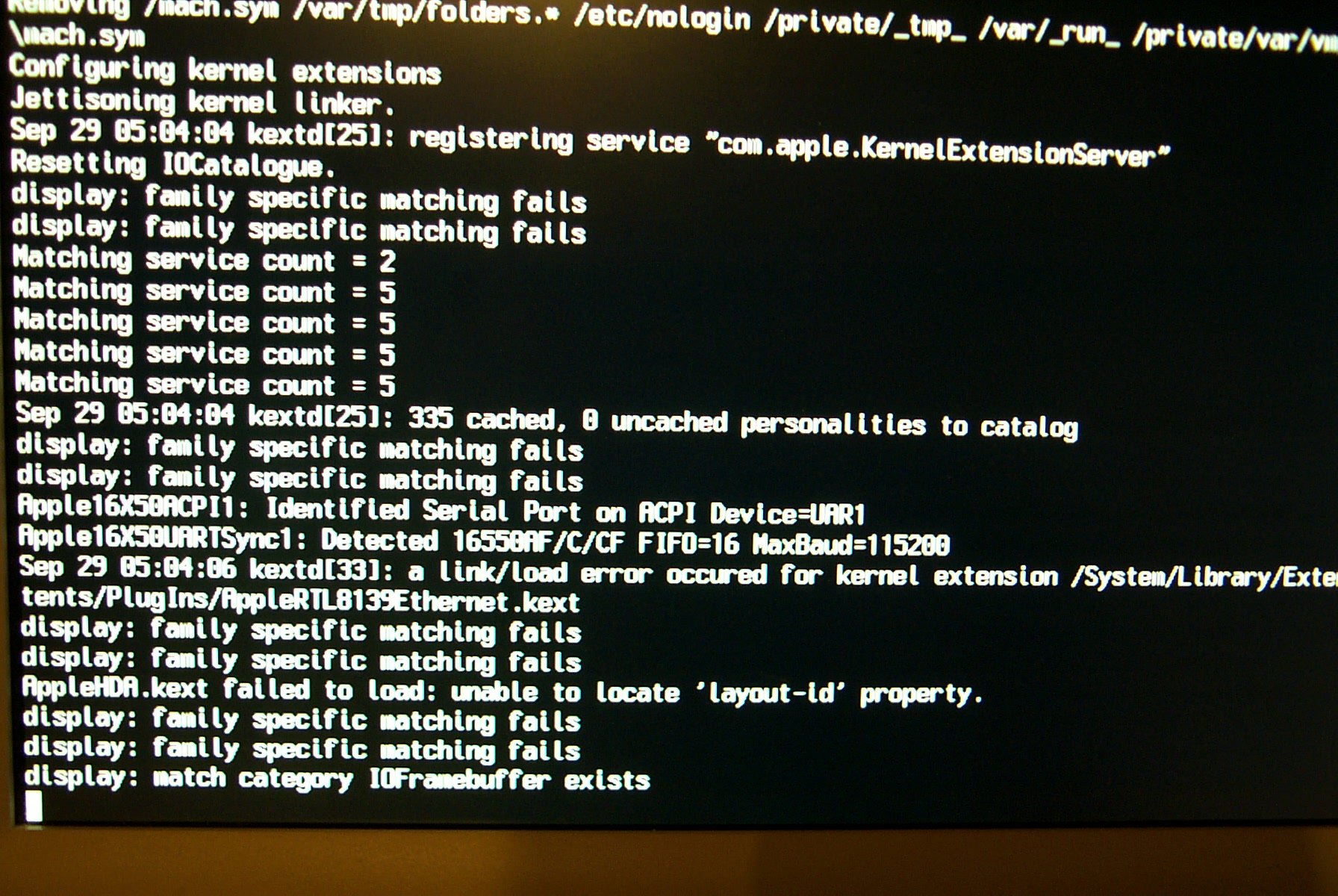

alessiof Posted September 29, 2006 Share Posted September 29, 2006 Hi ! I'm running into some troubles installing over this board, let me explain my setup: Conroe945G-DVI DVI riser card installed Monitor connected to the onboard VGA (no DVI) IDE HDD, master DVD WR, slave No SATA Install went absolutely smooth, got b0 error at first boot: fixed the mbr, system is booting. After root device has been mounted and journal checked I'm getting display: family specific matching fails (repeated a few times) then display: mach category IOframebuffer exists Then boot "goes to sleep": waited for 10 minutes, no luck. In graphic mode mouse is still usable, while waiting. Any idea about this behaviour ? P.S. I'm running latest bios (1.2) and vga is set in fixed memory mode, 128 MB TNX!!! Link to comment https://www.insanelymac.com/forum/topic/24637-asrock-conroe945g-dvi/page/12/#findComment-198025 Share on other sites More sharing options...
alessiof Posted September 29, 2006 Share Posted September 29, 2006 Here is the screenshot ... P.S. I have downgraded to bios 1.1, same results ... Link to comment https://www.insanelymac.com/forum/topic/24637-asrock-conroe945g-dvi/page/12/#findComment-198034 Share on other sites More sharing options...
TopazBar Posted September 29, 2006 Share Posted September 29, 2006 Before I can help, what version of OSX did u install? Did u do custom install? Try booting in single user mode (-s). Try booting in safe mode (-x). I think u r almost home free. I think you just need to re-install with GMA900 support checked from custom install option. Link to comment https://www.insanelymac.com/forum/topic/24637-asrock-conroe945g-dvi/page/12/#findComment-198054 Share on other sites More sharing options...

alessiof Posted October 1, 2006 Share Posted October 1, 2006 Before I can help, what version of OSX did u install? Did u do custom install? Try booting in single user mode (-s). Try booting in safe mode (-x). I think u r almost home free. I think you just need to re-install with GMA900 support checked from custom install option. Tnx for your suggestions: actually i'm downloading the Mac-OS-X-10.4.6-AMD.Intel-(JaS)-ISO-Repack Hash code 74D07F8CBB45F00D4E3EC6B406399B5EE463A4CD Anyone tried this with the board ? What packages have you selected in custom install? Will let you know! P.S. while downloading I'm testing the board with XP: it seems to me that video quality (I'm using VGA, not DVI) is quite low. On my Philips LCD at native resolution 1280X1024@75Hz) small text, black on white background, flickers a lot. Link to comment https://www.insanelymac.com/forum/topic/24637-asrock-conroe945g-dvi/page/12/#findComment-199316 Share on other sites More sharing options...

alessiof Posted October 1, 2006 Share Posted October 1, 2006 I'm writing this on my new Hackintosh!!! Here is a report: Installed using the 1.4.7 repack ISO, then I got a "crashed login screen" upon reboot. Restarted in safe mode, browsed trough the install DVD, applied the GMA900 patch; this time all went smooth: QE active and 1280X1024 resolution! Modified the azalia kext for sound that now is working pretty good. My sound blaster audigy usb is not working at all, even if detected and shown in the control panel. Had SERIOUS problem installing from a DVD writer! I burnt the image in XP using the writer, but it was disc not booting .... then I switched the writer with a dvd reader: this time disc was booting to the install process. Even now, that i have reinstalled the burner, my osx disc is not readable ... a mistery! Anyhow i had a load of problems even XP with my IDE chain, probably i should switch to a sata HDD and leave the writer as singe device over the IDE bus. Anyone is using the board with an ide hdd (ultradma5) and a dvd writer (ultradma2) ? Any problem reported? Tnx to anyone who helped! Link to comment https://www.insanelymac.com/forum/topic/24637-asrock-conroe945g-dvi/page/12/#findComment-199518 Share on other sites More sharing options...
