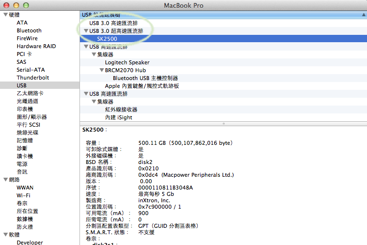

mmgarcia30 Posted October 18, 2012 Share Posted October 18, 2012 This is my patched 1.0.10 PXHCD.kext. Besides the code patch up bypass the ID check, you need to remove the PCIMatchedFamily info.plist entry.  One point of note, this driver still does NOT support USB 3.0 HUBS.  Enjoy.....  Thank you mate  With your modified LaCie 1.0.10 kext now I've a Woster ExpressCard USB 3.0 (NEC ) up & running in my C2D MBP 10.8.2  But mine two USB 3.0 external hardrives (WD My Book Essential USB 3.0 and Samsung M3) both reports a maximun speed of 480mb/s the same that if they are plugged to a USB 2.0 port.  [b]USB Super-Speed Bus: [/b] Host Controller Location: Built-in USB Host Controller Driver: PXHCD PCI Device ID: 0x7fa000000194 PCI Revision ID: 0x7fa000000003 PCI Vendor ID: 0x7fa000001033 Bus Number: 0x5c [indent=1][b]My Book 1140: [/b][/indent] [indent=2]Capacity: 2 TB (2.000.365.289.472 bytes) [/indent] [indent=2]Removable Media: Yes [/indent] [indent=2]Detachable Drive: Yes [/indent] [indent=2]BSD Name: disk2 [/indent] [indent=2]Product ID: 0x1140 [/indent] [indent=2]Vendor ID: 0x1058 (Western Digital Technologies, Inc.) [/indent] [indent=2]Version: 10.12 [/indent] [indent=2]Serial Number: 5743415A4146313530363731 [/indent] [indent=2][color=#ff0000]Speed: Up to 480 Mb/sec [/color][/indent] [indent=2]Manufacturer: Western Digital [/indent] [indent=2]Location ID: 0x5c100000 / 2 [/indent] [indent=2]Current Available (mA): 500 [/indent] [indent=2]Current Required (mA): 2 [/indent] [indent=2]Partition Map Type: MBR (Master Boot Record) S.M.A.R.T. status: Not Supported [/indent] [indent=2]Volumes: [/indent] [indent=3][b]My Book: [/b][/indent] [indent=3]Capacity: 2 TB (2.000.364.240.896 bytes) [/indent] [indent=3]Available: 1,27 TB (1.267.986.489.344 bytes) [/indent] [indent=3]Writable: Yes [/indent] [indent=3]File System: Tuxera NTFS BSD [/indent] [indent=3]Name: disk2s1 [/indent] [indent=3]Mount Point: /Volumes/My Book [/indent] [indent=3]Content: Windows_NTFS[/indent] [indent=2] [/indent]  Any clues about why is this? Both disks works at full speed if I start the MBP in the bootcamp partition. do you need something else or more data?  Many thanks again Link to comment https://www.insanelymac.com/forum/topic/236209-lacie-usb-30-drivers-are-here-for-os-x/page/9/#findComment-1861280 Share on other sites More sharing options...
