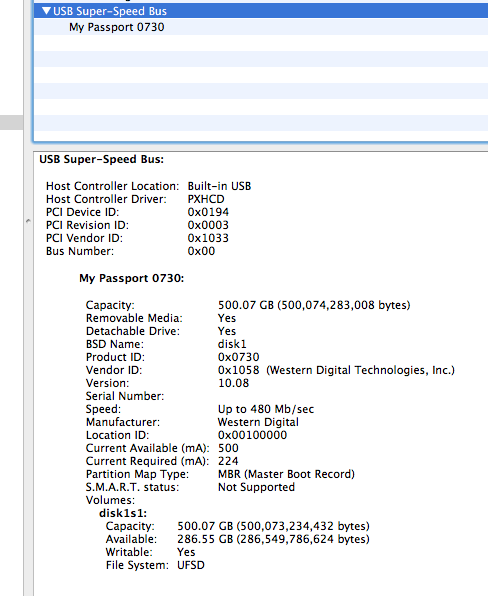

ChiemY Posted November 23, 2010 Share Posted November 23, 2010 Hi, Just for information: I try the modbin patch on MacBook Pro 15 Late 2008 with: - Storeva ExpressCard USB 3.0 2 ports (30€ from macway.com) (need to plug one usb2.0 on the card for more power) - Western Digital My Passport Essential 500 Go USB 3.0 / USB 2.0 (from fnac.com) If I insert or remove the ExpressCard with PXHCD.kext (lacie or modbin), the macbook freeze. I need to put the ExpressCard before and use: /sbin/kextload -v /System/Library/Extensions/PXHCD.kext (check "sudo dmesg | grep PXHCD" for more log) Read Write About 30mo/s on usb2 and 60mo/s on USB3. Regards Edit: I try the caldigit driver below and changes values in plist, but card was not working or crash the kernel. Link to comment https://www.insanelymac.com/forum/topic/236209-lacie-usb-30-drivers-are-here-for-os-x/page/4/#findComment-1590243 Share on other sites More sharing options...

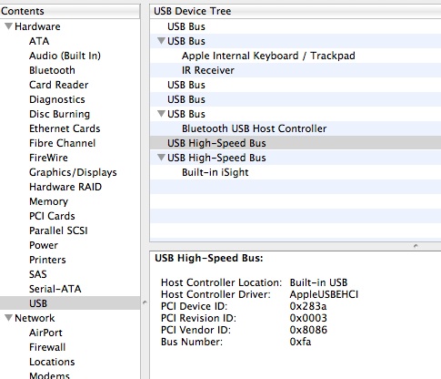

splonk Posted December 6, 2010 Share Posted December 6, 2010 Are there similar bridging considerations with ExpressCards? I cannot get a Freecom NEC based card to register in my Macbook Pro with the patched driver. Link to comment https://www.insanelymac.com/forum/topic/236209-lacie-usb-30-drivers-are-here-for-os-x/page/4/#findComment-1597882 Share on other sites More sharing options...
cartri Posted December 6, 2010 Share Posted December 6, 2010 Are there similar bridging considerations with ExpressCards? I cannot get a Freecom NEC based card to register in my Macbook Pro with the patched driver. Can you give us more information on what you are trying? I mean, what errors are you getting etc, screenshots, pastes etc Link to comment https://www.insanelymac.com/forum/topic/236209-lacie-usb-30-drivers-are-here-for-os-x/page/4/#findComment-1597923 Share on other sites More sharing options...

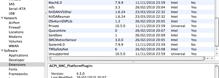

splonk Posted December 8, 2010 Share Posted December 8, 2010 There isn't too much to say. The card works under Bootcamp, so there are no hardware issues. It has the usual NEC chip but the kext will not load. I tried the same kext in a hackintosh desktop with the Asus card and the Superspeed port showed up promptly in Sysprofiler. Not so on the MBP with the Freecom card The ExpressCard icon shows in the menu with USB Controller as the only context menu entry apart from Power Off Card. No mention of the kext or any problems in the system logs, either. Link to comment https://www.insanelymac.com/forum/topic/236209-lacie-usb-30-drivers-are-here-for-os-x/page/4/#findComment-1599054 Share on other sites More sharing options...
