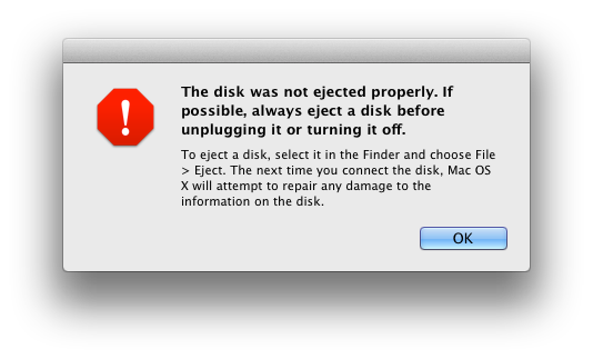

Powaking Posted July 3, 2011 Share Posted July 3, 2011 I haven't done a deep sleep but I notice time to time that when I wake my machine up from a sleep I get the error that the removable device was not ejected properly. But my drives do mount back up fine and work without issues. Link to comment https://www.insanelymac.com/forum/topic/236209-lacie-usb-30-drivers-are-here-for-os-x/page/6/#findComment-1707759 Share on other sites More sharing options...

rtrtrtrt Posted August 30, 2011 Share Posted August 30, 2011 I haven't done a deep sleep but I notice time to time that when I wake my machine up from a sleep I get the error that the removable device was not ejected properly. But my drives do mount back up fine and work without issues. Installed an Asus U3S6 card into a Macpro 2008 running 10.6.8 with all updates. Using the latest 1.0.7 Lacie drivers and the updated kext from genzai/modbin, I get the same result as Powaking. Will leave drive mounted and update if problems over next few days. -------------------- Update All fine with reading and writing files over last couple of days. Will use it as normal now and see how it goes - backups etc Link to comment https://www.insanelymac.com/forum/topic/236209-lacie-usb-30-drivers-are-here-for-os-x/page/6/#findComment-1742212 Share on other sites More sharing options...
