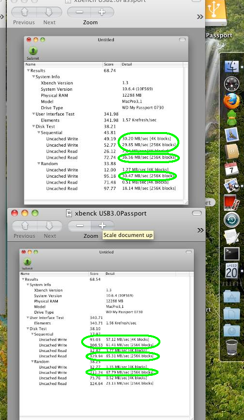

RemoteWorks Posted November 7, 2010 Share Posted November 7, 2010 Works in 64 bit kernel, but not up to USB3.0 standards. Did a bit of testing this AM: Will try it in 32 bit mode next. Looks to me that it just works fine max for usb 2 is 30mb/s as shown in the first xbench score But on the usb 3 port you see it's going to 60mb/s it is still a normal HD right, not a ssd? RW Link to comment https://www.insanelymac.com/forum/topic/236209-lacie-usb-30-drivers-are-here-for-os-x/page/2/#findComment-1578267 Share on other sites More sharing options...

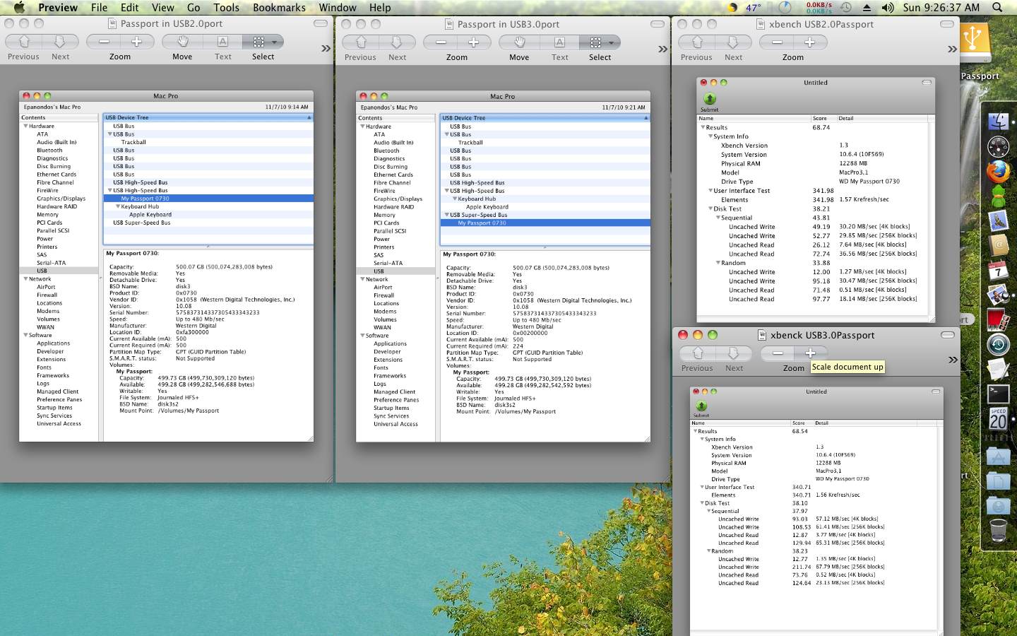

RemoteWorks Posted November 7, 2010 Share Posted November 7, 2010 Yes, but the speed shows up as "Up to 480 Mb/sec" for both the High-Speed USB 2.0 bus AND the Super-speed bus USB 3.0 ports - it should show much hugher for the 3.0 port. Also, the total xbench score for the USB 3.0 WD drive in the 3.0 port was .2 lower than in the 2.0 port - go figure. It should do a lot better than that! Genzai already reported that in the profiler it shows as 480mb/s The reason why your usb 3 test shows lower results, is because your got lower results on the sequential uncached read test. RW Link to comment https://www.insanelymac.com/forum/topic/236209-lacie-usb-30-drivers-are-here-for-os-x/page/2/#findComment-1578410 Share on other sites More sharing options...

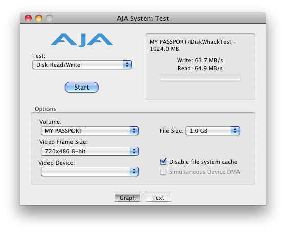

Going Bald Posted November 7, 2010 Share Posted November 7, 2010 Genzai already reported that in the profiler it shows as 480mb/sThe reason why your usb 3 test shows lower results, is because your got lower results on the sequential uncached read test. RW Granted, but given the "theoretical" speeds I would expect more. Even the AJA Test System only reports a doubling of speed. I guess I'm just a speed junky, lol. USB 2.0 . USB 3.0 Link to comment https://www.insanelymac.com/forum/topic/236209-lacie-usb-30-drivers-are-here-for-os-x/page/2/#findComment-1578437 Share on other sites More sharing options...
stellarola Posted November 7, 2010 Share Posted November 7, 2010 Granted, but given the "theoretical" speeds I would expect more. Even the AJA Test System only reports a doubling of speed. I guess I'm just a speed junky, lol. USB 2.0 . USB 3.0 Does the system sleep after plugging in the USB 3.0 device? -Stell Link to comment https://www.insanelymac.com/forum/topic/236209-lacie-usb-30-drivers-are-here-for-os-x/page/2/#findComment-1578448 Share on other sites More sharing options...

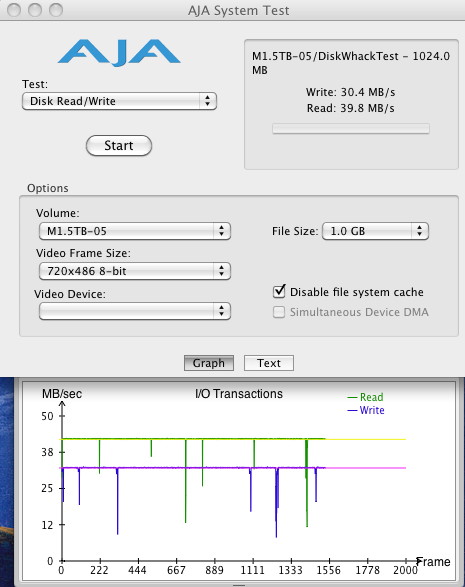

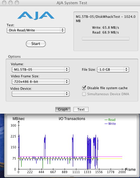

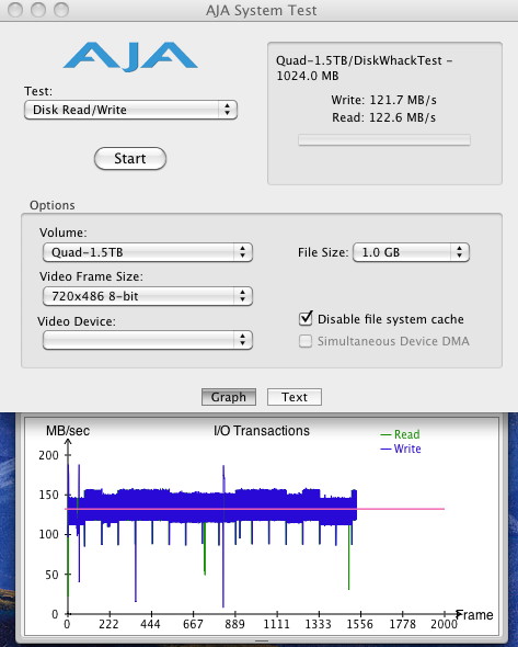

Rx4Mac Posted November 8, 2010 Share Posted November 8, 2010 I just finished tests with Modbin's patched PXHCD in the LaCie kext. I am using a CalDigit USB3 card. The key ( as stated by dasdasein... Thank You!) was to rebuild the cache using pfix v 3.1 after repairing permissions. All tests were done with a Seagate ST3500630AS 1.5TB drive using AJA System Test 32-bit Kernel SATA tests were done with the drive connected to motherboard SATA USB2 tests were done with the drive connected to motherboard USB2 FW400 tests were done with the drive connected to motherboard FW400 USB3 tests were done with the drive connected to CalDigit card The USB2 and FW400 external drive case is a MacAlly G-S350SUA The USB3 external drive case is a MacAlly NSA-S350U3 USB3 wins by a large margin! (I will have to move some things around to test FW800, but I will post that when I can) Summary: USB3 121.7 MB/s Write 127.6 MB/s Read SATA 65.8 MB/s Write 68.9 MB/s Read FW400 30.4 MB/s Write 39.8 MB/s Read USB2 31.8 MB/s Write 37.2 MB/s Read Special Thanks to Modbin, Cartri, and stellarola ( for getting me into hackintosh's ) Link to comment https://www.insanelymac.com/forum/topic/236209-lacie-usb-30-drivers-are-here-for-os-x/page/2/#findComment-1578920 Share on other sites More sharing options...
RemoteWorks Posted November 8, 2010 Share Posted November 8, 2010 I just finished tests with the Modbin's patched PXHCD in the LaCie kext. I am using a CalDigit USB3 card. The key ( as stated by dasdasein... Thank You!) was to rebuild the cache using pfix v 3.1 after repairing permissions. All tests were done with a Seagate St3500630AS 1.5TB drive using AJA System Test Summary: USB3 121.7 MB/s Write 127.6 MB/s Read SATA 65.8 MB/s Write 68.9 MB/s Read FW400 30.4 MB/s Write 39.8 MB/s Read USB2 31.8 MB/s Write 37.2 MB/s Read Special Thanks to Modbin, Cartri, and stellarola ( for getting me into hackintosh's ) That's weird, your Sata speed's are very low, they should at least be the same as Usb 3.0 when using a Sata 2 controller. RW Link to comment https://www.insanelymac.com/forum/topic/236209-lacie-usb-30-drivers-are-here-for-os-x/page/2/#findComment-1578928 Share on other sites More sharing options...

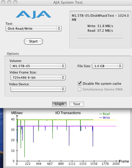

Rx4Mac Posted November 8, 2010 Share Posted November 8, 2010 Strange - I just did a test using my earlier setup... but with the 64-bit kernel The write for USB3 is much slower, while the read is in the same range. USB3 66.2MB/s write 119.7 MB/s read curious... but then again my slower than expected SATA test speeds are also curious. Any/all ideas welcome! Link to comment https://www.insanelymac.com/forum/topic/236209-lacie-usb-30-drivers-are-here-for-os-x/page/2/#findComment-1579149 Share on other sites More sharing options...
