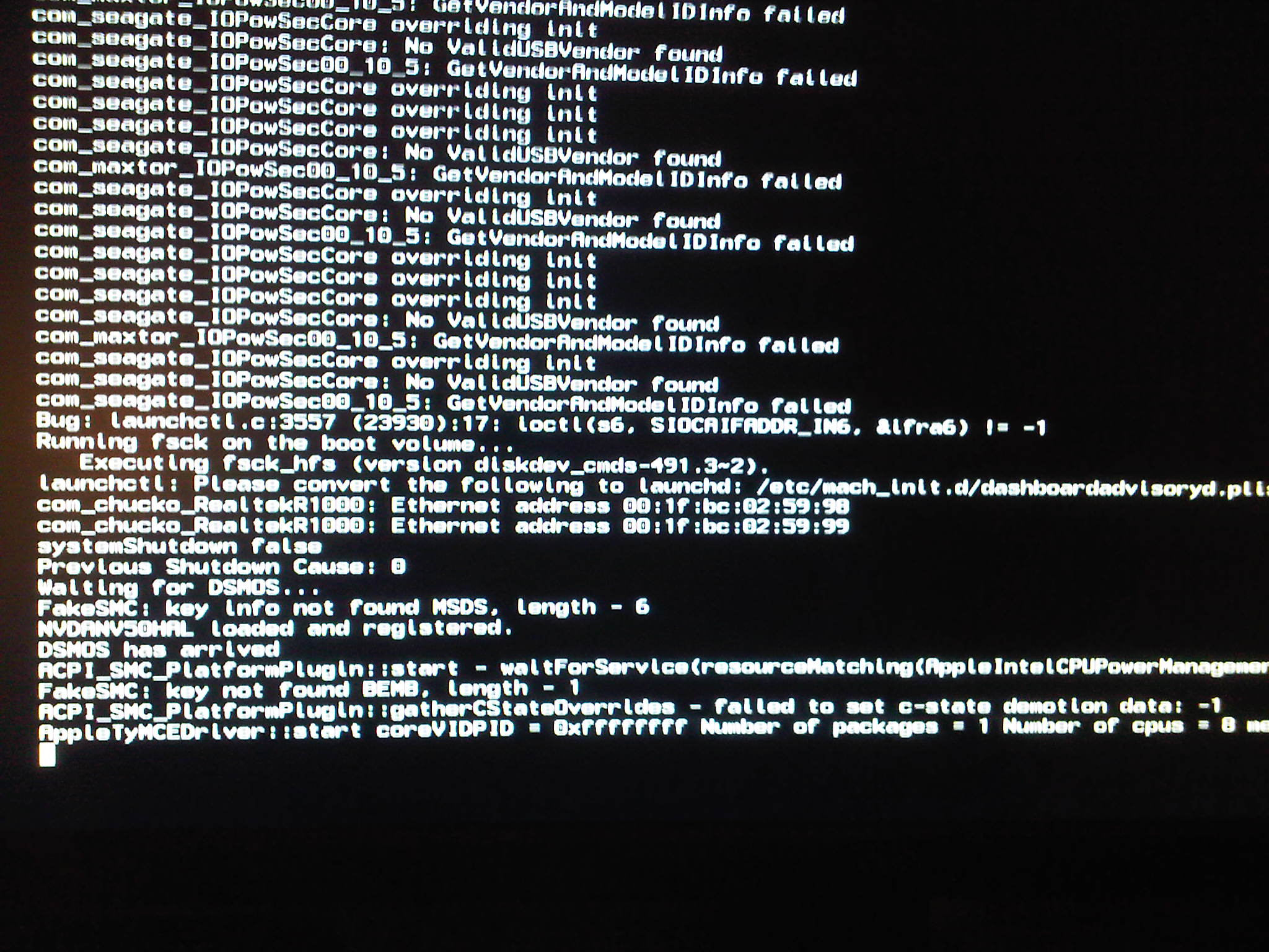

MaLd0n Posted December 12, 2010 Author Share Posted December 12, 2010 Hey Mald0n, Still getting that kernel panic -I used Chameleon RC5 -Generate P and C states = yes -Processor is Core i7 9xx yes -I used the smbios you supplied. -repaired permissions and booted -f -v Second problem: now when i try to boot from the USB stick (which has myHack 1.1) I get another error (see attached)..so I can't boot into my computer at all Any ideas?? Thanks! BackUp and remove Appletymcedriver.kext(in System/Library/Extensions) Use disabler(Nullcpu...) you saw the link I sent you problems with the bios Link to comment https://www.insanelymac.com/forum/topic/235523-dsdt-auto-patcher/page/31/#findComment-1601213 Share on other sites More sharing options...
Fbalino Posted December 12, 2010 Share Posted December 12, 2010 BackUp and remove Appletymcedriver.kext(in System/Library/Extensions) Use disabler(Nullcpu...) you saw the link I sent you problems with the bios Great! Did as you said and now it boots just fine. My internet isn't working however--do I need a kext for that? Thanks again! Link to comment https://www.insanelymac.com/forum/topic/235523-dsdt-auto-patcher/page/31/#findComment-1601238 Share on other sites More sharing options...

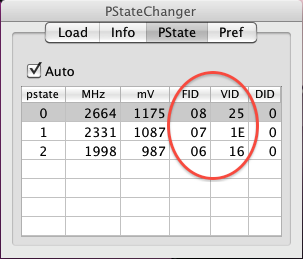

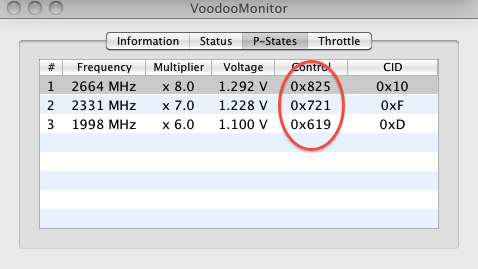

Larx Posted December 13, 2010 Share Posted December 13, 2010 MaLd0n, I need your confirmation! you send me dsdt.aml for native speedstep. Your code with FID/VID from VoodooPState.kext Processor (P001, 0x01, 0x00000810, 0x06) { Method (_PSS, 0, NotSerialized) { Return (Package (0x03) { Package (0x06) { Zero, Zero, 0x10, 0x10, 0x0825, Zero }, Package (0x06) { Zero, Zero, 0x10, 0x10, 0x071E, One }, Package (0x06) { Zero, Zero, 0x10, 0x10, 0x0616, 0x02 And I get code from VoodooMonitor and it is: Processor (P001, 0x01, 0x00000810, 0x06) { Method (_PSS, 0, NotSerialized) { Return (Package (0x03) { Package (0x06) { Zero, Zero, 0x10, 0x10, 0x0825, Zero }, Package (0x06) { Zero, Zero, 0x10, 0x10, 0x0721, One }, Package (0x06) { Zero, Zero, 0x10, 0x10, 0x0619, 0x02 } It seems that SpeedStep works much better with the FID / VID from VoodooMonitor. Is this correct? The temperature is much lower. Speedstep is working properly. I deleted VoodooPState.kext and it seems everything is normal. Can you confirm this? Is this code of VoodooMonitor wrong? I mean, can i use this code from VoodooMonitor in DSDT or ? Thanks! Link to comment https://www.insanelymac.com/forum/topic/235523-dsdt-auto-patcher/page/31/#findComment-1601819 Share on other sites More sharing options...
MaLd0n Posted December 14, 2010 Author Share Posted December 14, 2010 It seems that SpeedStep works much better with the FID / VID from VoodooMonitor.Is this correct? The temperature is much lower. Speedstep is working properly. I deleted VoodooPState.kext and it seems everything is normal. Can you confirm this? Is this code of VoodooMonitor wrong? I mean, can i use this code from VoodooMonitor in DSDT or ? Thanks! WoW I really do not know what the difference between the two I always used the VoodooPState but this method is outdated Chameleon "is the world" I currently only use the Chameleon Link to comment https://www.insanelymac.com/forum/topic/235523-dsdt-auto-patcher/page/31/#findComment-1601832 Share on other sites More sharing options...
Larx Posted December 14, 2010 Share Posted December 14, 2010 WoWI really do not know what the difference between the two I always used the VoodooPState but this method is outdated Chameleon "is the world" I currently only use the Chameleon Yea, me too. No kexts. No VoodooPState also no VoodooMonitor. Chameleon only. What I wanted to say is that the code of VoodooPstate was not good. The temperature was rising to 55 degrees, idle, while the code of VoodooMonitor which is obviously a bit differently (I do not know why) the temperature is quit normal. It seems that we managed to get the Native SpeedStep on my system. Thanks for help MaLd0n! Thanks a lot ! Link to comment https://www.insanelymac.com/forum/topic/235523-dsdt-auto-patcher/page/31/#findComment-1601848 Share on other sites More sharing options...
MaLd0n Posted December 14, 2010 Author Share Posted December 14, 2010 Yea, me too. No kexts. No VoodooPState also no VoodooMonitor. Chameleon only. What I wanted to say is that the code of VoodooPstate was not good. The temperature was rising to 55 degrees, idle, while the code of VoodooMonitor which is obviously a bit differently (I do not know why) the temperature is quit normal. It seems that we managed to get the Native SpeedStep on my system. Thanks for help MaLd0n! Thanks a lot ! the ideal would be to test the processor performance with the two Link to comment https://www.insanelymac.com/forum/topic/235523-dsdt-auto-patcher/page/31/#findComment-1601860 Share on other sites More sharing options...

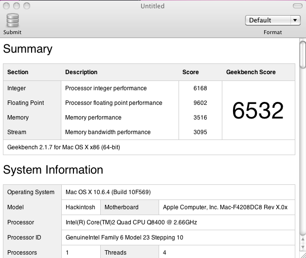

Larx Posted December 14, 2010 Share Posted December 14, 2010 the ideal would be to test the processor performance with the two Already did! There is no difference! Link to comment https://www.insanelymac.com/forum/topic/235523-dsdt-auto-patcher/page/31/#findComment-1601974 Share on other sites More sharing options...
