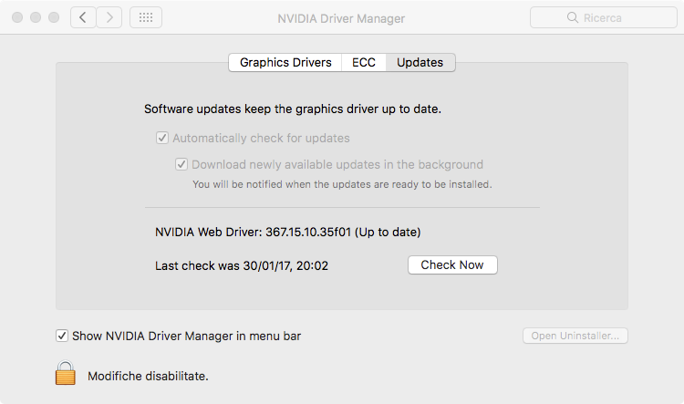

Micky1979 Posted January 30, 2017 Share Posted January 30, 2017 Ok, checked everything: Enoch (2843 Micky1979 test 2 Web Drivers) Logging started: 2017/01/30, 19:03:56 [ CPU INFO ] Sticking with [BCLK: 99Mhz, Bus-Ratio: 25] Attempting to scan GPT boot volumes [biosdev=80h]: Attempting to read GPT Read GPT Reading GPT partition 1, type C12A7328-F81F-11D2-BA4B-00A0C93EC93B Reading GPT partition 2, type 48465300-0000-11AA-AA11-00306543ECAC Attempting to scan GPT boot volumes [biosdev=81h]: Attempting to read GPT Read GPT Reading GPT partition 1, type C12A7328-F81F-11D2-BA4B-00A0C93EC93B Reading GPT partition 2, type 48465300-0000-11AA-AA11-00306543ECAC Reading GPT partition 3, type 48465300-0000-11AA-AA11-00306543ECAC Reading GPT partition 4, type 426F6F74-0000-11AA-AA11-00306543ECAC Reading GPT partition 5, type 48465300-0000-11AA-AA11-00306543ECAC Reading GPT partition 6, type 426F6F74-0000-11AA-AA11-00306543ECAC Reading GPT partition 7, type 48465300-0000-11AA-AA11-00306543ECAC Reading GPT partition 8, type 426F6F74-0000-11AA-AA11-00306543ECAC Attempting to scan GPT boot volumes [biosdev=82h]: Attempting to read GPT Read GPT Reading GPT partition 1, type C12A7328-F81F-11D2-BA4B-00A0C93EC93B Reading GPT partition 2, type 48465300-0000-11AA-AA11-00306543ECAC Boot UUID of 'Sierra' (GPT HFS+): 8C06566F-0D4A-3220-9778-58A17FFE7643 Kernel Cache file path (OS X 10.11 and newer): /System/Library/PrelinkedKernels/prelinkedkernel Loading Kernel Cache from: 'Sierra' (GPT HFS+) Booting on macOS 10.12.3 (16D32) System Integrity Protection status: disabled (Default Configuration). CsrActiveConfig = 0x67 (1100111) Configuration: Kext Signing: disabled Filesystem Protections: disabled Task for PID: disabled Debugging Restrictions: enabled Apple Internal: enabled DTrace Restrictions: disabled NVRAM Protections: disabled Decompressing Kernel Cache: - Decompressing Kernel Using lzvn [ KERNEL PATCHER START ] Will patch for 16.4.0 kernel version. KernelBooter_kexts state: enabled! KernelPm state: disabled! KernelLapicError state: enabled! KernelLapicVersion state: disabled! KernelHaswell state: disabled! KernelcpuFamily state: disabled! KernelSSE3 state: disabled! - Searching for booter extensions pattern: Found Sierra SIP pattern: patched! Found Sierra EXT (<= 10.12.4) pattern: patched! 2 substitution(s) made. NVDAStartupWeb: patched! - Looking for Lapic panic call Start Lapic Error call removed. Kernel has successfully patched. Using PCI-Root-UID value: 0 Skip Nvidia gfx device! [ INTEL GMA DEVICE INFO ] Class code: [0300] Intel HD Graphics 4000 [8086:0166] (rev 09) Subsystem: [103c:181d] :: PciRoot(0x0)/Pci(0x2,0x0) Using user supplied AAPL,ig-platform-id AAPL,ig-platform-id: 04006601 [ WIRELESS DEVICE INFO ] Class code: [0280] EnableWifi = Yes Setting up wifi keys Atheros AR9285 Wireless Network Adapter [168c:002b] PciRoot(0x0)/Pci(0x1c,0x3)/Pci(0x0,0x0) [ ETHERNET DEVICE INFO ] Class code: [0200] EthernetBuiltIn = Yes Location number: 1 Setting up lan keys Realteck RTL8111/8168 PCI-E Gigabit Ethernet [10ec:8168] PciRoot(0x0)/Pci(0x1c,0x5)/Pci(0x0,0x0) [ DRAM CONTROLLER ] SMBus CmdReg: 0x3 Scanning SMBus [8086:1e22], mmio: 0xd4615004, ioport: 0x5040, hostc: 0x1 SPD[0] (size): 146 @0x50 Slot: 0 Type 24 4096MB (DDR3 SDRAM) 1600MHz Vendor=Micron Technology PartNo=16KTF51264HZ-1G6M1M1 SerialNo= E A 7 0 D 3 2 F SPD[0] (size): 255 @0x51 SPD[0] (size): 146 @0x52 Slot: 2 Type 24 4096MB (DDR3 SDRAM) 1600MHz Vendor=Micron Technology PartNo=16KTF51264HZ-1G6M1M1 SerialNo= E A 7 0 D 3 3 1 SPD[0] (size): 255 @0x53 SPD[0] (size): 255 @0x54 SPD[0] (size): 255 @0x55 SPD[0] (size): 255 @0x56 SPD[0] (size): 255 @0x57 CPU is Intel(R) Core(TM) i5-3210M CPU @ 2.50GHz, family 0x6, model 0x3a SMBIOS orig was = fe120 SMBIOS new is = 35f7000 SMBIOS rev.: 2.4, DMI rev.: 2.4 Handle: 0x0001, DMI type 17, 27 bytes Memory Device Error Information Handle: No Error Size: 4096 MB Form Factor: SODIMM Locator: Bottom-Slot 1(top) Bank Locator: BANK 0 Memory Type: DDR3 Speed: 1600 MHz Manufacturer: Micron Technology Serial Number: ** PRIVATE ** Asset Tag: Unknown Part Number: 16KTF51264HZ-1G6M1M1 Handle: 0x0005, DMI type 17, 27 bytes Memory Device Error Information Handle: No Error Size: 4096 MB Form Factor: SODIMM Locator: Bottom-Slot 2(under) Bank Locator: BANK 2 Memory Type: DDR3 Speed: 1600 MHz Manufacturer: Micron Technology Serial Number: ** PRIVATE ** Asset Tag: Unknown Part Number: 16KTF51264HZ-1G6M1M1 Handle: 0x000C, DMI type 0, 24 bytes BIOS Information Vendor: Apple Inc. Version: MBP91.88Z.00D3.B00.1203211536 Release Date: 21/03/2012 BIOS Revision: 0.1 Handle: 0x000D, DMI type 1, 27 bytes System Information Manufacturer: Apple Inc. Product Name: MacBookPro9,2 Version: 1.0 Serial Number: ** PRIVATE ** UUID: ** PRIVATE ** Wake-up Type: Power Switch SKU Number: Default SKU# Family: MacBook Pro Handle: 0x000E, DMI type 2, 16 bytes Base Board Information Manufacturer: Apple Inc. Product Name: Mac-6F01561E16C75D06 Version: 52.24 Serial Number: ** PRIVATE ** Asset Tag: Default Asset Tag# Location In Chassis: Type2 - Board Chassis Location Type: Motherboard Handle: 0x000F, DMI type 3, 21 bytes Chassis Information Manufacturer: Apple Inc. Type: Unknown Version: Chassis Version Serial Number: ** PRIVATE ** Asset Tag: Default Asset Tag# Handle: 0x0024, DMI type 11, 5 bytes OEM Strings String 1: $HP$ String 2: LOC#ABZ String 3: ABS 70/71 78 79 7A 7B String 4: CNB1 0790100000205710000620100 String 5: HP_Mute_LED_0_0 String 6: String6 for Original Equipment Manufacturer String 7: String7 for Original Equipment Manufacturer String 8: String8 for Original Equipment Manufacturer Handle: 0x0038, DMI type 4, 38 bytes Processor Information Socket Designation: U3E1 Type: Central Processor Family: 0xCD Manufacturer: Intel(R) Corporation ID: 0xBFEBFBFF000306A9 Version: Intel(R) Core(TM) i5-3210M CPU @ 2.50GHz External Clock: 0 MHz Max Speed: 2494 MHz Current Speed: 2500 MHz Upgrade: Socket rPGA988B Serial Number: ** PRIVATE ** Asset Tag: To Be Filled By O.E.M. Part Number: To Be Filled By O.E.M. Core Count: 2 Core Enabled: 2 Thread Count: 4 Handle: 0x003C, DMI type 131, 6 bytes Apple specific Processor Type Cpu-type = 0x0604 Handle: 0x003D, DMI type 132, 6 bytes Apple specific Processor Interconnect Speed QPI = 25100 MT/s Handle 0x003e, DMI type 127, 4 bytes End of Table Adding device-properties string to DT [ ACPI PATCHER ] Table /Extra/DSDT.aml read and stored at: 35fb000 Generating P-States config: No Generating C-States config: No ACPI Table not found: SSDT.aml No ACPI version 1 found. Ignoring RSDP version 2 found @fe020. Length=36 RSDT @9affe124, Length 100 TABLE FACP, FADT found @9affb000, Length 268 FACP Restart Fix applied! Hardware Signature=0x00000000: using. DSDT: Old @9afe4000,9afe4000, New @35fb000,35fb000 FADT: Using custom DSDT! TABLE UEFI, TABLE ASF!, TABLE HPET, TABLE APIC, TABLE MCFG, TABLE SLIC, TABLE WDAT, TABLE SSDT, OEM SSDT tables was dropped TABLE BOOT, TABLE ASPT, TABLE DBGP, TABLE FPDT, TABLE SSDT, OEM SSDT tables was dropped TABLE SSDT, OEM SSDT tables was dropped TABLE SSDT, OEM SSDT tables was dropped RSDT: Original checksum 224, New checksum 34 at 3611000 XSDT @0;9affe210, Length=164 FADT found @09affb000, Length 268 FACP Restart Fix applied! Hardware Signature=0x00000000: using. DSDT: Old @9afe4000,9afe4000, New @35fb000,35fb000 FADT: Using custom DSDT! copied (OEM) copied (OEM) copied (OEM) copied (OEM) copied (OEM) copied (OEM) copied (OEM) OEM SSDT tables was dropped copied (OEM) copied (OEM) copied (OEM) copied (OEM) OEM SSDT tables was dropped OEM SSDT tables was dropped OEM SSDT tables was dropped RSDP: Original checksum 119, New checksum 161 RSDP: Original extended checksum 81, New extended checksum 72 ACPI version 2 patching finished Adding booter spec to the Platform Expert Attempting to loading drivers from "Extra" repository: Starting Darwin/x86_64 [Darwin Kernel Version 16.4.0: Thu Dec 22 22:53:21 PST 2016; root:xnu-3789.41.3~3/RELEASE_X86_64] Boot Args: -v nvda_drv=1 logout 10.12.3 loaded succesfully with Web drivers loaded, please test this: boot test 2 Web Drivers.zip .. cut out of bdmesg: - Searching for booter extensions pattern: Found Sierra SIP pattern: patched! 1 substitution(s) made. Unable to patch NVDAStartupWeb.. uploaded unpatched NVDAStartupWeb if you want to look in. Same OS you have, and same drivers: in kernel log say: (NVDAStartupWeb) NVDAStartupWeb: Web now the log should be like mine: [ KERNEL PATCHER START ] Will patch for 16.4.0 kernel version. KernelBooter_kexts state: enabled! KernelPm state: disabled! KernelLapicError state: enabled! KernelLapicVersion state: disabled! KernelHaswell state: disabled! KernelcpuFamily state: disabled! KernelSSE3 state: disabled! - Searching for booter extensions pattern: Found Sierra SIP pattern: patched! Found Sierra EXT (<= 10.12.4) pattern: patched! 2 substitution(s) made. NVDAStartupWeb: patched! - Looking for Lapic panic call Start Lapic Error call removed. Kernel has successfully patched. 1 Link to comment https://www.insanelymac.com/forum/topic/231075-chameleon-24svn-official-pkg-installer/page/157/#findComment-2359859 Share on other sites More sharing options...

mitch_de Posted January 30, 2017 Share Posted January 30, 2017 Now worked!! (not updated prelinked kernel was the prob) - Searching for booter extensions pattern: Found Sierra SIP pattern: patched! Found Sierra EXT (<= 10.12.4) pattern: patched! 2 substitution(s) made. NVDAStartupWeb: patched! Prelinked kernel https://drive.google.com/file/d/0B3C_nItXkCRXak5QZm14YVR5cW8 1 Link to comment https://www.insanelymac.com/forum/topic/231075-chameleon-24svn-official-pkg-installer/page/157/#findComment-2359928 Share on other sites More sharing options...
