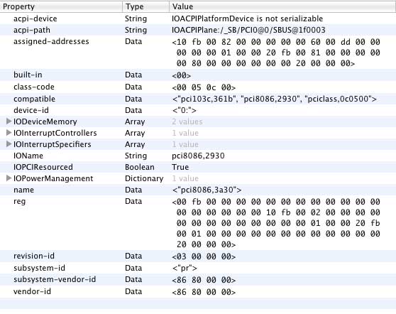

kizwan Posted September 21, 2010 Share Posted September 21, 2010 IORegisteryExplorer shows that device is loaded. But when I type kextstat I don't see com.apple.driver.AppleSMBusPCI is loaded. Can anyone please confirm that com.apple.driver.AppleSMBusPCI should be loaded to be able to say that SBUS device is patched? What is this I am doing wrong? I can confirm AppleSMBusPCI.kext does loaded on my two notebooks (please refer to my signature). I didn't apply SBUS patch since both have vanilla device ID which is 3b30. On my (retired) Acer Aspire 9420, AppleSMBusPCI.kext also loaded. Link to comment https://www.insanelymac.com/forum/topic/223205-dsdt-editor-and-patcher/page/13/#findComment-1551927 Share on other sites More sharing options...

JBraddock Posted September 21, 2010 Share Posted September 21, 2010 If you still interested to achieve vanilla setup for SBUS (AppleSMBusPCI.kext), please try change the SBUS patch a little bit where just inject the device-id:- Device (SBUS) { Name (_ADR, 0x001F0003) Method (_DSM, 4, NotSerialized) { Store (Package (0x02) { "device-id", Buffer (0x04) { 0x30, 0x3A, 0x00, 0x00 } }, Local0) DTGP (Arg0, Arg1, Arg2, Arg3, RefOf (Local0)) Return (Local0) } See whether AppleSMBusPCI.kext loaded this time or not. Yes, this code works. I don't know how important it is but looking at IORegistryExplorer, when using the new code I shared, there were some extra things showing up for Device (DVL0) and Device (BUS0). Anyway, it loads this way too. Thanks a lot. @Kizwan, any chance you took a look at HDEF code I shared for a while ago? No sound after sleep issue I told you about. Link to comment https://www.insanelymac.com/forum/topic/223205-dsdt-editor-and-patcher/page/13/#findComment-1551964 Share on other sites More sharing options...
kizwan Posted September 21, 2010 Share Posted September 21, 2010 Yes, this code works. Good to hear it works. I figured maybe susbsytem-id and/or subsystem-vendor-id in earlier patch prevent the device-id injection. You just need to inject device-id 3a30 for AppleSMBusPCI.kext to load. I don't know how important it is but looking at IORegistryExplorer, when using the new code I shared, there were some extra things showing up for Device (DVL0) and Device (BUS0). Anyway, it loads this way too. Thanks a lot. SBUS is important for C-State & sleep to work properly. You see those devices (DVL0 & BUS0) because you add this in your DSDT earlier:- Device (SBUS) { Name (_ADR, 0x001F0003) Device (BUS0) { Name (_CID, "smbus") Name (_ADR, Zero) Device (DVL0) { Name (_ADR, 0x57) Name (_CID, "diagsvault") } } } Try remove it & see whether AppleSMBusPCI.kext still loaded or not. You did removed your device id from AppleSMBusPCI.kext when testing the new patch right? @Kizwan, any chance you took a look at HDEF code I shared for a while ago? No sound after sleep issue I told you about. Yes. I already take a look your DSDT & legacy kext. I found your legacy kext a bit different compared to mine (left is yours, right is mine):- However, I don't think it is the cause of your problem. I believe your problem lies in DSDT, most probably it have to do with _PTS & _WAK control method. I'm not sure what is the best way to fix it but I'll try to look into it again. Link to comment https://www.insanelymac.com/forum/topic/223205-dsdt-editor-and-patcher/page/13/#findComment-1552000 Share on other sites More sharing options...
JBraddock Posted September 21, 2010 Share Posted September 21, 2010 Good to hear it works. I figured maybe susbsytem-id and/or subsystem-vendor-id in earlier patch prevent the device-id injection. You just need to inject device-id 3a30 for AppleSMBusPCI.kext to load. SBUS is important for C-State & sleep to work properly. You see those devices (DVL0 & BUS0) because you add this in your DSDT earlier:- Device (SBUS) { Name (_ADR, 0x001F0003) Device (BUS0) { Name (_CID, "smbus") Name (_ADR, Zero) Device (DVL0) { Name (_ADR, 0x57) Name (_CID, "diagsvault") } } } Try remove it & see whether AppleSMBusPCI.kext still loaded or not. You did removed your device id from AppleSMBusPCI.kext when testing the new patch right? Something weird is happening right now. I am pretty sure that when I applied the hack you provided alongside vanilla AppleSMBusPCI.kext, the kext got loaded. I checked again and it was gone. I applied the hack I found and it got loaded again. I know that those device names appear in IORegistryExplorer because I added them to my DSDT but please take a look at the following screenshots. OSX clearly adds some values to those devices. I can't speak with a scientific mind but if those devices were unnecessary would OSX still assign some values to them? Notice the PowerManagement section. Now there is a ChildrenPowerState. May be we could enhance this hack to patch the device id on the fly. The worst case scenario is that I can create a legacy kext. Yes. I already take a look your DSDT & legacy kext. I found your legacy kext a bit different compared to mine (left is yours, right is mine):-However, I don't think it is the cause of your problem. I believe your problem lies in DSDT, most probably it have to do with _PTS & _WAK control method. I'm not sure what is the best way to fix it but I'll try to look into it again. I can't really remember how many DSDT files I downloaded from this forum with hope to fix this problem. Some HDEF codes include something like the following. OperationRegion (HDAR, PCI_Config, 0x4C, 0x10) Field (HDAR, WordAcc, NoLock, Preserve) { DCKA, 1, Offset (0x01), DCKM, 1, , 6, DCKS, 1, Offset (0x08), , 15, PMES, 1 } Some don't. Anyway, I am pretty sure that we'll find a solution. Thanks for your time. Link to comment https://www.insanelymac.com/forum/topic/223205-dsdt-editor-and-patcher/page/13/#findComment-1552040 Share on other sites More sharing options...
kizwan Posted September 21, 2010 Share Posted September 21, 2010 Something weird is happening right now. I am pretty sure that when I applied the hack you provided alongside vanilla AppleSMBusPCI.kext, the kext got loaded. I checked again and it was gone. I applied the hack I found and it got loaded again. Maybe it was unloaded because it is not in use. Try this; apply these patch with vanilla AppleSMBusPCI.kext. Of course removed your device id from it. SBUS patch (source):- Method (_DSM, 4, NotSerialized) { Store (Package (0x04) { "name", Buffer (0x0C) { "pci8086,3a30" }, "device-id", Buffer (0x04) { 0x30, 0x3a, 0x00, 0x00 } }, Local0) DTGP (Arg0, Arg1, Arg2, Arg3, RefOf (Local0)) Return (Local0) } BUS0 patch:- Device (SBUS) { Name (_ADR, 0x001F0003) Device (BUS0) { Name (_CID, "smbus") Name (_ADR, Zero) Device (DVL0) { Name (_ADR, 0x57) Name (_CID, "diagsvault") } } } I hope AppleSMBusPCI.kext get loaded this time. I know that those device names appear in IORegistryExplorer because I added them to my DSDT but please take a look at the following screenshots. OSX clearly adds some values to those devices. I can't speak with a scientific mind but if those devices were unnecessary would OSX still assign some values to them? I'm not sure, maybe Mac OS X automatically assign those values because it detect it's present in DSDT. If you check in windows Device Manager, there is no children device under SMBUS controller. So, BUS0 is only an imaginary devices. But as long as AppleSMBusPCI.kext loaded because of it, just keep it in your DSDT. I'm going to apply BUS0 patch in my DSDT too. In MacBookPro6,1 ioreg (to be specific), there is a device called "Mikey" connected to BUS0 under SBUS device. I can't really remember how many DSDT files I downloaded from this forum with hope to fix this problem. Some HDEF codes include something like the following. OperationRegion (HDAR, PCI_Config, 0x4C, 0x10) Field (HDAR, WordAcc, NoLock, Preserve) { DCKA, 1, Offset (0x01), DCKM, 1, , 6, DCKS, 1, Offset (0x08), , 15, PMES, 1 } Some don't. Anyway, I am pretty sure that we'll find a solution. Thanks for your time. I don't think this codes necessary. HDEF patch is simple, just add _DSM control method. Link to comment https://www.insanelymac.com/forum/topic/223205-dsdt-editor-and-patcher/page/13/#findComment-1552080 Share on other sites More sharing options...
