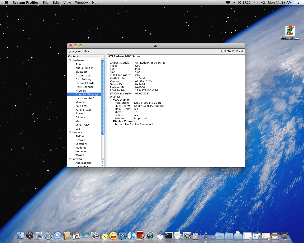

I used the 10.6.2 kexts from irc.osx86.hu #RadeonHD and the test boot 5 from JaS, for my ATI Radeon HD 4650 1 Gb PCIe (RV730) an it's working on DVI2VGA, also I have QE/CI. thanks to JaS for the help.

I have a Sapphire Radeon HD 4650 1GB and I've only been able to get it to work with a DVI2VGA adapter.
(Vendor: ATI (0x1002), Device ID: 0x9498, Revision ID: 0x0000)
My card has 1x DVI (came with DVI to HDMI adapter), 1x S-Video out, and 1x VGA
Link to my video card
