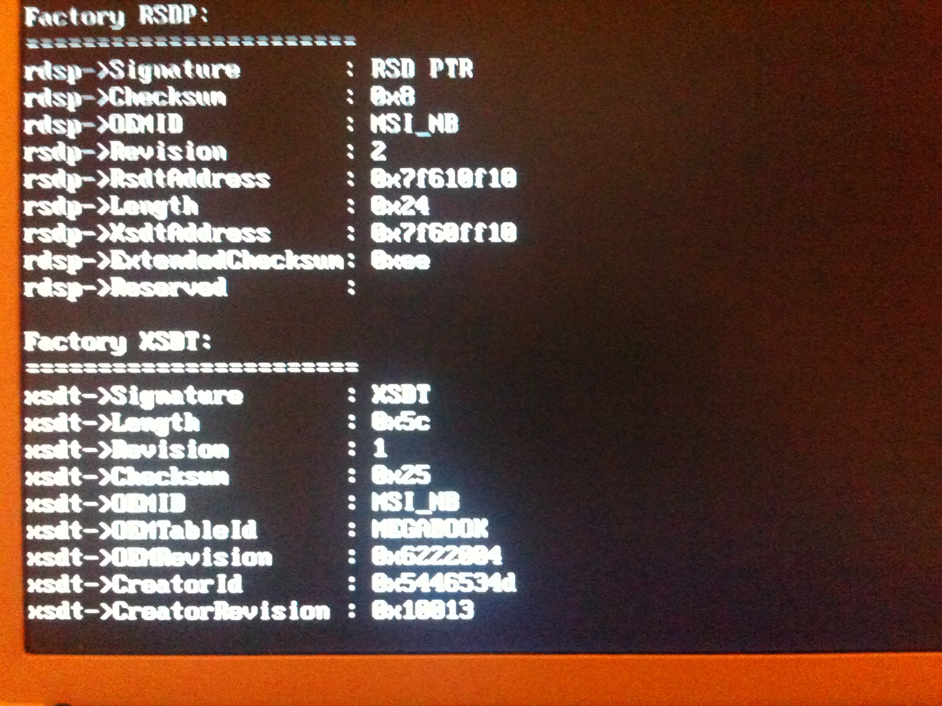

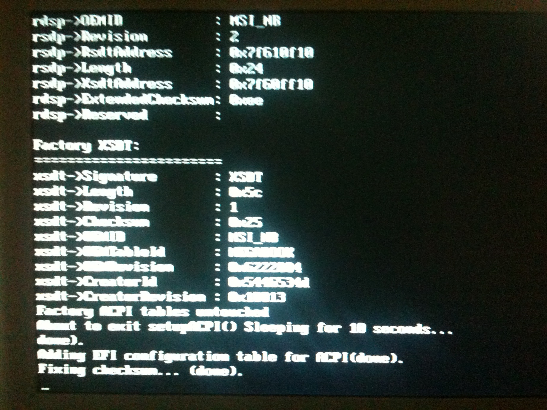

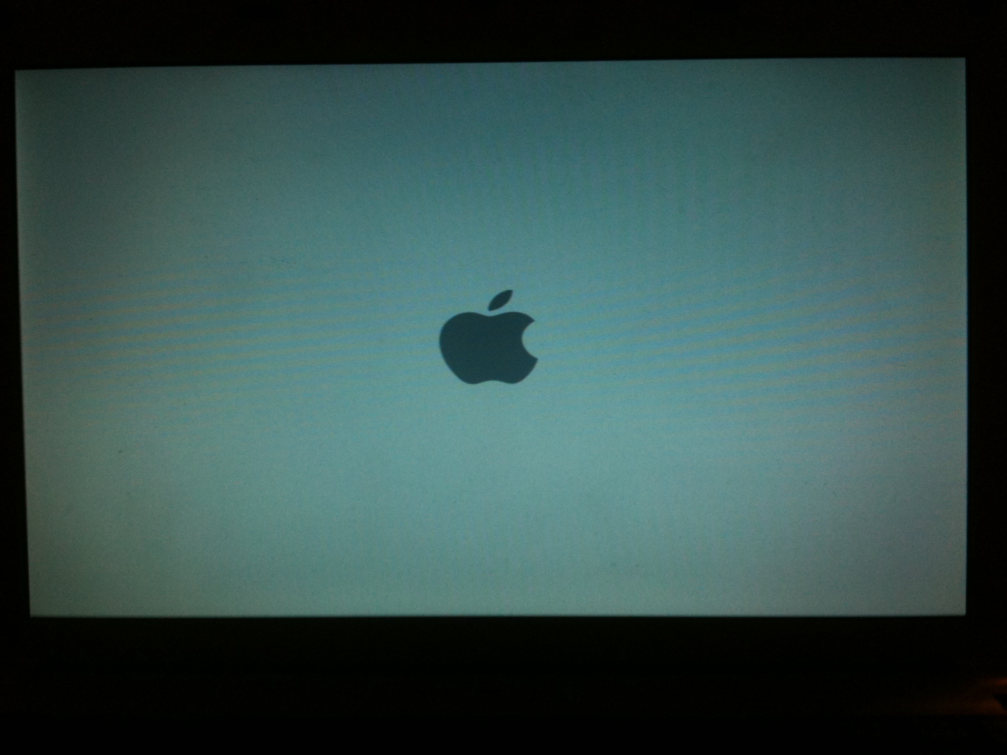

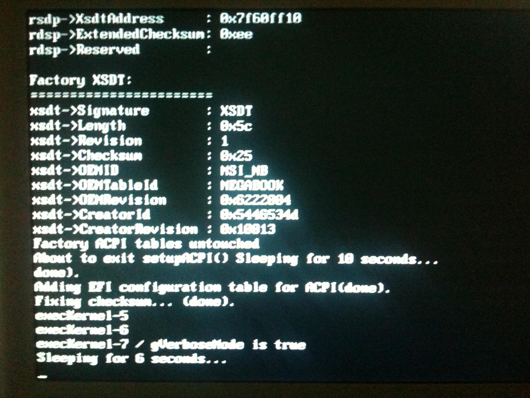

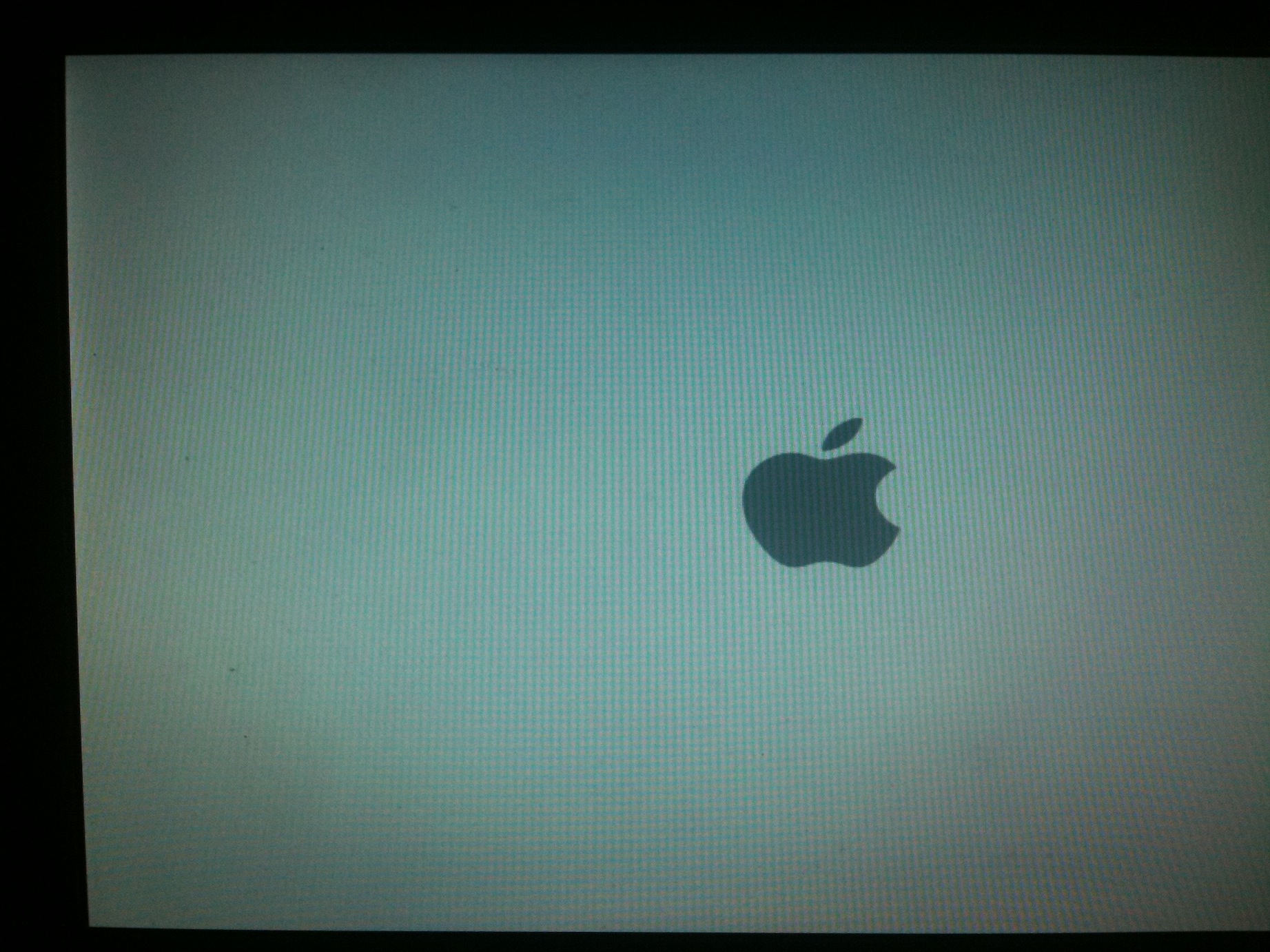

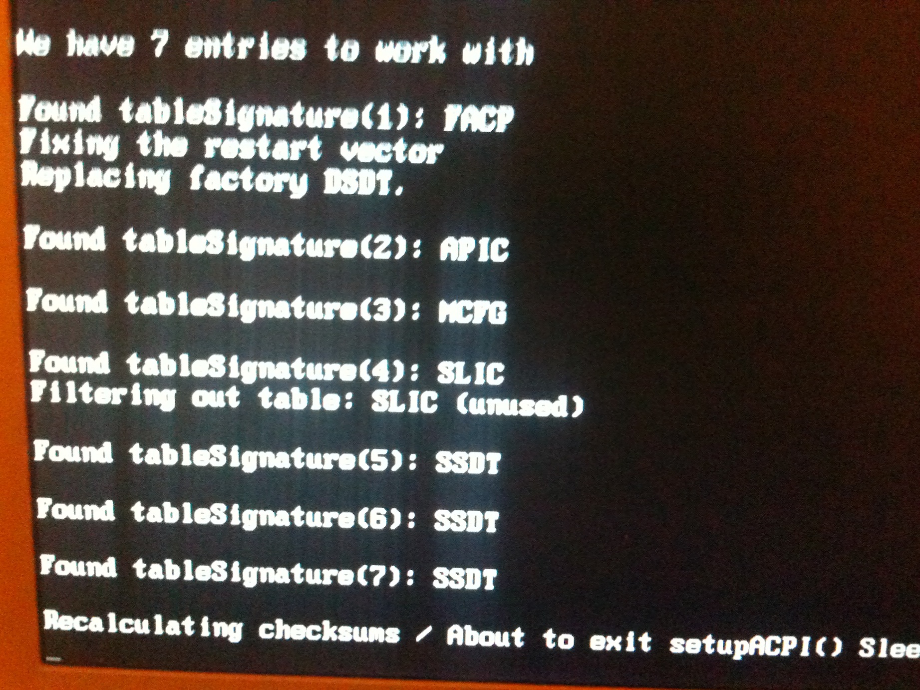

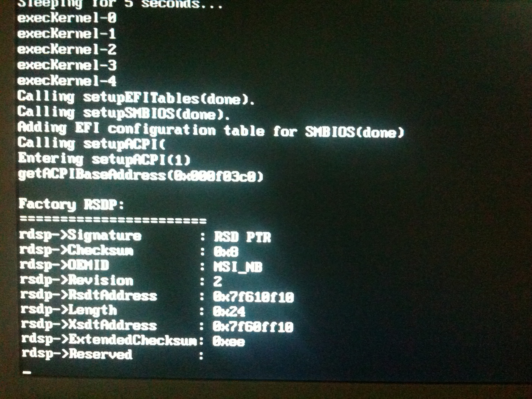

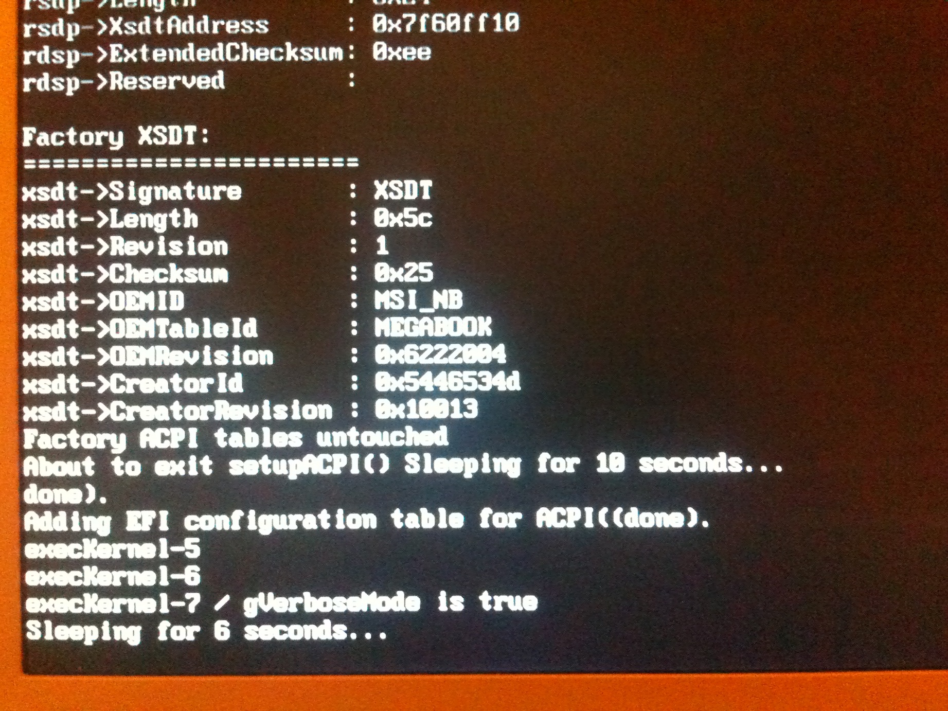

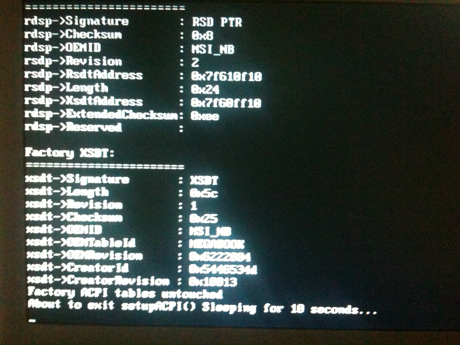

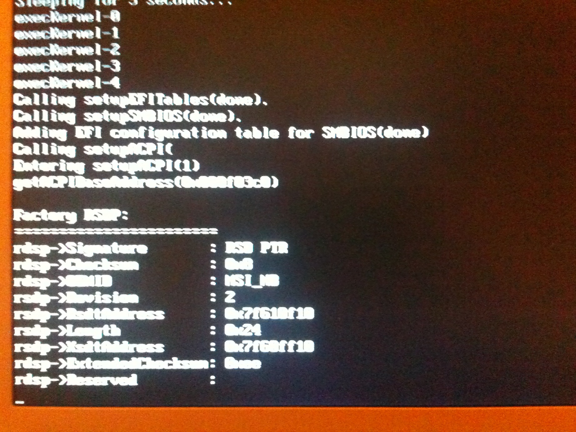

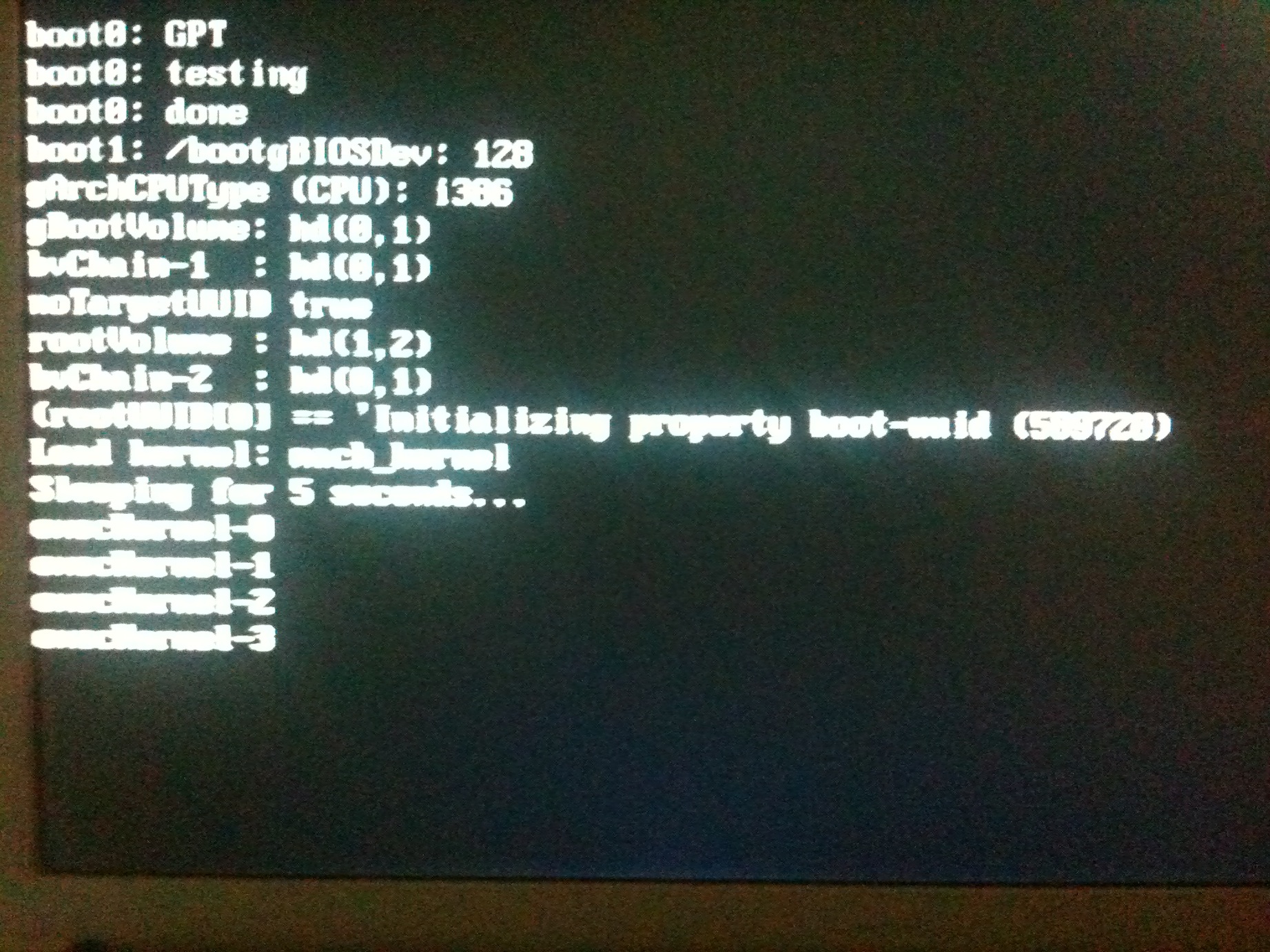

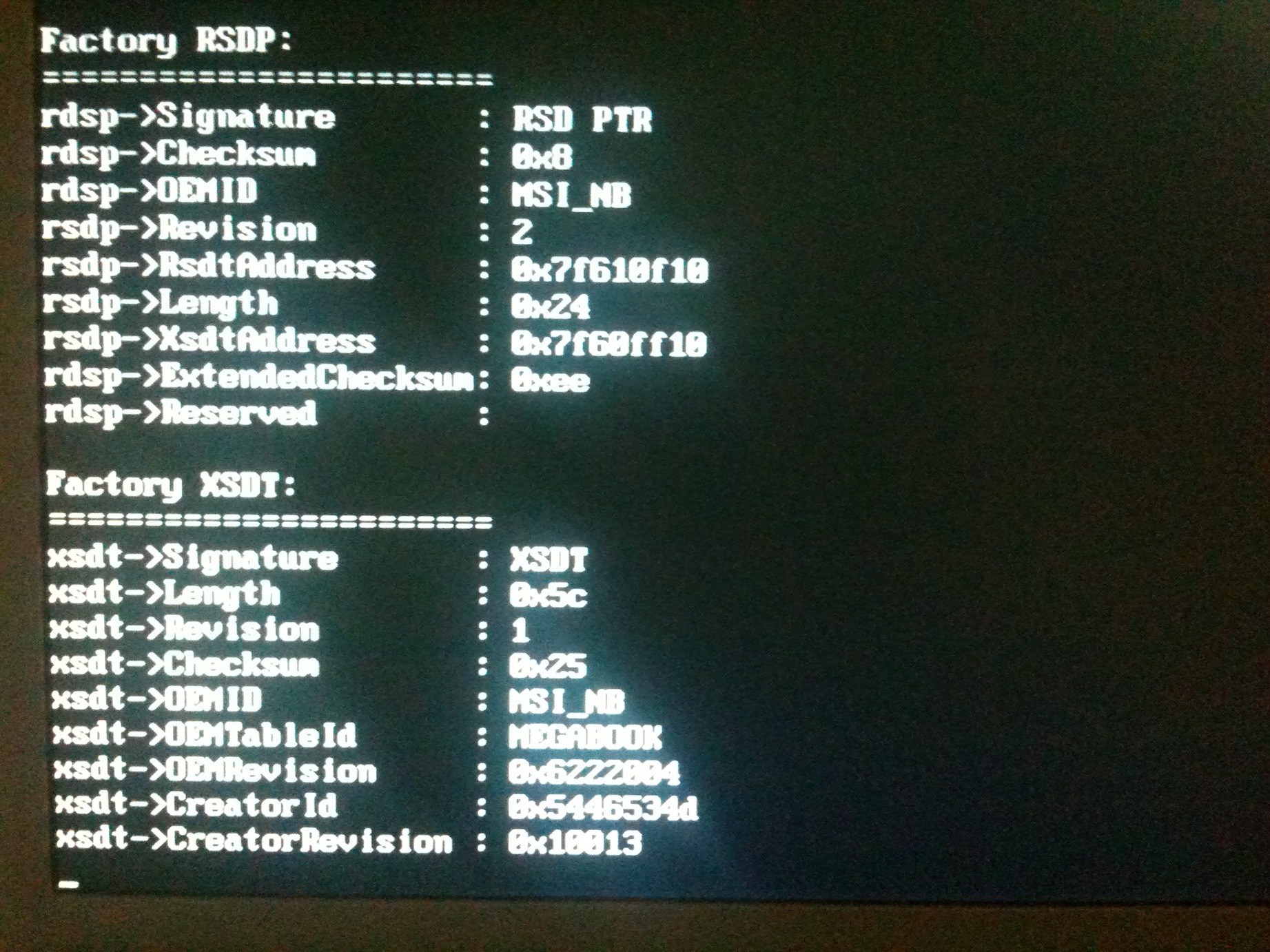

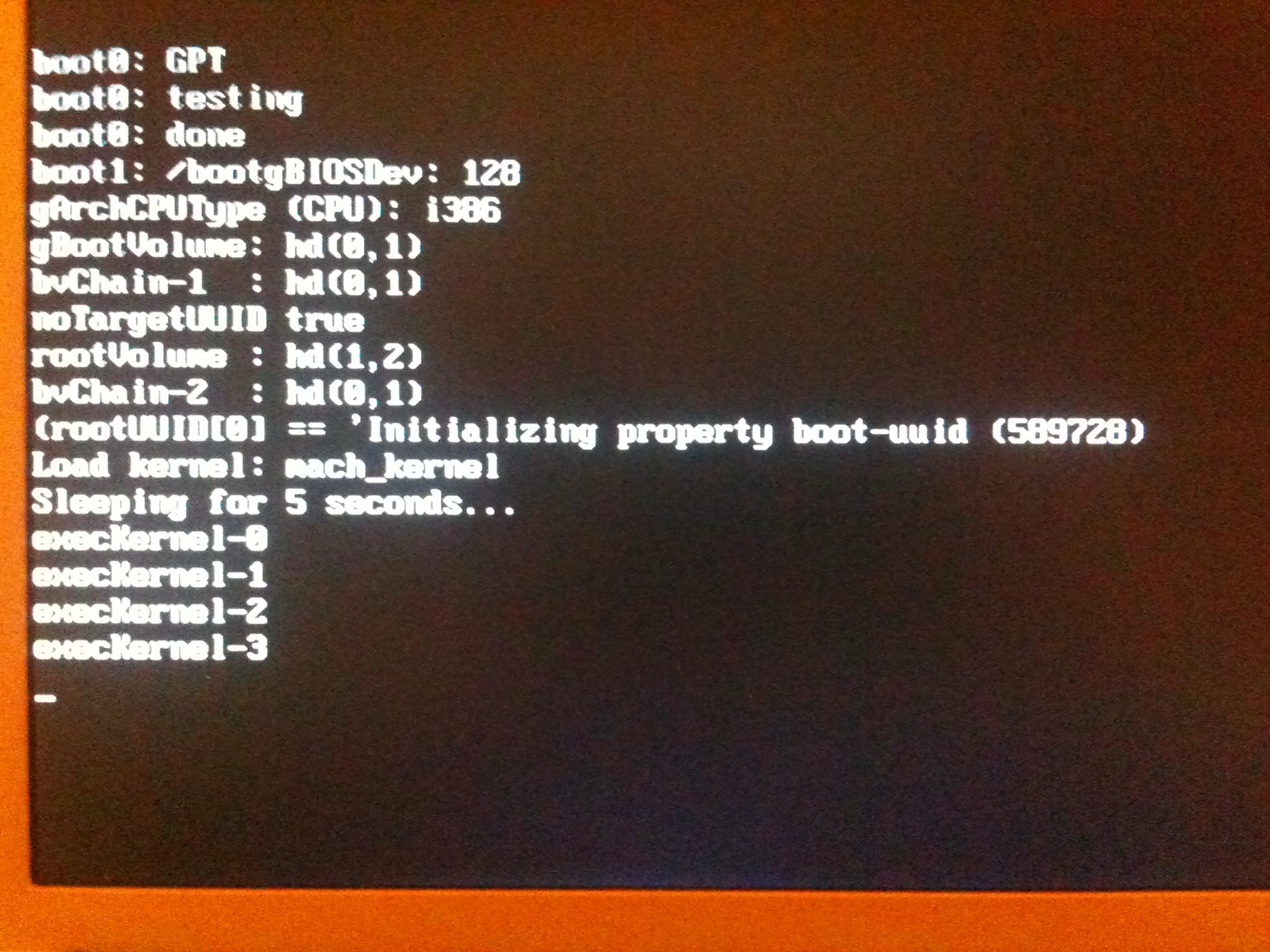

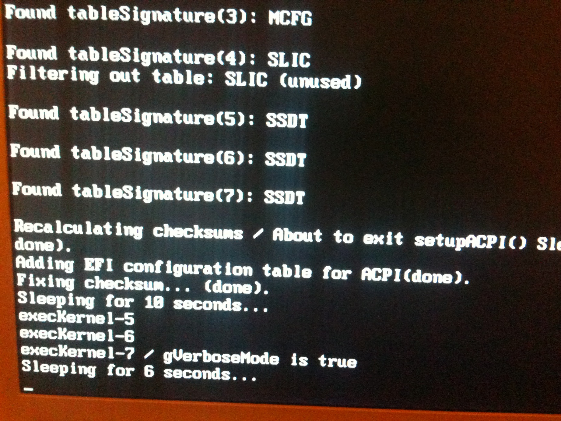

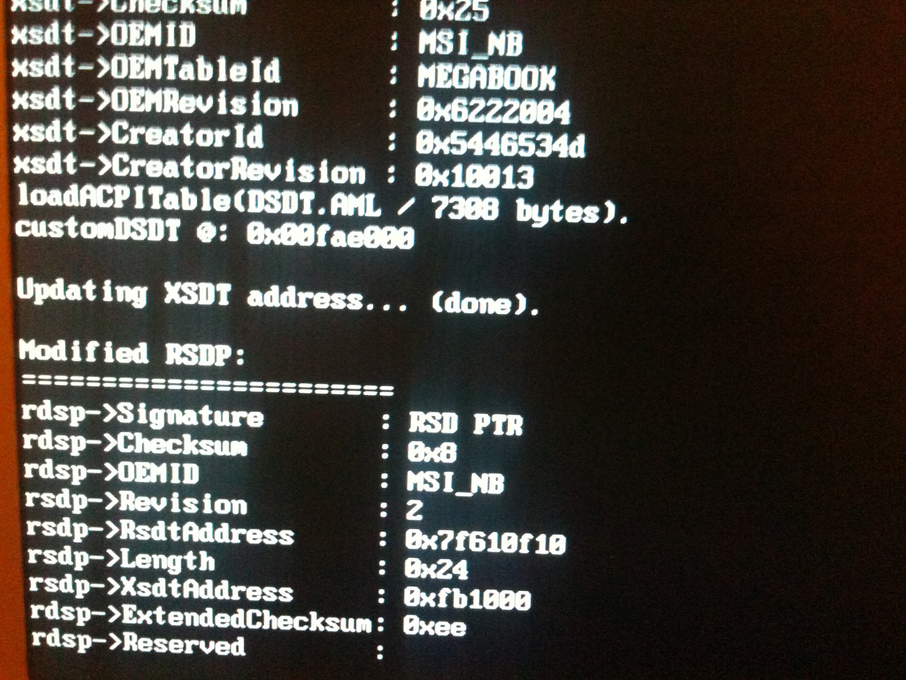

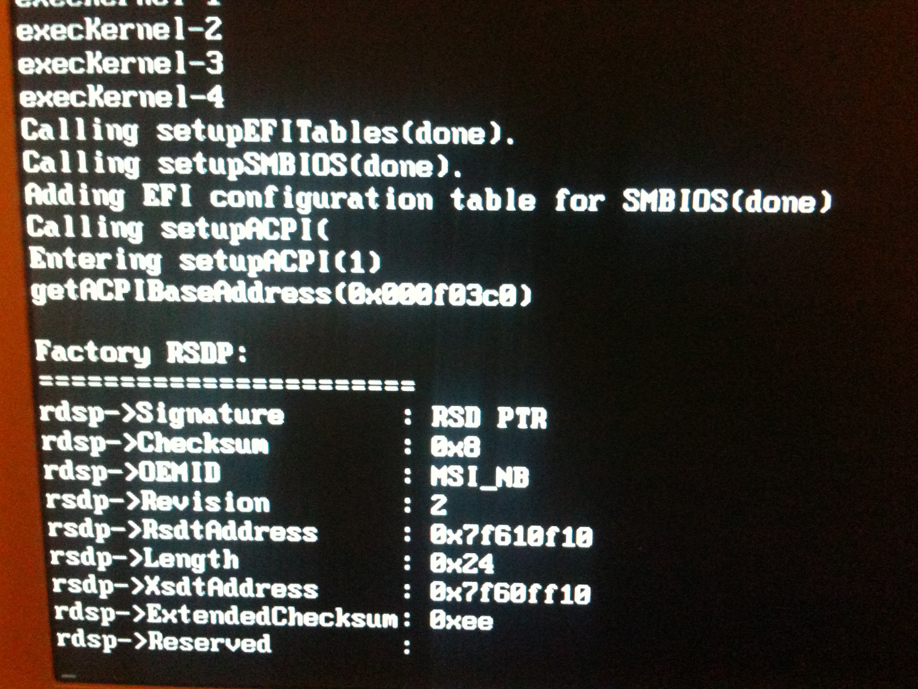

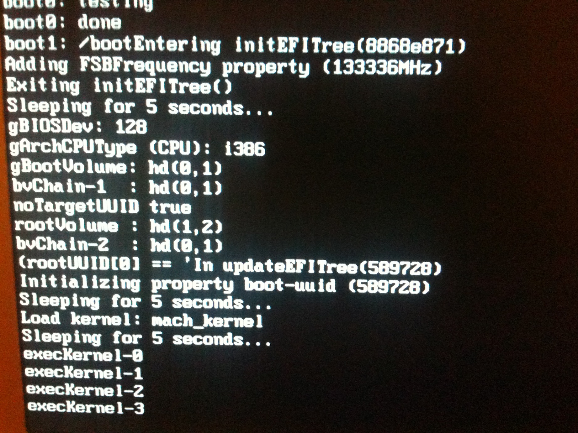

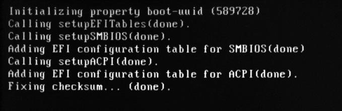

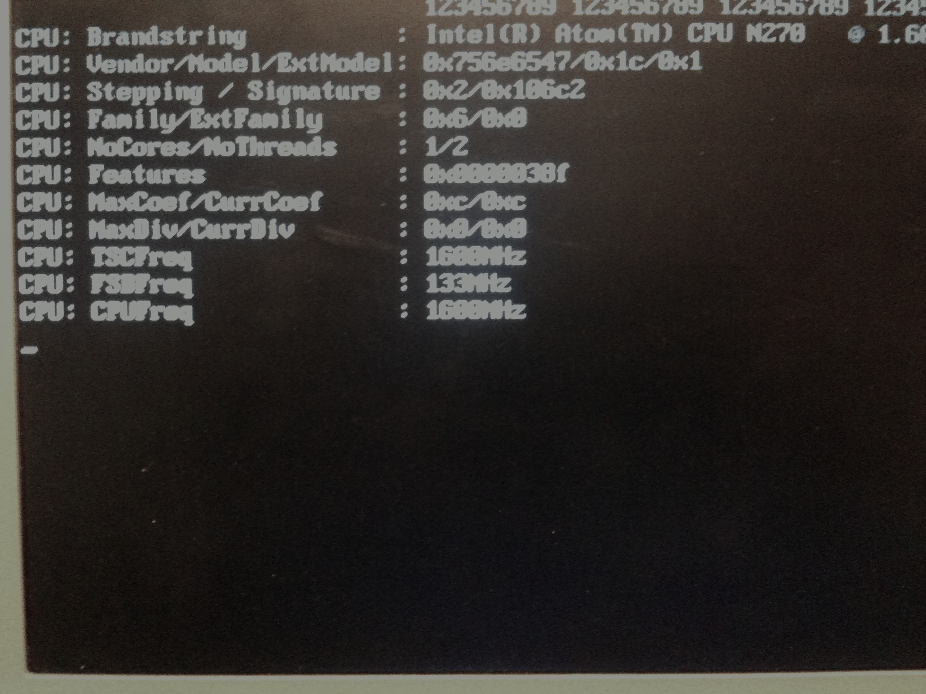

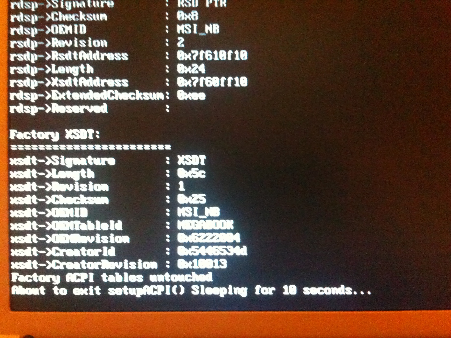

Unfortunately still no boot for me as yet. The debug seems to confirm my Factory ACPI table was untouched - does this mean my dsdt did not load?
post-170015-1294589328_thumb.jpgpost-170015-1294589538_thumb.jpgpost-170015-1294589571_thumb.jpgpost-170015-1294589593_thumb.jpg
post-170015-1294589620_thumb.jpgpost-170015-1294589645_thumb.jpgpost-170015-1294589669_thumb.jpg
Looks like the EFI stuff working but until a boot or someone else checks it with a 32bit processor we cannot be certain.

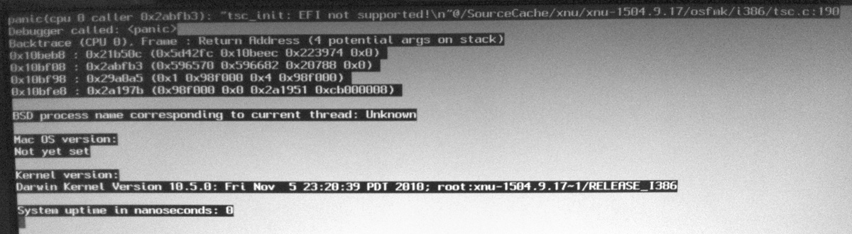

Using the last EFI patch in 32bit mode gives me a kp about EFI not supported.

Correct. The ACPI tables are untouched. Please check your "switches" once more.

I fail to boot with the following 'EFI not supported' KP (same as Scrax? - EDIT: - Yes, scrax confirmed below):

I've taken the latest files in Revolution_634_EFI_step_5.zip from post #382, applied the diff_634_EFI_5_7.txt from post #389 and made the amendments from post #391.

I fail to boot with the following 'EFI not supported' KP (same as Scrax?):
Yes it's the same KP i get

But for reference, setting the EFI_64_BIT directive doesn't make any difference - I get the same KP with it set to either 0 or 1.

Made all the changes in the diff, debug pics:
post-170015-1294616550_thumb.jpgpost-170015-1294616576_thumb.jpgpost-170015-1294616603_thumb.jpgpost-170015-1294616626_thumb.jpgpost-170015-1294616651_thumb.jpgpost-170015-1294616688_thumb.jpg
Still no go for me. Keep up the good work and don't feel pressured to deliver. Schooling and home life come first. Might catch up for half hour in morning cause I know you'll be up at the call "rise and shine" otherwise will be tomorrow evening for me to catch up. Last glass of red sunk, and off to bed.
Could not resist one more test - all debugs off and -v taken out of a.c.B.p WOW, quicker than the bios from signs of Revo boot to grey screen and apple (unfortunately as yet no further). This thing is going to be amazing when it's cracked.

Sorry for the wait, i checked, double checked, and treble checked everything and unfortunately have report still no boot with 32bit cpu :( . I really appreciate all the hard work you been doing to try and get me up and running. Debug don't look much different to me except it's obvious dsdt is loading which I was not absolutely sure it was previous for me.
post-170015-1294862918_thumb.jpgpost-170015-1294862937_thumb.jpgpost-170015-1294862967_thumb.jpgpost-170015-1294862988_thumb.jpgpost-170015-1294863006_thumb.jpgpost-170015-1294863025_thumb.jpg
I also tried setting EFI to 64 bit just to what happened: EFI_64_BIT setting (1) error detected!
CPU Debug:post-170015-1294870360_thumb.jpg
That's too bad, but I was kind of expecting it. A voice told me that EFI isn't the problem here. Gonna have a chat with it in a little time – unrelated to this matter, but that is why I am awake (have had a few hours of sleep already).
No problem. At least now we know that your DSDT is loading.
LOL So my check really works. Great. Anyway. Using 64-bit addresses should not work on a 32-bit configuration. We're missing something else. I mean looking at some old posts here: scrax used Revolution 6.20 with OS X 10.6.3 so why can't he boot anymore? Is that due to my changes in boot2/drivers.c or you guys not having the MKext(s) in the right spot, or maybe SMBIOS issues?
