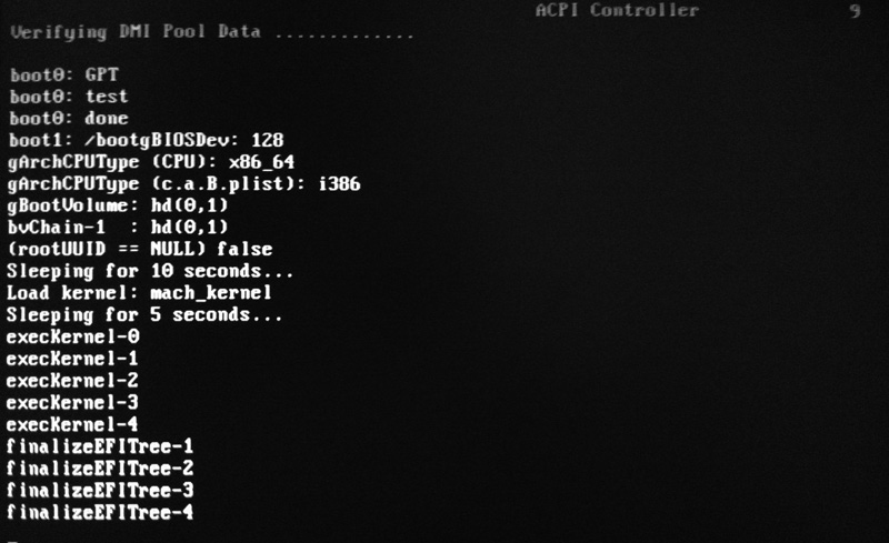

Latest boot progress report:
(rootUUID == NULL) false
Here's a picture of the debug output.

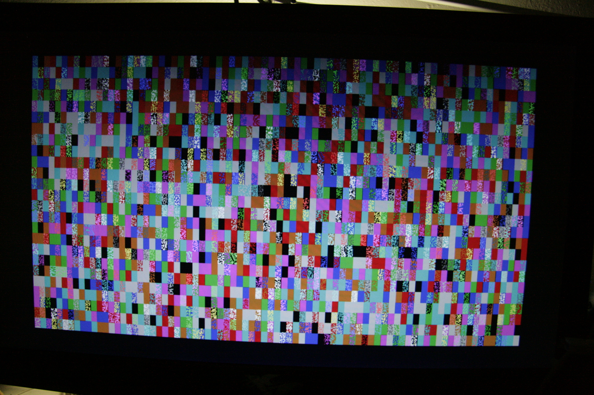

It does flick to finalizeEFITree-5 briefly before I get to see the multicoloured blocks.
Not NULL because you have set it in c.a.B.plist We'll get it going, eventually.

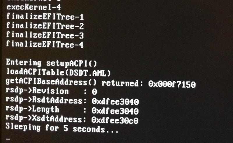

Okay - I have this is patcher.h
	// ACPI 1.0 compliance requires some changes, or it won't even boot.
if (rsdp->Revision == 0)
	rsdp->Length = 20;
	addressWidth = 4;
	acpiTableAlias = "ACPI_10";
	acpiTableEFIGUID = acpi10TableEFIGUID;
But I get the same result as before making the change?
rsdp->Revision   :0
rsdp->RsdtAddress: 0xdfee3040
rsdp->Length	 : 0xdfee3040
rsdp->XsdtAddress: 0xdfee30c0

BTW: I don't see messages about actual patching, which means that it skips this if clause:
if (xsdt && (uint64_t)rsdp->XsdtAddress < 0xffffffff && xsdt->Length < 0x10000)
What you can do is to add:
	printf("xsdt->Length: %d\n", xsdt->Length);
sleep(5);
above this line, but I think that we need to make more changes. Unfortenately I have ran out of time and thus see you next time.

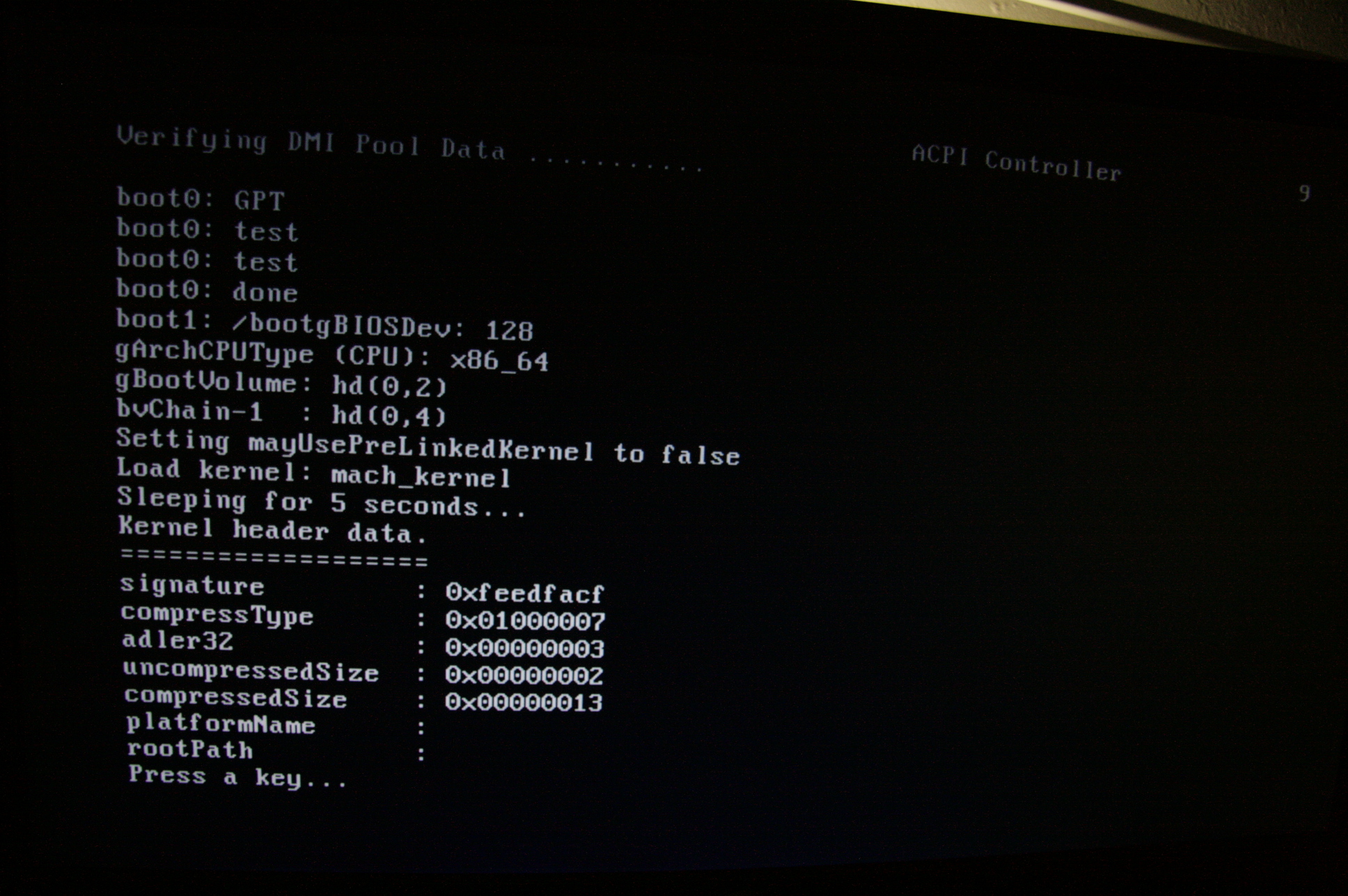

My DEBUG
boot0: GPT
boot0: testing
boot0: done
boot1: /bootBIOSDev :128
gArchCPUType (CPU):i386
gBootVolume:hd (0,1)
byChain -1:hd (0,1)
rootVolume:hd (1,2)
byChain:hd (0,1)
Setting mayUsePreLinkedKernel to false
Load Kernel:mach_kernel
Sleeping for 5 seconds
execkernel-0
execkernel-1
Kernel header data,
Signature:0xfeedface
CompressType:0x00000007
adler32:0x00000003
uncompressed size: 0x00000002
compressed size:0x00000012
platformName:
rootpath: ♀
Press a key

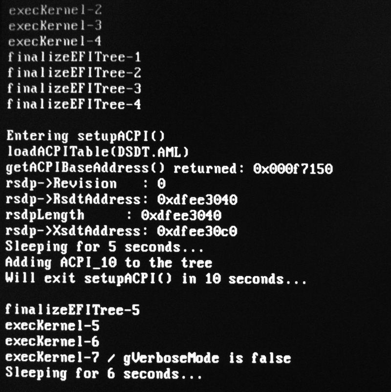

We have to replace the new line with rsdpLength = 20; and replace rsdp->Length in two other place (use search) with the new variable which we'll define as int rsdpLength = rsdp->Length; and put right below int addressWidth = 8;. Now we have something we can adjust.
p.s. rsdpLength = 36 here. You may need that instead because I do not know where the old value (20) is coming from.
I looked in to the rdsp length and for ACPI v1.0 it should equal 20, and for ACPI v2.0 it should equal 36. Source

I have this dump:
and then a: can't find smbios sobstitute message just before that coloured screen:
in the dsdt I have also the code for the graphic card.
