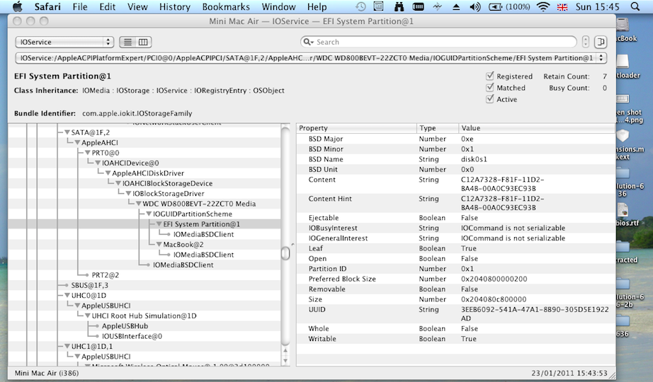

Hi DB1,
I have a spare SD card for testing, now that I bought a new/bigger/faster one. I used Disk Utility to create a GUID Partiition Table on it, but there is no EFI partition on it. Should I create it myself?
I have since added a debug dump to disk.c and it locates and reads the EFI partition (on another volume) so it looks promising. One note. I changed it to:
Not sure about formatting an SDcard to mirror a hdd with EFI partition but I guess you would just format in the same way you would a hdd (Guid). I don't have a spare SD to try it though.
Looks like good progress if your finding on another volume so it probably will work. Unfortunately I have to go out so cannot try this till later today. Have pm'd some info.
And using cpu/static_data.h now also work for you?
Hi DB1,

You need to add the #define DEBUG 1 directive yourself (somewhere at the top of the file).
Ok did this and got no boot, then changed this from 0 to 1: #define EFI_BOOT_SUPPORT 0 // Only supported by Chameleon, not by Revolution!
And were up and running. Great stuff DHP.
Thanks. This is so sweet. I cannot believe that it was this simple. Waiting for the catch to hit me. BONG. LOL
