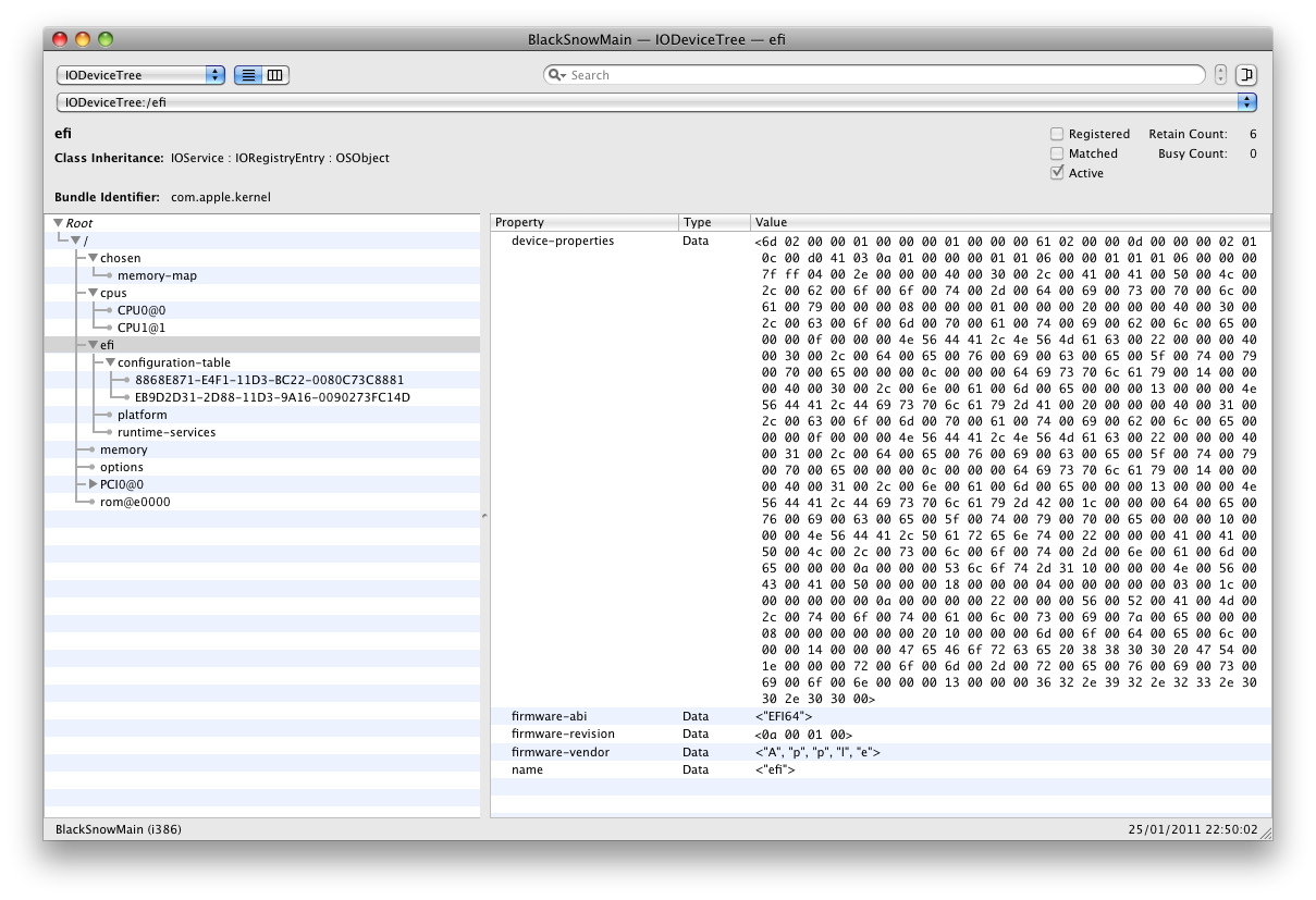

I see in my iMac's ioreg a huge data block in efi->device-properties, so is that what we'll be adding here?
In that case, where on my hack do I get the data to add in to 'PUT_YOUR_EFI_DEVICE_PROPERTIES_HERE' ?
I also notice I have some data in efi->device-properties in my ioreg when from booting with Chameleon. Though I don't know what it is? But I'm sure you can tell me.

Yup. That's the one we want to use/fill. Thinking of writing a simple extraction tool for this – ala smbios2struct – but I only just returned back home so nothing is done yet i.e. you'll have to do the labor yourself (for now).
p.s. I haven't even used this myself (totally untested) so we might need to change/move things around, but I thought to let you gentlemen figure this out during todays practice games.
Just sussed, the data in efi->device-properties when booting from Chameleon is for my video. It's added when enabling Graphics Enabler. Therefore if I add the same data in private.h for Revolution then I can remove the video data from my DSDT.aml? and also use if for any other instance where I would add device strings?.. I'll try it now.
Done and it works :D
Video removed from DSDT.aml and device properties injected perfectly.

For users with an already working system using standard Chameleon they can extract their efi device properties from ioreg using this:
ioreg -p "IODeviceTree" -lw0 | grep "device-properties" | awk '{print $5}' | sed -n '1p' > ioreg_efi_device_props.txt

It compiles fine and masterfully creates the struct however it stops short on my iMac?
The device properties in ioreg on my iMac are much larger than the extracted struct.
Data size:
0x2193a in ioreg
0x0c9c in the struct.
I'll run it on my hack when I get home and report back.
EDIT: works great on my hack. Job done :)

Done this on my Chameleon install and patched private data and recompiled Revolution, removed the kext you made recent and removed GFX0 from dsdt and booting much better, at least equal to Chameleon in terms of time.
Just a little confused on what the "EFI" device properties is injecting for me, tried taking out my 27ae patched GMA950 & FrameBuffer kexts and no boot.

Attached is the patched file (change the name to whatever you like but we'll use efidp2struct here).
Cool. It now creates a completed struct. Good job DHP.
However as it was, it failed to find the device-properties so I fixed it by changing:
CFDataRef dataRef = IORegistryEntryCreateCFProperty(entry, CFSTR("dev-prop"), kCFAllocatorDefault, kNilOptions);
to
CFDataRef dataRef = IORegistryEntryCreateCFProperty(entry, CFSTR("device-properties"), kCFAllocatorDefault, kNilOptions);
I've added the revised binary to the Tools folder for my script:
