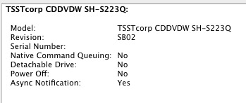

kdawg Posted December 27, 2009 Share Posted December 27, 2009 OK I just unplugged the two USB hubs from the motherboard headers and all unnecessary USB devices, both DVD drives, removed my WLAN card as well as removed the firewire and WLAN patches from DSDT. Still no auto-sleep. As far as the DVD Power off feature I have: Optiarc DVD RW AD-7241S: Model: Optiarc DVD RW AD-7241S Revision: 1.01 Native Command Queuing: No Detachable Drive: No Power Off: No Async Notification: No Link to comment https://www.insanelymac.com/forum/topic/192518-dsdt-fixes-for-gigabyte-boards/page/47/#findComment-1369914 Share on other sites More sharing options...

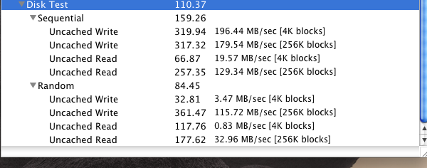

FKA Posted December 27, 2009 Share Posted December 27, 2009 for the record: doesn't seem to matter what device id i use for SATA - always get shockingly poor drive performance (I've been using ICH10 device ID for me ICH9-R and yello icon fix for sometime.) I hope everyone had a great Christmas .. D Link to comment https://www.insanelymac.com/forum/topic/192518-dsdt-fixes-for-gigabyte-boards/page/47/#findComment-1369929 Share on other sites More sharing options...

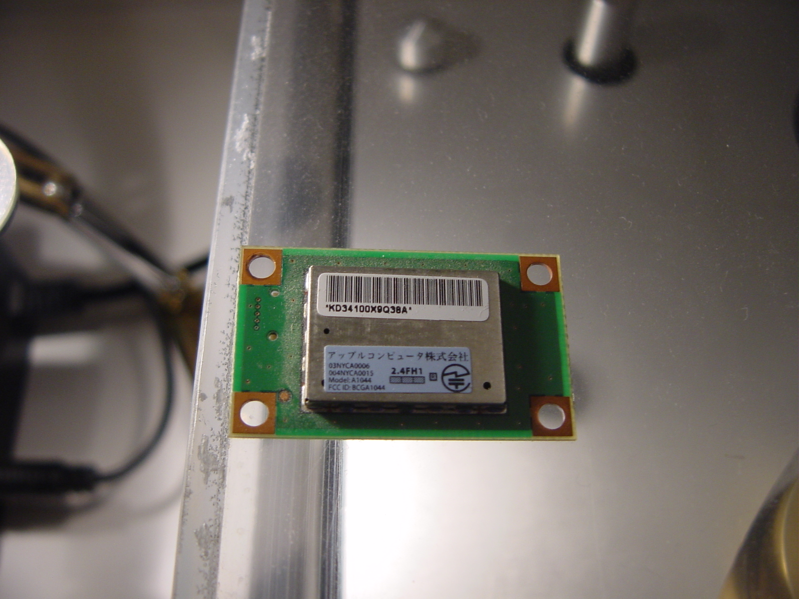

tinush Posted December 27, 2009 Share Posted December 27, 2009 What bluetooth adapter do you have? Are you able to select the "Allow Bluetooth devices to wake computer" option? Hi there Kdawg, i have this same problem, are there any other usb bleu-tooth devices that will have the wake from sleep capability (other the the D-link dbt-120) thnx T. btw also have this original device from a powermac, but can't find any pinout Link to comment https://www.insanelymac.com/forum/topic/192518-dsdt-fixes-for-gigabyte-boards/page/47/#findComment-1369933 Share on other sites More sharing options...
Aargh-a-Knot Posted December 27, 2009 Share Posted December 27, 2009 You think this "Power Off" feature can be turned on somehow? I have this: And I have sleep working fine. Link to comment https://www.insanelymac.com/forum/topic/192518-dsdt-fixes-for-gigabyte-boards/page/47/#findComment-1369947 Share on other sites More sharing options...
kdawg Posted December 27, 2009 Share Posted December 27, 2009 for the record:doesn't seem to matter what device id i use for SATA - always get shockingly poor drive performance (I've been using ICH10 device ID for me ICH9-R and yello icon fix for sometime.) I hope everyone had a great Christmas .. D I'll jump on that record and say mine aren't much better. A while back I tried The King's suggestions. Couldn't get it to work. I counld't get the IRQ to register 14, mine is 13. I have this: And I have sleep working fine. I don't know what you've done but I can't simulate it. Now I'm thinking it's the overclocking/speedstepping. I still have to post my BIOS settings. Do you feel like posting yours? I know it's a pain in the a$#%$#@. I'm running out of ideas. I might try and revering back to the original DSDT since I've basically stripped my rig down to the bare bones. I did notice you were using fakesmc v2.1. I have 2.5 and you're using a AppleUpstreamUserClientDisabler. A few of the remaining differences. Hi there Kdawg, i have this same problem, are there any other usb bleu-tooth devices that will have the wake from sleep capability (other the the D-link dbt-120) thnx T. btw also have this original device from a powermac, but can't find any pinout I've read the the Belkin F8T016 works. Link to comment https://www.insanelymac.com/forum/topic/192518-dsdt-fixes-for-gigabyte-boards/page/47/#findComment-1369949 Share on other sites More sharing options...
FKA Posted December 27, 2009 Share Posted December 27, 2009 I'll jump on that record and say mine aren't much better. A while back I tried The King's suggestions. Couldn't get it to work. I counld't get the IRQ to register 14, mine is 13. I don't know what you've done but I can't simulate it. Now I'm thinking it's the overclocking/speedstepping. I still have to post my BIOS settings. Do you feel like posting yours? I know it's a pain in the a$#%$#@. I'm running out of ideas. I might try and revering back to the original DSDT since I've basically stripped my rig down to the bare bones. I did notice you were using fakesmc v2.1. I have 2.5 and you're using a AppleUpstreamUserClientDisabler. A few of the remaining differences. I've read the the Belkin F8T016 works. I'd tried his suggestions back in September and that fix has carried over but as you say it's not working for my GB P35 board. DSDT03_09_09.dsl.zip EDit** athough I'd clearly not followed his guide properly as there are stil IRQNoFlag's under PIC and TMR lol! mm67 - do you see this problem with your MSI board? D. Link to comment https://www.insanelymac.com/forum/topic/192518-dsdt-fixes-for-gigabyte-boards/page/47/#findComment-1369959 Share on other sites More sharing options...

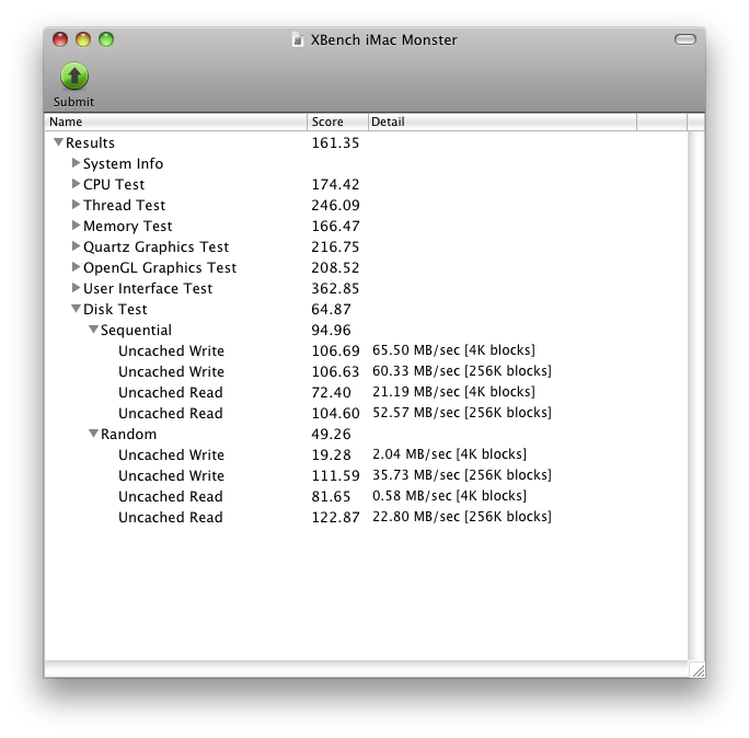

kdawg Posted December 27, 2009 Share Posted December 27, 2009 I'd tried his suggestions back in September and that fix has carried over but as you say it's not working for my GB P35 board. DSDT03_09_09.dsl.zip mm67 - do you see this problem with your MSI board? D. My iMac at work doesn't break 70. Link to comment https://www.insanelymac.com/forum/topic/192518-dsdt-fixes-for-gigabyte-boards/page/47/#findComment-1369962 Share on other sites More sharing options...
mm67 Posted December 27, 2009 Share Posted December 27, 2009 My iMac at work doesn't break 70. And here you can see benchmark of a real MacPro, page 27: http://www.supertalent.com/datasheets/Supe...0Whitepaper.pdf Our results actually look quite good. Link to comment https://www.insanelymac.com/forum/topic/192518-dsdt-fixes-for-gigabyte-boards/page/47/#findComment-1369981 Share on other sites More sharing options...

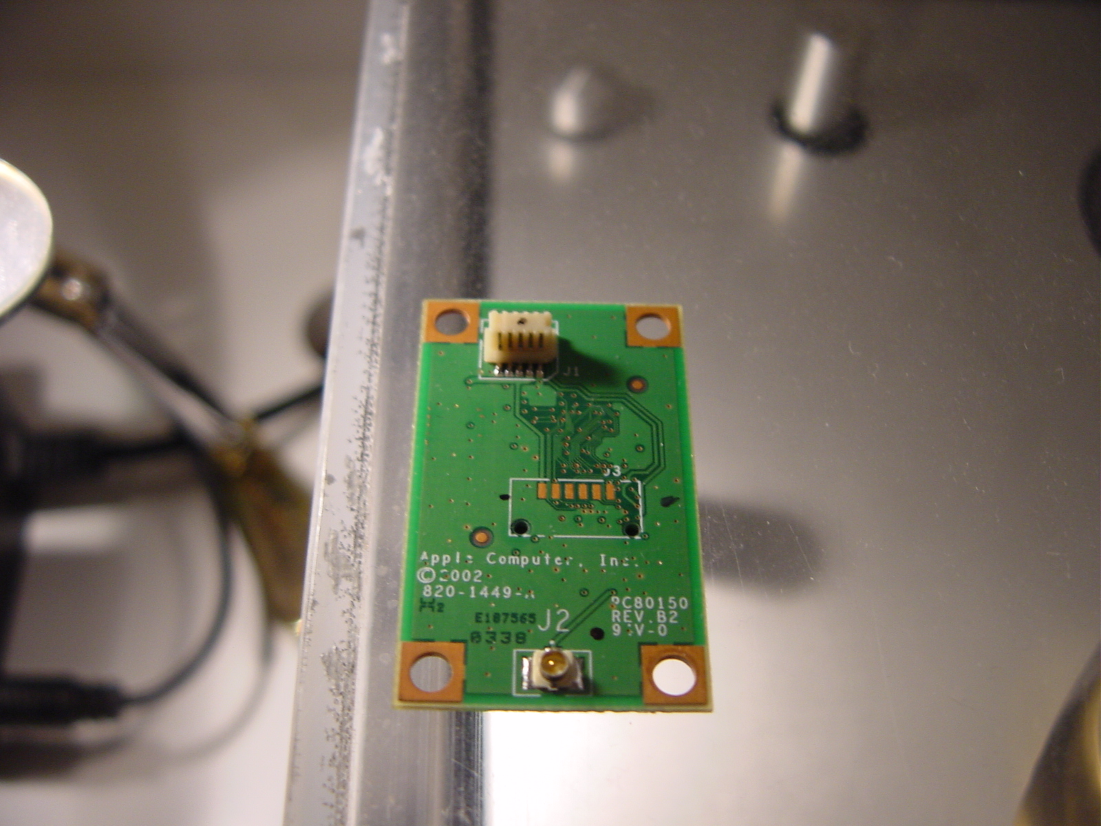

LocusOfControl Posted December 27, 2009 Share Posted December 27, 2009 Hi there Kdawg, i have this same problem, are there any other usb bleu-tooth devices that will have the wake from sleep capability (other the the D-link dbt-120) thnx T. btw also have this original device from a powermac, but can't find any pinout Hi I have 4 BT dongles but currently find the Trust 2400p to be the most reliable (Broadcom 2045, thought there are a couple of 2046 versions). By hacking the Bluetooth family kexts you can activate wake from BT. But as stated earlier this seems to affect the ability to idle (auto) sleep. Without the wake feature my auto sleep has always worked perfectly on SL I posted before christmas on the BT subject and received some feedback from kDawg etc Following a modified DSDT which I left installed I find that if I leave my computer running all day with wake from BT on then it will sleep regularly after about 1.5 to 2 hours of idle-ness. This is with idle sleep set to 10 mins Don't know why it suddenly decides to sleep then and not other times, although I noticed in BT packet logger BT packets seem to drop off before sleeping On another point I was curious as to why some people suggest switching off the 'put disks to sleep' feature, this sounds counter-intuitive in setting up sleep??? steve Link to comment https://www.insanelymac.com/forum/topic/192518-dsdt-fixes-for-gigabyte-boards/page/47/#findComment-1370015 Share on other sites More sharing options...
Common Sense Posted December 27, 2009 Share Posted December 27, 2009 I have this: And I have sleep working fine. Any chance you could disconnect your dvd writer and see if your idle sleep still works? That can help in understanding if idle sleep has something to do with the dvd writer or not. Do you have "Generic Drive Support" or is it recognized as "Apple Shipping Drive"? Link to comment https://www.insanelymac.com/forum/topic/192518-dsdt-fixes-for-gigabyte-boards/page/47/#findComment-1370032 Share on other sites More sharing options...

FKA Posted December 27, 2009 Share Posted December 27, 2009 And here you can see benchmark of a real MacPro, page 27: http://www.supertalent.com/datasheets/Supe...0Whitepaper.pdf Our results actually look quite good. Fair enough. Link to comment https://www.insanelymac.com/forum/topic/192518-dsdt-fixes-for-gigabyte-boards/page/47/#findComment-1370061 Share on other sites More sharing options...

tinush Posted December 27, 2009 Share Posted December 27, 2009 Hi I have 4 BT dongles but currently find the Trust 2400p to be the most reliable (Broadcom 2045, thought there are a couple of 2046 versions). By hacking the Bluetooth family kexts you can activate wake from BT. But as stated earlier this seems to affect the ability to idle (auto) sleep. Without the wake feature my auto sleep has always worked perfectly on SL I posted before christmas on the BT subject and received some feedback from kDawg etc Following a modified DSDT which I left installed I find that if I leave my computer running all day with wake from BT on then it will sleep regularly after about 1.5 to 2 hours of idle-ness. This is with idle sleep set to 10 mins Don't know why it suddenly decides to sleep then and not other times, although I noticed in BT packet logger BT packets seem to drop off before sleeping On another point I was curious as to why some people suggest switching off the 'put disks to sleep' feature, this sounds counter-intuitive in setting up sleep??? steve Thnx Steve & Kdawg, will check some different devices to see what works. T. Link to comment https://www.insanelymac.com/forum/topic/192518-dsdt-fixes-for-gigabyte-boards/page/47/#findComment-1370152 Share on other sites More sharing options...

MacUser2525 Posted December 28, 2009 Share Posted December 28, 2009 Any chance you could disconnect your dvd writer and see if your idle sleep still works? That can help in understanding if idle sleep has something to do with the dvd writer or not. Do you have "Generic Drive Support" or is it recognized as "Apple Shipping Drive"? My test system, the only one I let sleep, has generic supported the auto, menu and power button put it to sleep the dvd drive is of course connected while this happens. Link to comment https://www.insanelymac.com/forum/topic/192518-dsdt-fixes-for-gigabyte-boards/page/47/#findComment-1370506 Share on other sites More sharing options...
