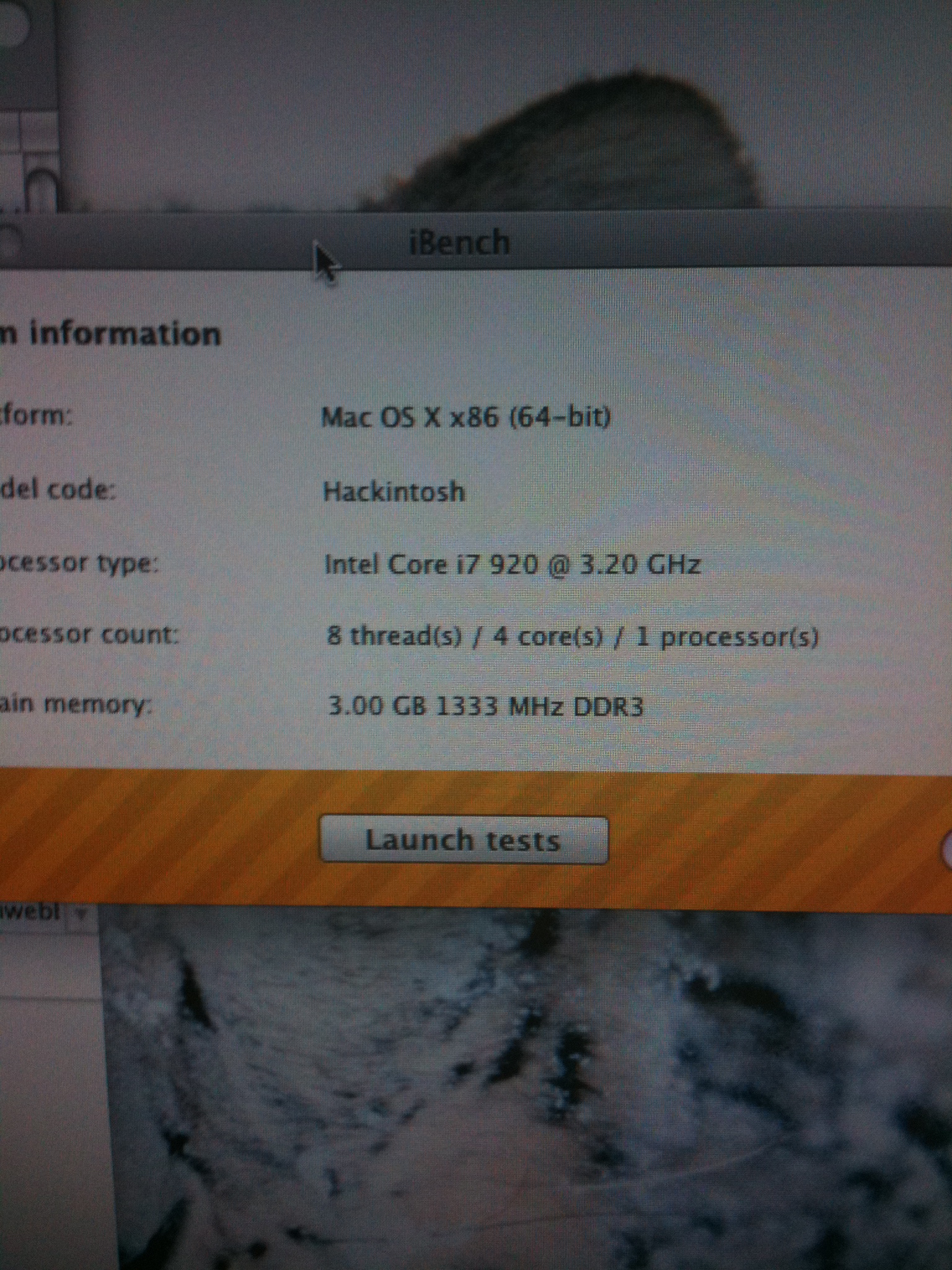

jsl Posted October 31, 2009 Share Posted October 31, 2009 Hi, tweak41: Following your method I can boot my Snow Leopard 10.6.1 in my Asus P6T SE (I7 920 + 6 GB RAM) with Nvidia 9800 GT (512 MB) successfully. However there is one minor problem for my Activity Monitor. With all cores and HT enabled there is only one CPU shown in my Activity Monitor, however with all cores enabled and HT disabled, there are 4 CPUs visible. For the above two conditions in About This Mac and CPU-X all show 4 cores in my system. Is there any possibility of your DSDT.aml file need modification ? Because I found there are several "Alias" in the DSDT.dsl which was decompiled from your DSDT.aml such as : DefinitionBlock ("./dsdt.aml", "DSDT", 1, "A1279", "A1279001", 0x00000001) { Scope (_PR) { Processor (P001, 0x01, 0x00000810, 0x06) {} Alias (P001, CPU1) Processor (P002, 0x02, 0x00000000, 0x00) {} Alias (P002, CPU2) Processor (P003, 0x03, 0x00000000, 0x00) {} Alias (P003, CPU3) Processor (P004, 0x04, 0x00000000, 0x00) {} Alias (P004, CPU4) Processor (P005, 0x05, 0x00000000, 0x00) {} Alias (P005, CPU5) Processor (P006, 0x06, 0x00000000, 0x00) {} Alias (P006, CPU6) Processor (P007, 0x07, 0x00000000, 0x00) {} Alias (P007, CPU7) Processor (P008, 0x08, 0x00000000, 0x00) {} Alias (P008, CPU8) Processor (P009, 0x09, 0x00000000, 0x00) {} Alias (P009, CPU9) Processor (P010, 0x0A, 0x00000000, 0x00) {} Processor (P011, 0x0B, 0x00000000, 0x00) {} Processor (P012, 0x0C, 0x00000000, 0x00) {} Processor (P013, 0x0D, 0x00000000, 0x00) {} Processor (P014, 0x0E, 0x00000000, 0x00) {} Processor (P015, 0x0F, 0x00000000, 0x00) {} Processor (P016, 0x10, 0x00000000, 0x00) {} } Also is your CPU shown as "Unknown" in the first appearance of "About This Mac", then corrected recognized as 4 cores in the following details menu ? If so, the above "A1279", "A1279001" need modified to "Intel", "I7" too. Looking forward to your reply ASAP and thanks again ! Link to comment https://www.insanelymac.com/forum/topic/189052-asus-p6t-se-retail-snow-leopard-installation-guide-flashdrive-updated-jun-28/page/3/#findComment-1315519 Share on other sites More sharing options...
orionquest Posted October 31, 2009 Share Posted October 31, 2009 Hi, tweak41: Following your method I can boot my Snow Leopard 10.6.1 in my Asus P6T SE (I7 920 + 6 GB RAM) with Nvidia 9800 GT (512 MB) successfully. However there is one minor problem for my Activity Monitor. With all cores and HT enabled there is only one CPU shown in my Activity Monitor, however with all cores enabled and HT disabled, there are 4 CPUs visible. For the above two conditions in About This Mac and CPU-X all show 4 cores in my system. I have the same processor like you and thought the same. But activity monitor shows you at the bottom using the cpu tab how many cpu's you have. I think it is correct you have 1 cpu with 4 cores. If we had the double cpu with 4 cores then we would see 2 cpu black boxes and the cpu floating monitor would have 16 bars (8 cores plus 8 virtual cores for HT). just a thought. oq Link to comment https://www.insanelymac.com/forum/topic/189052-asus-p6t-se-retail-snow-leopard-installation-guide-flashdrive-updated-jun-28/page/3/#findComment-1315559 Share on other sites More sharing options...

jsl Posted November 3, 2009 Share Posted November 3, 2009 Thanks tweak 41Your guide is maybe one of the most accured I've found on the net Instalation went problemlos Thanks for Your effort, saved me month of trying, like i did with my old P5K SE, before switching to P6T deluxe v1 Thanks again, you're the one Also work HT, all cores , everything, exept my PS2, but I switched to usb keyboard THANKS Congradulation you have got such an achievement for installation of Snow Leopard in P6T deluxe v1. I am using a P6T SE with I7 920 2.67GHz. In Windows 7 when I enabled HT I can see 8 cores at Task manager and disable HT there are 4 cores. But in Snow leopard 10.6.1 when I enable HT I can see only one core at Activity Monitor while CPU-X shows 4 cores and 4x4 threads. When I disable HT there are 4 cores at Activity Monitor and CPU-X shows 4 cores and 4 threads. Could you show me what are your results at Activity Monitor both enabled and disabled HT ? If you can post the photo of Activity Monitor with 16 cores will be highly appreciated. Thanks. Link to comment https://www.insanelymac.com/forum/topic/189052-asus-p6t-se-retail-snow-leopard-installation-guide-flashdrive-updated-jun-28/page/3/#findComment-1318305 Share on other sites More sharing options...
akhenamenra Posted November 4, 2009 Share Posted November 4, 2009 Congradulation you have got such an achievement for installation of Snow Leopard in P6T deluxe v1.I am using a P6T SE with I7 920 2.67GHz. In Windows 7 when I enabled HT I can see 8 cores at Task manager and disable HT there are 4 cores. But in Snow leopard 10.6.1 when I enable HT I can see only one core at Activity Monitor while CPU-X shows 4 cores and 4x4 threads. When I disable HT there are 4 cores at Activity Monitor and CPU-X shows 4 cores and 4 threads. Could you show me what are your results at Activity Monitor both enabled and disabled HT ? If you can post the photo of Activity Monitor with 16 cores will be highly appreciated. Thanks. bro have you used i bench to chec as i have ht enabled and all cores and with ibench it recognises these Link to comment https://www.insanelymac.com/forum/topic/189052-asus-p6t-se-retail-snow-leopard-installation-guide-flashdrive-updated-jun-28/page/3/#findComment-1319290 Share on other sites More sharing options...
jsl Posted November 4, 2009 Share Posted November 4, 2009 bro have you used i bench to chec as i have ht enabled and all cores and with ibench it recognises these Thanks for your suggestion. Using iBench I can confirm that all 4 cores can enable HT in spite of Activity Monitor showing just one CPU only. Just curious to know is there anyone find 8 cores in his/her Activity Monitor ? Link to comment https://www.insanelymac.com/forum/topic/189052-asus-p6t-se-retail-snow-leopard-installation-guide-flashdrive-updated-jun-28/page/3/#findComment-1319523 Share on other sites More sharing options...
