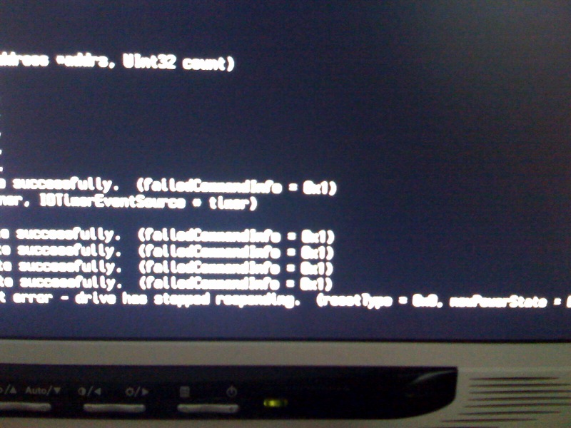

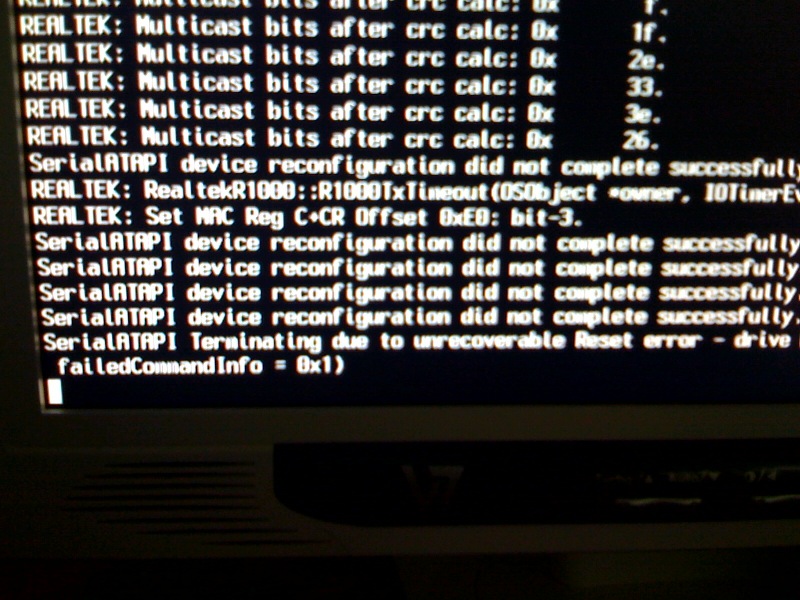

The_old_PC Posted October 3, 2009 Share Posted October 3, 2009 Ok i tried it today and it did not work It could be because i have the p6t and not the se version. Just the standard. I didnt really see any diffrence but maybe you guys kann help. At first it didnt work, because the HD was on ide i changed it to AHCI and it stops load ing here: Please help Thanks ps. i changed the boot file to the efi 10.3 as i have an ati hd 4870 p.p.s everybody who installed windows on theire pc already and cant boot into it anymore after the BIOS update check if you are on ide or ahci! Link to comment https://www.insanelymac.com/forum/topic/189052-asus-p6t-se-retail-snow-leopard-installation-guide-flashdrive-updated-jun-28/page/2/#findComment-1288489 Share on other sites More sharing options...

The_old_PC Posted October 3, 2009 Share Posted October 3, 2009 actually i did but it didnt work it stoped there in the pic http://www.insanelymac.com/forum/index.php?showtopic=187151 i found this guide ,but i cant work in terminal it asks in the first command to rewrite the mbr i thought that should be in the 3 command? Link to comment https://www.insanelymac.com/forum/topic/189052-asus-p6t-se-retail-snow-leopard-installation-guide-flashdrive-updated-jun-28/page/2/#findComment-1288810 Share on other sites More sharing options...

harshw Posted October 4, 2009 Share Posted October 4, 2009 Ok i tried it today and it did not work It could be because i have the p6t and not the se version. Just the standard. I didnt really see any diffrence but maybe you guys kann help. At first it didnt work, because the HD was on ide i changed it to AHCI and it stops load ing here: Please help Thanks ps. i changed the boot file to the efi 10.3 as i have an ati hd 4870 p.p.s everybody who installed windows on theire pc already and cant boot into it anymore after the BIOS update check if you are on ide or ahci! The SerialATAPI stuff indicates that your HDD is not accessible by OSX. Try Having only ONE hdd in the machine connected and nothing else Generating and patching your DSDT from Windows or Linux for the IRQs Making sure SATA is set to AHCI in BIOS Making sure HDD is connected to SATA1 Also try experimenting with different IOAHCI injector kexts Link to comment https://www.insanelymac.com/forum/topic/189052-asus-p6t-se-retail-snow-leopard-installation-guide-flashdrive-updated-jun-28/page/2/#findComment-1289917 Share on other sites More sharing options...
The_old_PC Posted October 5, 2009 Share Posted October 5, 2009 The SerialATAPI stuff indicates that your HDD is not accessible by OSX. Try Having only ONE hdd in the machine connected and nothing else Generating and patching your DSDT from Windows or Linux for the IRQs Making sure SATA is set to AHCI in BIOS Making sure HDD is connected to SATA1 Also try experimenting with different IOAHCI injector kexts Ok i will try with one hdd it is set to ahci and sata1 What do you mean to patch the dsdt from windows? I will try this guide and the other on until some of it works thanks tweak for the support! ps thanks harshw Link to comment https://www.insanelymac.com/forum/topic/189052-asus-p6t-se-retail-snow-leopard-installation-guide-flashdrive-updated-jun-28/page/2/#findComment-1290346 Share on other sites More sharing options...

tweak41 Posted October 5, 2009 Author Share Posted October 5, 2009 Ok i will try with one hddit is set to ahci and sata1 What do you mean to patch the dsdt from windows? I will try this guide and the other on until some of it works thanks tweak for the support! ps thanks harshw Download this: http://www.acpica.org/downloads/binary_tools.php Extract the files somewhere you can easily access them from command prompt and then run command prompt as Administrator. Navigate to that folder and run the command: iasl -g This will dump a file that ends in .dsl into your folder. Mine was named dsdt_A1279001.dsl (as an example). This is the file that you need to edit and recompile to make your DSDT.aml file. I reckon you probably aren't quite sure how to go about doing this, so if you want I'll edit it for you and send it back. Just attach it in a zip file to your post. Otherwise if you want to try yourself you can start here: http://www.projectosx.com/forum/index.php?showtopic=564 Link to comment https://www.insanelymac.com/forum/topic/189052-asus-p6t-se-retail-snow-leopard-installation-guide-flashdrive-updated-jun-28/page/2/#findComment-1290754 Share on other sites More sharing options...
