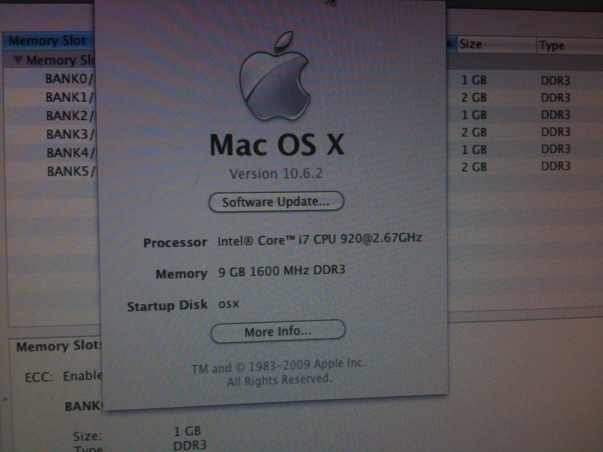

_Wolverine_ Posted April 26, 2010 Share Posted April 26, 2010 Guys, i have a: P6T-SE i7 920 3gb corsair 1333 radeon 4870 is it possible to have 9gb ram? will it become instable? or should i go with 6gb? Link to comment https://www.insanelymac.com/forum/topic/189052-asus-p6t-se-retail-snow-leopard-installation-guide-flashdrive-updated-jun-28/page/26/#findComment-1456295 Share on other sites More sharing options...

_Wolverine_ Posted April 27, 2010 Share Posted April 27, 2010 thanks a lot Link to comment https://www.insanelymac.com/forum/topic/189052-asus-p6t-se-retail-snow-leopard-installation-guide-flashdrive-updated-jun-28/page/26/#findComment-1456481 Share on other sites More sharing options...

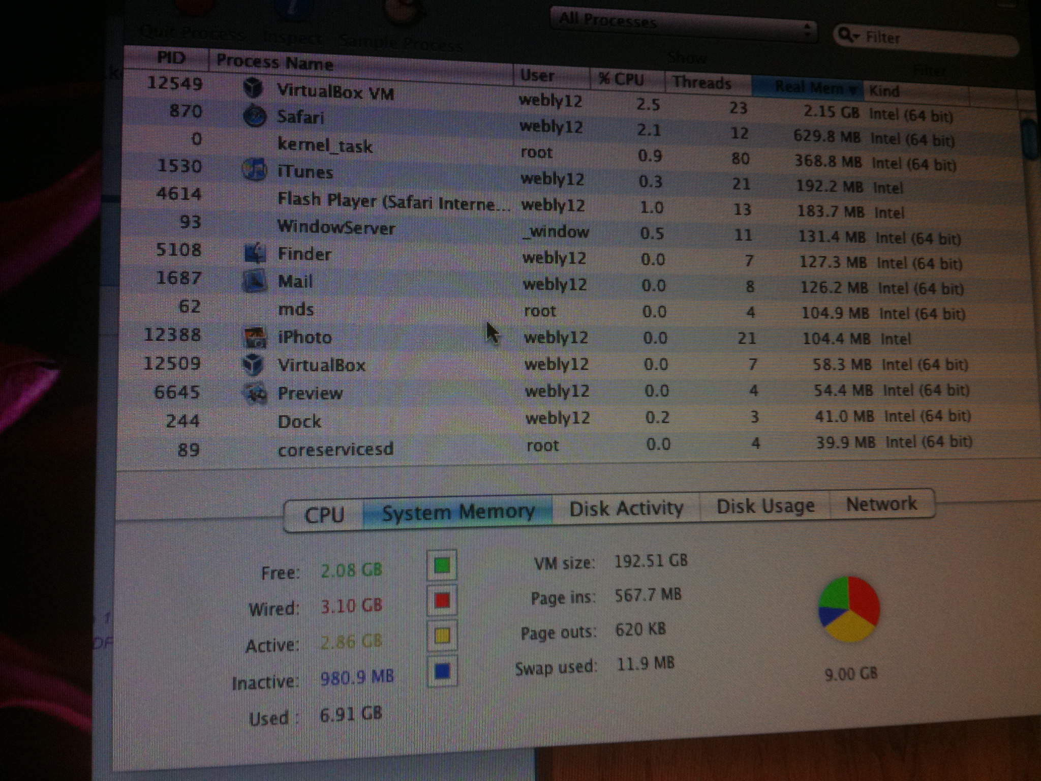

_Wolverine_ Posted April 29, 2010 Share Posted April 29, 2010 Woowwww Now im getting 9800 on Geekbench!!!! P6T-SE (bios 0808) i7 920 (@2.6) 6gb 1600mhz corsair (3x2gb) radeon hd 4870 thanks guys! Link to comment https://www.insanelymac.com/forum/topic/189052-asus-p6t-se-retail-snow-leopard-installation-guide-flashdrive-updated-jun-28/page/26/#findComment-1458495 Share on other sites More sharing options...
