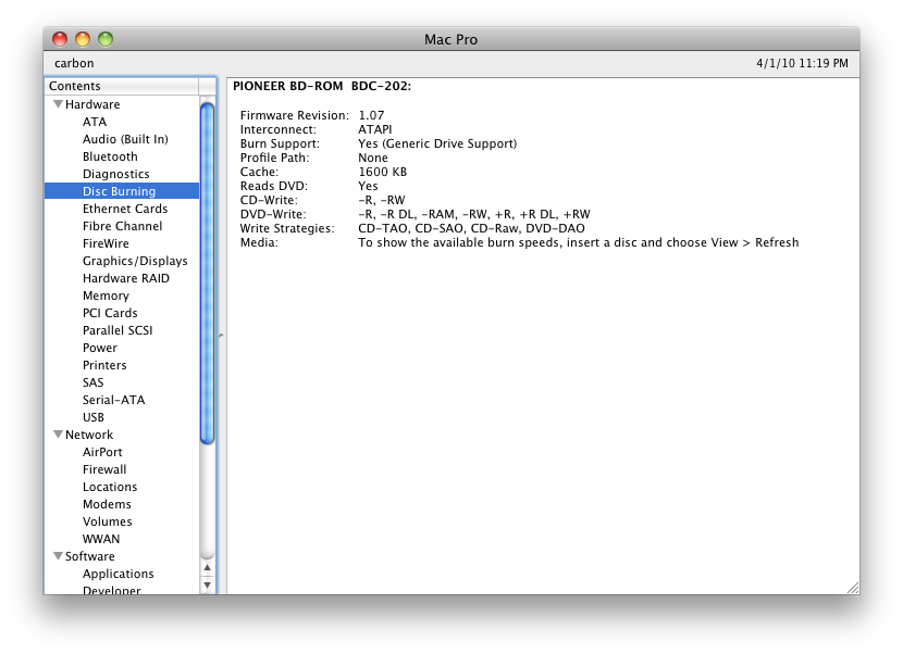

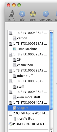

codymac Posted March 31, 2010 Share Posted March 31, 2010 those ports should work just like the others. Make sure they're enabled in bios. Mine work, though one port was bad. The other port connects my optical drive. +1 The purple ports work fine but must be enabled in the BIOS. I've got 7 drives in mine plus a BD-ROM. Link to comment https://www.insanelymac.com/forum/topic/187440-lifehacker-guide-with-ga-ep45-ud3p-motherboard/page/57/#findComment-1438888 Share on other sites More sharing options...

codymac Posted April 2, 2010 Share Posted April 2, 2010 wasn't it a bag of hurt for you? LMAO! Nah... I'm not wearing a black turtleneck and trying to sell downloaded content. WHAT BD-ROM?Does it read discs/burn in OSX? I. WANT. IT. Yup - burns and reads fine out of the box. I just burned a dual layer with it a couple of days ago. I mostly use it to rip Blurays with MakeMKV though (I have a mini running Plex attached to the TV). It's a Pioneer BDC-202 but I think it's been superseded by the BDC-2202 which supposedly works the same. From what I've read, MakeMKV will allow you to play a Bluray too, but it's a bit of a convoluted process so I haven't even tried. Link to comment https://www.insanelymac.com/forum/topic/187440-lifehacker-guide-with-ga-ep45-ud3p-motherboard/page/57/#findComment-1440105 Share on other sites More sharing options...
