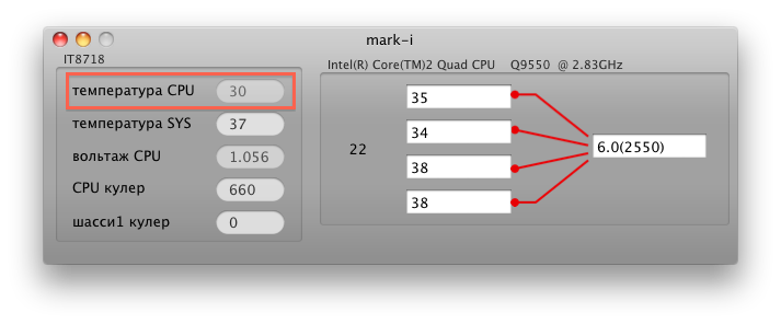

bean5 Posted April 3, 2010 Share Posted April 3, 2010 so would you say that the temps are being reported higher than what they actually are? What would be considered safe working temps for this chip anyways? Like, what's a good idle temp to shoot for, and what's a good average for when the cpu is under load? Link to comment https://www.insanelymac.com/forum/topic/187440-lifehacker-guide-with-ga-ep45-ud3p-motherboard/page/58/#findComment-1440892 Share on other sites More sharing options...
scorcho Posted April 3, 2010 Share Posted April 3, 2010 as long as you're under 90C during full load you really have nothing to worry about. mincing between 40C and 50C means very little to the life of the equipment. well, that is unless you realistically believe you'll be using that config for the next 20 years. Link to comment https://www.insanelymac.com/forum/topic/187440-lifehacker-guide-with-ga-ep45-ud3p-motherboard/page/58/#findComment-1440943 Share on other sites More sharing options...
MacTech84 Posted April 3, 2010 Share Posted April 3, 2010 so would you say that the temps are being reported higher than what they actually are? What would be considered safe working temps for this chip anyways? Like, what's a good idle temp to shoot for, and what's a good average for when the cpu is under load? CoHPhasor is dead on right, from previous testing we have come across that the temps are about 10 degrees hotter then they actually are. The translation layer that the FakeSMC does is good for what it does, but its not the best for translating temps. Do not worry, one thing to keep in mind as well, the BIOS in your computer is set to automatically adjust fan speeds for your system and supersedes what the OS tells it. It will monitor your system and adjust when it needs to. Link to comment https://www.insanelymac.com/forum/topic/187440-lifehacker-guide-with-ga-ep45-ud3p-motherboard/page/58/#findComment-1440958 Share on other sites More sharing options...
mm67 Posted April 3, 2010 Share Posted April 3, 2010 CoHPhasor is dead on right, from previous testing we have come across that the temps are about 10 degrees hotter then they actually are. The translation layer that the FakeSMC does is good for what it does, but its not the best for translating temps. Do not worry, one thing to keep in mind as well, the BIOS in your computer is set to automatically adjust fan speeds for your system and supersedes what the OS tells it. It will monitor your system and adjust when it needs to. Core temps that iStat shows are exactly same on Windows and OS X. These are my temps from OS X idling and running Linpack stress test: and this shows the same situation from Windows 7: Temperature that you see in bios is from motherboards sensor and it usually is a bit cooler than core temps that are read from cpu itself,on OS X you can monitor that temperature using mark-i program, it's the one in upper left corner. Link to comment https://www.insanelymac.com/forum/topic/187440-lifehacker-guide-with-ga-ep45-ud3p-motherboard/page/58/#findComment-1441029 Share on other sites More sharing options...

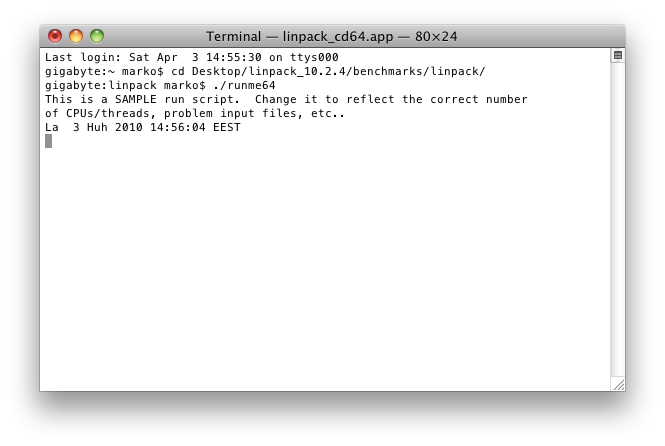

bean5 Posted April 3, 2010 Share Posted April 3, 2010 I don't understand how to use this... I get this: *****-Mac-Pro:~ ****$ /Users/****/Downloads/linpack_10.2.4/benchmarks/linpack/runme64 ; exit; This is a SAMPLE run script. Change it to reflect the correct number of CPUs/threads, problem input files, etc.. Sat Apr 3 04:06:52 PDT 2010 /Users/****/Downloads/linpack_10.2.4/benchmarks/linpack/runme64: line 11: ./linpack_cd64.app: No such file or directory Done: Sat Apr 3 04:06:52 PDT 2010 logout [Process completed] Link to comment https://www.insanelymac.com/forum/topic/187440-lifehacker-guide-with-ga-ep45-ud3p-motherboard/page/58/#findComment-1441104 Share on other sites More sharing options...
mm67 Posted April 3, 2010 Share Posted April 3, 2010 I don't understand how to use this... I get this: *****-Mac-Pro:~ ****$ /Users/****/Downloads/linpack_10.2.4/benchmarks/linpack/runme64 ; exit; This is a SAMPLE run script. Change it to reflect the correct number of CPUs/threads, problem input files, etc.. Sat Apr 3 04:06:52 PDT 2010 /Users/****/Downloads/linpack_10.2.4/benchmarks/linpack/runme64: line 11: ./linpack_cd64.app: No such file or directory Done: Sat Apr 3 04:06:52 PDT 2010 logout [Process completed] Open Terminal, go to folder where you extracted Linpack to and run ./runme64. Like this: Link to comment https://www.insanelymac.com/forum/topic/187440-lifehacker-guide-with-ga-ep45-ud3p-motherboard/page/58/#findComment-1441131 Share on other sites More sharing options...
backinmac Posted April 3, 2010 Share Posted April 3, 2010 I don't understand how to use this... I get this: *****-Mac-Pro:~ ****$ /Users/****/Downloads/linpack_10.2.4/benchmarks/linpack/runme64 ; exit; This is a SAMPLE run script. Change it to reflect the correct number of CPUs/threads, problem input files, etc.. Sat Apr 3 04:06:52 PDT 2010 /Users/****/Downloads/linpack_10.2.4/benchmarks/linpack/runme64: line 11: ./linpack_cd64.app: No such file or directory Done: Sat Apr 3 04:06:52 PDT 2010 logout [Process completed] Yes, I get the same thing when clicking on the Runme. But if you click on the file called like LinpackCD_64 or something along those lines, you get a message saying that the classic environment is no longer supported. Do we need OS 9 or OS 9 drivers to run this? Bean, I think you should try Prime95 instead. It's pretty much the standard for testing your overclock settings. Google is your friend. EDIT: I forgot, you need a Winblows installation for that. Link to comment https://www.insanelymac.com/forum/topic/187440-lifehacker-guide-with-ga-ep45-ud3p-motherboard/page/58/#findComment-1441133 Share on other sites More sharing options...
mm67 Posted April 3, 2010 Share Posted April 3, 2010 Yes, I get the same thing when clicking on the Runme. But if you click on the file called like LinpackCD_64 or something along those lines, you get a message saying that the classic environment is no longer supported. Do we need OS 9 or OS 9 drivers to run this? Bean, I think you should try Prime95 instead. It's pretty much the standard for testing your overclock settings. Google is your friend. EDIT: I forgot, you need a Winblows installation for that. There is Prime95 for OS X also, you can get it here : http://mersenneforum.org/gimps/Prime95-MacOSX-2511.zip Runs exactly the same tests as Windows version but no gui, you have to use Terminal like with Linpack Link to comment https://www.insanelymac.com/forum/topic/187440-lifehacker-guide-with-ga-ep45-ud3p-motherboard/page/58/#findComment-1441140 Share on other sites More sharing options...

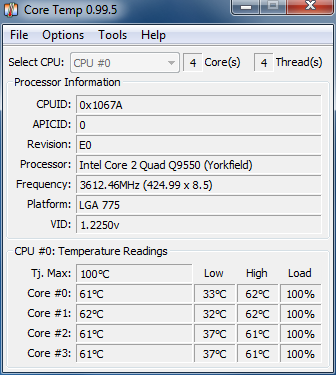

MacTech84 Posted April 3, 2010 Share Posted April 3, 2010 Core temps that iStat shows are exactly same on Windows and OS X. These are my temps from OS X idling and running Linpack stress test: and this shows the same situation from Windows 7: Temperature that you see in bios is from motherboards sensor and it usually is a bit cooler than core temps that are read from cpu itself,on OS X you can monitor that temperature using mark-i program, it's the one in upper left corner. well, here are my temps, idling on a rather cool night. As you can see, it shows that it's idling in the 40's. The bios shows it in the thirties. Overclocked to 3.33ghz in OSX it's in the 50's. Granted, it's rather cool at the moment where I am so the temps are about 5 degrees lower than what I would expect. In windows 7, this is what I get, top not OC, bottom OC to 3.33ghz So, does that sound about right? I'm not using the stock heatsink/fan. I got that arctic freezer cooler whatever it's called. I'm pretty sure I put it on right (not too much thermal paste) however I think I may have sunken in the cpu casing (is that bad?). What's the general concensus? Will I be alright if I overclock it to 3.33ghz and have istats reporting that the temps are in the 50's-60's while idle? Are you using the OS X Bootloader to select the Windows drive upon boot? If so... guess what... That supersedes the Windows Bootloader and its translation of hardware to software. You get the same temps thanks to our bootloader. Let me put it this way, if you smell burning silicon you have a problem, if you do not, then you are all set and have nothing to worry about. Link to comment https://www.insanelymac.com/forum/topic/187440-lifehacker-guide-with-ga-ep45-ud3p-motherboard/page/58/#findComment-1441275 Share on other sites More sharing options...
