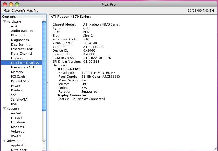

xxgg Posted October 26, 2009 Share Posted October 26, 2009 Just wondering... How can check if QE/CI & OpenCL is working on my ATi Radeon 4890 1024MB PCIe ? Following is what is shown in my Profiler... ATI Radeon 4890 Series: Chipset Model: ATI Radeon 4890 Series Type: GPU Bus: PCIe Slot: Slot-1 PCIe Lane Width: x16 VRAM (Total): 1024 MB Vendor: ATI (0x1002) Device ID: 0x9460 Revision ID: 0x0000 ROM Revision: 113-B7710C-176 EFI Driver Version: 01.00.318 Displays: DELL 2407WFP: Resolution: 1920 x 1200 @ 60 Hz Pixel Depth: 32-Bit Color (ARGB8888) Main Display: Yes Mirror: Off Online: Yes Rotation: Supported VX2025wm: Resolution: 1050 x 1680 @ 60 Hz Pixel Depth: 32-Bit Color (ARGB8888) Mirror: Off Online: Yes Rotation: 90 Link to comment https://www.insanelymac.com/forum/topic/187440-lifehacker-guide-with-ga-ep45-ud3p-motherboard/page/14/#findComment-1311015 Share on other sites More sharing options...

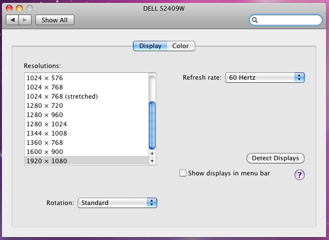

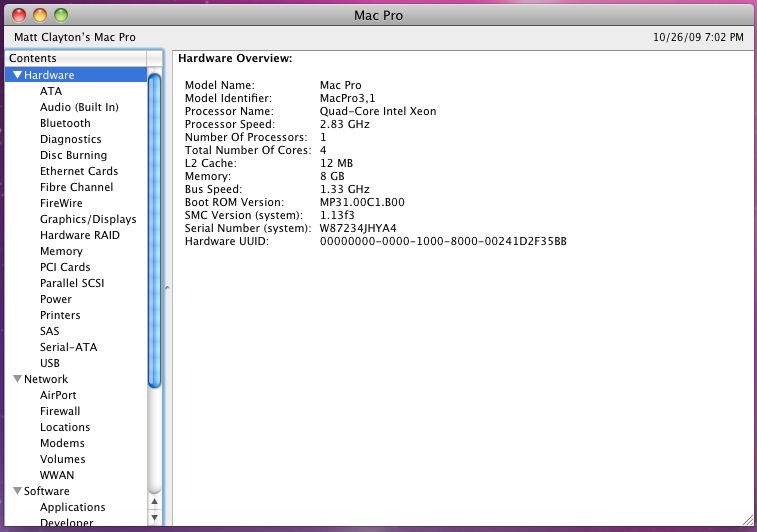

mcclayton Posted October 27, 2009 Share Posted October 27, 2009 Here are the screen shots from system profiler and system preferences. Just out of curiosity, how would it not be working and I would not realize it? I'm quite sure that it's currently doing everything that I need it to do. I have a Matrox CompressHD in one of the PCIe slots that is working perfectly. I'll try some HD video capture tomorrow or Thursday with the other PCIe card. I have a Vantec PCI FireWire 800 card that works perfectly under 10.5.8 that doesn't seem to be recognized in Snow Leopard and it would be very advantageous for that to work. Also, I installed the eSATA ports that ship with the EP45-UD3P plugged into the purple eSATA ports on the board and those do no mount my external drive (Thermaltake BlacX). If I could get those two things to work I'd be very happy. matt I'm quite positive its not working for you and you just don't realize it. Maybe take some screenshots of system profiler and sys preferences pertaining to graphics/display? -Stell Link to comment https://www.insanelymac.com/forum/topic/187440-lifehacker-guide-with-ga-ep45-ud3p-motherboard/page/14/#findComment-1311380 Share on other sites More sharing options...
