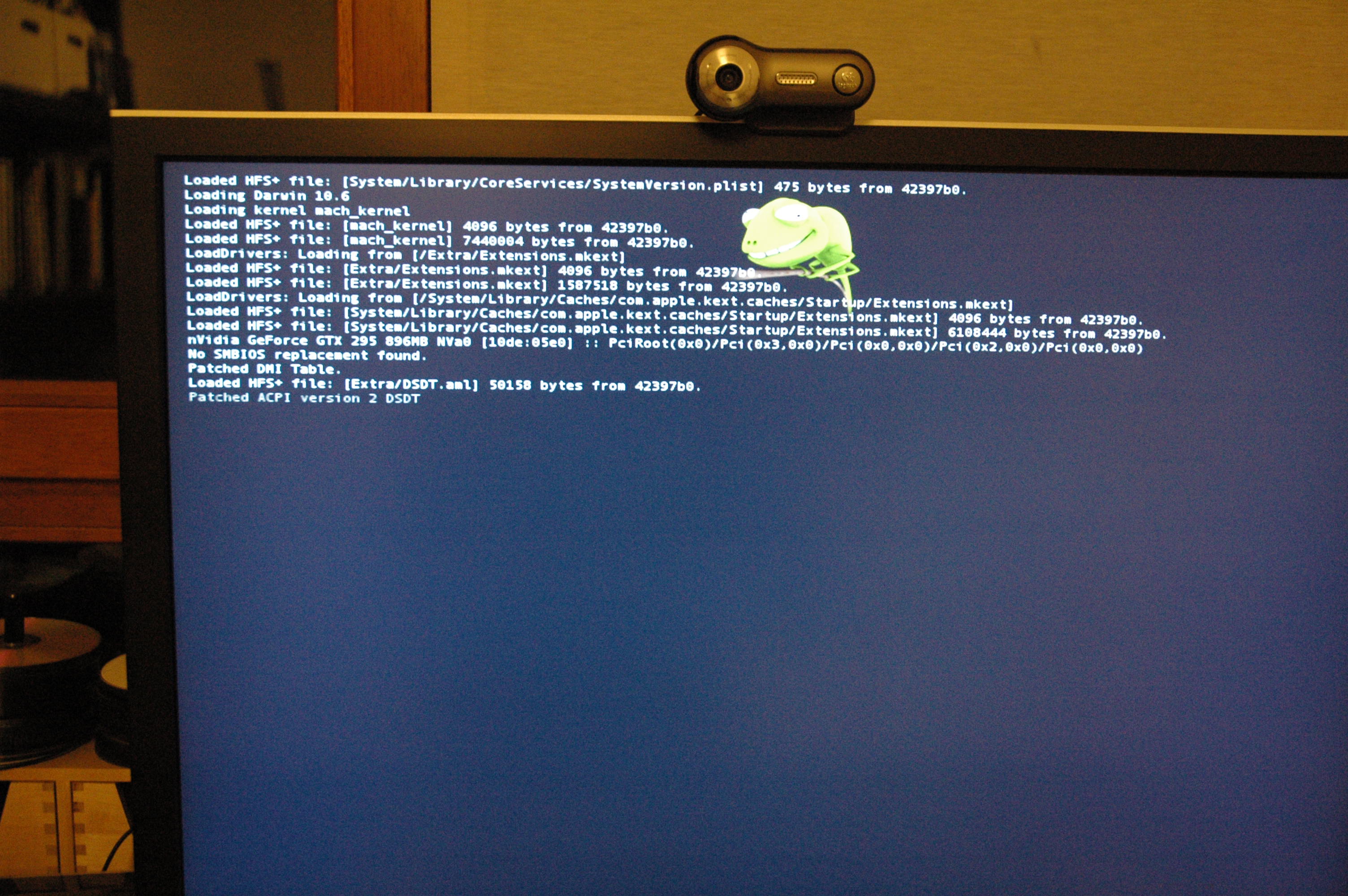

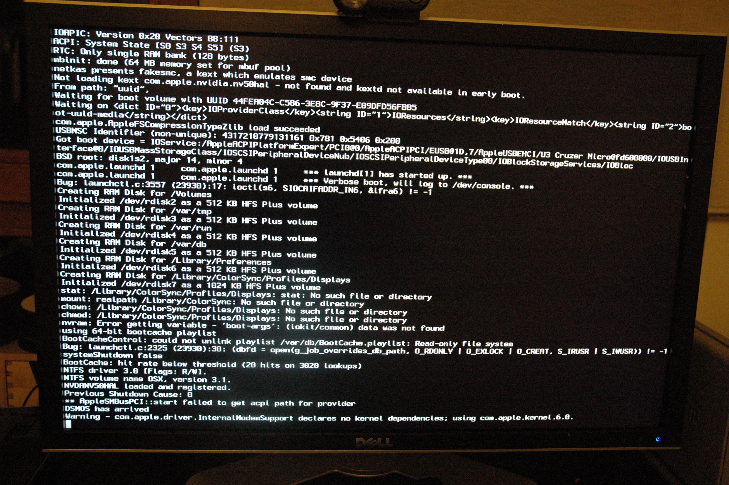

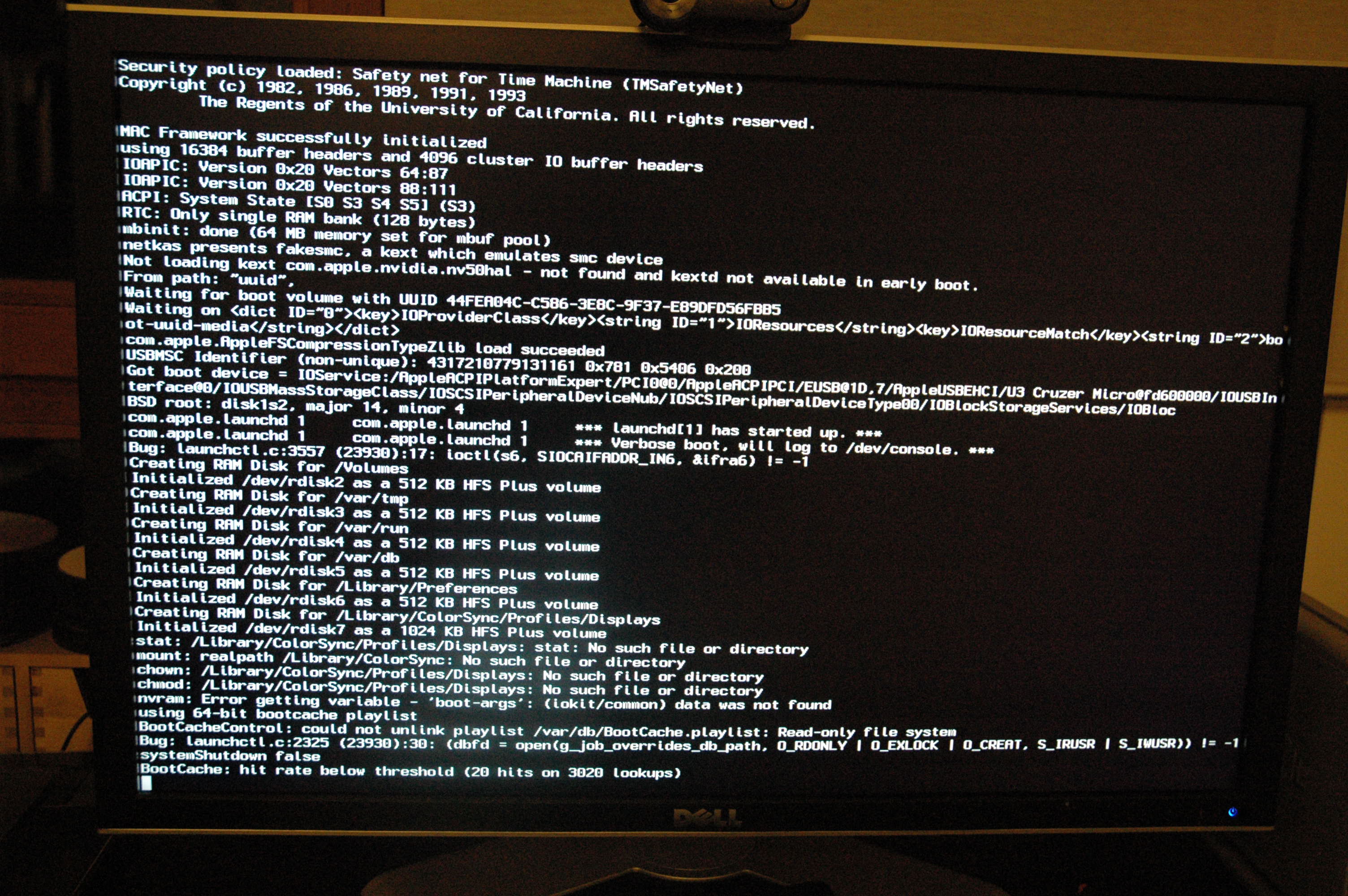

ps2pk Posted December 3, 2009 Share Posted December 3, 2009 Is the dsdt file from trick77 already in the essentials pack or should it be downloaded?? I have the same spec , but with the nvidia gtx 295. Ill give it another go with this pack, but ive tried this guide man times with no luck, and can only presume that the gtx295 is the problem. Hey. Yeah the dsdt is from trick77 and is already in the pack. Is your gtx295 dual slot? A quote from someone who got it working - eVGA GTX 295 ---> EFI String in com.apple.Boot.plist + NVGTX295.Fix.kext - Both GPU's detected 1792MB" Here's another link regarding the 295 but it's single pcb. This guy says gtx295 works fine. Dual looks to be fine. I'm pretty sure the pack will work for you. At least it'll get you into snow leopard and from there you can mess around as you like. Remember to remove evoenabler from both p6t essentials > p6t essentials > kexts > remove evoenabler (just move to trash). And do the same from p6t essentials > _maxosx > p6t essentials > kexts > remove enabler. Another thing. Make sure your bios is set up correctly. For the time being just disconnect power to all your other drives and remember the SL drive should be in SATA 1. First save your bios settings by in the 2nd to last tab. It says save profile or something. this is optional but it's better to install at factory defaults. Then reset factory dafaults and make the following changes. Storage = ACHI Enable ACPI Disable JMICRON Disable Firewire Disable that asus magicgate thingy Put the usb installer as the only harddrive disk and it should also be the first for boot up priority. and of course once you get to the bootloader go to verbose mode and type in -v. I'm sure you know what you're doing. If you need help let me know and I'll see what I can do. Link to comment Share on other sites More sharing options...
alexdbad Posted December 3, 2009 Share Posted December 3, 2009 Hey. Yeah the dsdt is from trick77 and is already in the pack. Is your gtx295 dual slot? A quote from someone who got it working - eVGA GTX 295 ---> EFI String in com.apple.Boot.plist + NVGTX295.Fix.kext - Both GPU's detected 1792MB" Here's another link regarding the 295 but it's single pcb. This guy says gtx295 works fine. Dual looks to be fine. I'm pretty sure the pack will work for you. At least it'll get you into snow leopard and from there you can mess around as you like. Remember to remove evoenabler from both p6t essentials > p6t essentials > kexts > remove evoenabler (just move to trash). And do the same from p6t essentials > _maxosx > p6t essentials > kexts > remove enabler. Another thing. Make sure your bios is set up correctly. For the time being just disconnect power to all your other drives and remember the SL drive should be in SATA 1. First save your bios settings by in the 2nd to last tab. It says save profile or something. this is optional but it's better to install at factory defaults. Then reset factory dafaults and make the following changes. Storage = ACHI Enable ACPI Disable JMICRON Disable Firewire Disable that asus magicgate thingy Put the usb installer as the only harddrive disk and it should also be the first for boot up priority. and of course once you get to the bootloader go to verbose mode and type in -v. I'm sure you know what you're doing. If you need help let me know and I'll see what I can do. Hi and thanks for the help!! I will give it a go tommorrow. I have the dual pcb board.I have tried the kexts mentioned above and the script (although i had to modify it slightly as the instructions said (in french) i had to find the pci e (graphics card) location, and modify some of the script. I presume i just then copy the whole script and paste it in the com.apple.boot.plist?? below the text that is already there. If i just use the essentials you gave me, without the kext for gtx, and use the method you mentioned fo install. Do you think it will install? I will try and i will take some pics of the error messages, if any. Thanks again Alexdbad Link to comment Share on other sites More sharing options...
