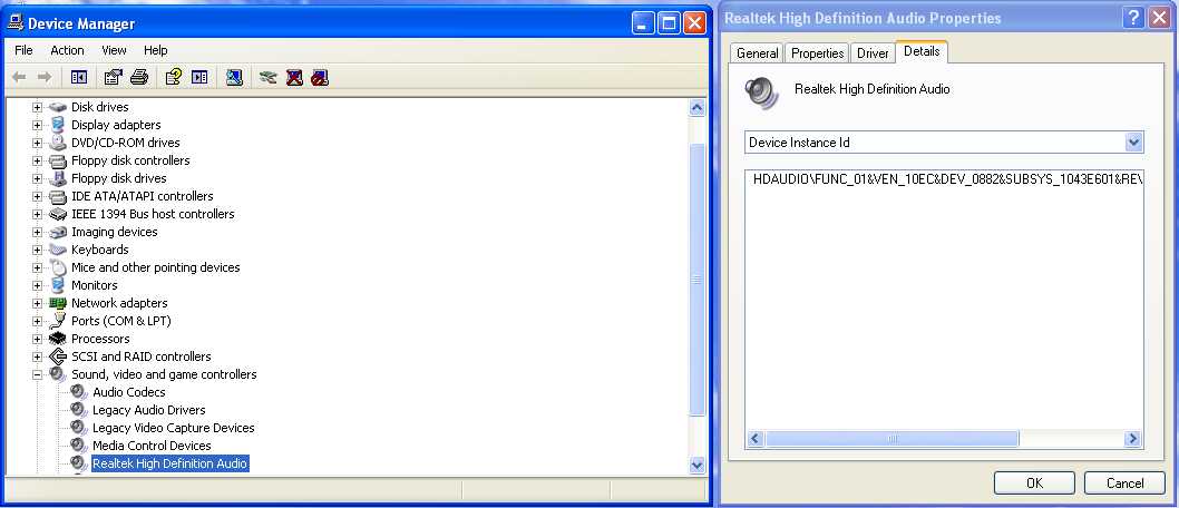

Rammjet Posted May 30, 2006 Share Posted May 30, 2006 Edit: The following guide is for getting ALC882 sound out working. The process may work with any ALC8xx chipset with a few changes. See the Appendix at the end of the guide for how to make those changes. The Guide I have yet to see the definitive guide here on getting ALC882 sound working. The best one I've seen comes from aRt on another forum and this is it (with some modifications): How to get HD audio working - sound for ya!!! 1) Backup AppleHDA.kext: In Terminal, type: cd /System/Library/Extensions sudo mkdir audio_backup sudo mv AppleHDA.kext audio_backup/ 2) Edit AppleAzaliaAudio.kext: In Terminal, type: cd /System/Library/Extensions sudo pico AppleAzaliaAudio.kext/Contents/Info.plist Search for IOHDAudioCodecVendorID (press Ctrl + W ) Find: <key>IOHDAudioCodecVendorID</key> <string>0x10ec0880</string> Change <string>0x10ec088 0 </string> -- to -- <string>0x10ec088 2 </string> Exit pico: press Ctrl + O to save and then Ctrl + X to exit In Terminal, type: sudo pico AppleAzaliaAudio.kext/Contents/PlugIns/AppleAzaliaController.kext/Contents/Info.plist Search for IOPCIPrimaryMatch (press Ctrl + W ) Find: <key>IOPCIPrimaryMatch</key> <string>0xNNNN8086</string> (where NNNN are any 4 characters) Change <string>0x NNNN 8086</string> -- to -- <string>0x 27d8 8086</string> ( note : for ALC882, the string is probably correct without any edit) Exit pico: press Ctrl + O to save and then Ctrl + X to exit 3) Clean up the system: In Terminal, type: sudo diskutil repairpermissions / sudo chown -R root:wheel AppleAzaliaAudio.kext sudo chmod -R 755 AppleAzaliaAudio.kext cd /System/Library sudo rm -rf Extensions.mkext Extensions.kextcache 4) Then, reboot and enjoy sound out of two channels. Appendix The following information might help you get your ALC8xx sound out working. The strings that are replaced in the guide above are for Realtek ALC882 only. For other versions of ALC8xx sound or if you are having trouble getting ALC882 sound working, we need to determine the vendor and device ids of the audio device and the audio hub. There are no guarantees that this will get your sound working, but I am pretty sure this also works for ALC880, ALC888, ALC861 and maybe others. To do this, go into Windows, then go to Device Manager: Step A. Under "Sound, video and game controllers", select "Realtek High Definition Audio". Get Properties and then click on the Detail tab. Record the vendor and device ids. As an example, in this picture, the set of id's are vendor = "10EC" and device = "0882" Step B. Under "System devices", find "Microsoft UAA Bus Driver For High Definition Audio" and also get the vendor and device ids. In this picture, the set of id's are vendor = "8086" and device = "27D8" Now, using The Guide above, substitute the following: Instead of the string "0x10ec0882", use a new string constructed from the vendor id and device id from Step A. above. It should be of the form 0x + (vendor id) + (device id). Like: 0x + 10ec + 0882 = 0x10ec0882 Instead of the string "0x27d88086", use a string constructed from the vendor id and device id from Step B. above. However, it should be of the form 0x + (device id) + (vendor id). Note that this is backwards from the previous string. Link to comment https://www.insanelymac.com/forum/topic/18642-how-to-alc882-sound/ Share on other sites More sharing options...

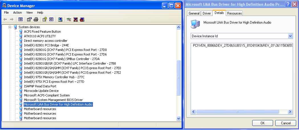

shintsuki Posted August 1, 2006 Share Posted August 1, 2006 I understand how you get the first value 0x10ec0882 > 0882 (The sound device), 10ec (Realtek) but what about the second one ? I have an ALC883 so the first value is 0x10ec0883 but I'm almost sure it's not the same value for the second one...but I don't know which device to search... Link to comment https://www.insanelymac.com/forum/topic/18642-how-to-alc882-sound/#findComment-153247 Share on other sites More sharing options...

Roninregain Posted August 8, 2006 Share Posted August 8, 2006 Well I finally fixed, upon closer inspection and further reading of different posts all scattered around the forum it turns out that would your enter under IOPCIPrimaryMatch, is entirely different depending on what type of motherboard you have. I had to enter the Device and Vendor ID of my HD Audio Bus Driver. In my case I have the DFI CFX3200 Lan Party motherboard, which uses Ati CFX3200 chipset, Under device manager> system devices should it be located. In my case it was called "Microsoft UAA Bus Driver For High Definition Audio" which resulted in 0x546110B9, I just added this one to the already existing one in the string (you never know) And also before you reboot it's wise to repair your permission after the kexcache -k command. from the terminal it's "diskutil repairpermissions /" without the brackets off course also instead of deleting extensions.kext in the first part I deleted extensions.kextcache. Read somewhere else your were suppose to do that everytime you edit kexts and also i couldn't see a file called extensions.kext. But that's basicly what i did to get my ALC 882 running. I hope it's helpfull to some of you. Link to comment https://www.insanelymac.com/forum/topic/18642-how-to-alc882-sound/#findComment-159197 Share on other sites More sharing options...
Vladimir Posted August 9, 2006 Share Posted August 9, 2006 I understand how you get the first value 0x10ec0882 > 0882 (The sound device), 10ec (Realtek) but what about the second one ? I have an ALC883 so the first value is 0x10ec0883 but I'm almost sure it's not the same value for the second one...but I don't know which device to search... Did you try this method to get ALC883 working? Link to comment https://www.insanelymac.com/forum/topic/18642-how-to-alc882-sound/#findComment-159269 Share on other sites More sharing options...
