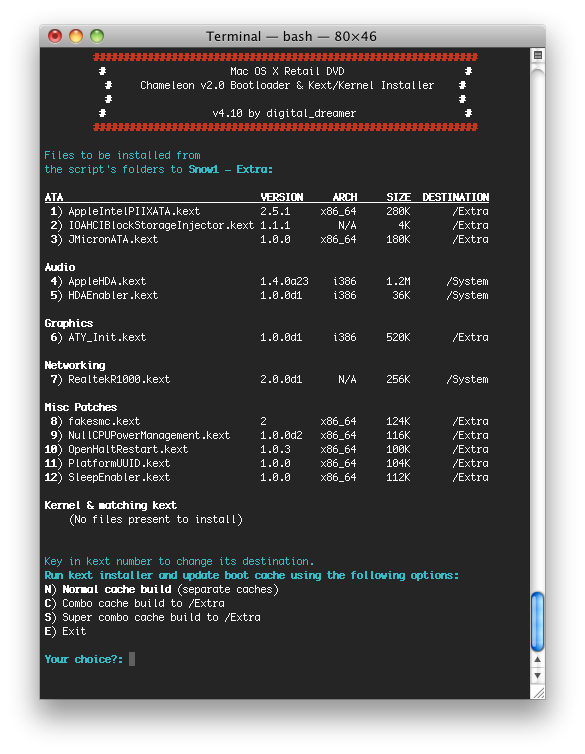

rappinkapc Posted November 11, 2009 Share Posted November 11, 2009 I have been experiencing a few hiccups in the upgrade to 10.6.2. My system seems to be a pretty standard one (UD5 w/ 9E BIOS, i7-920@stock, 9800GTX+). Everything was running great under 10.6.1... I am attaching a screen shot of the kext setup I had. No significant changes were made to the standard plists other than that I added a EFI string for LAN in order to get netflix streaming to work. I upgraded my second (basically identical) partition to 10.6.2, following the instructions above. When I first booted in, my graphics were not working properly - according to system profiler, I only had 32MB VRAM. I fixed this by moving ATY_init from Extra to System. The next problem was that sleep did not work properly in 10.6.2. I believe there are two versions of SleepEnabler.kext for 10.6.2 - one posted in this forum as well as other places, and one posted on netkas.org. Neither worked. With the one posted here, the screen did turn on after wake from sleep, and with the netkas SleepEnabler, I get KP after wake from sleep. Anyone have any advice or ideas? I would really like to have sleep working in 10.6.2 Link to comment https://www.insanelymac.com/forum/topic/185097-guide-scripted-yosemitemavericks-install-on-gigabyte-mobos/page/43/#findComment-1326833 Share on other sites More sharing options...

rappinkapc Posted November 11, 2009 Share Posted November 11, 2009 Your post is a bit confusing, do you have sleep working or not? I am asking because you stated that with the sleep enabler posted here, your screen did turn on after wake. Your kext setup looks fine to me. Please be more specific with regards to sleep so I can probably help you find a solution Sorry... There was a typo in my post, I meant that the screen does NOT turn on after wake. I have the same problem with, screen does not turn on after wake, but I am using the latest SleepEnabler from Netkas. No KP. Do you get KP if you try to plug in a USB device after the system wakes up? This happens to me every time with the netkas kext. Link to comment https://www.insanelymac.com/forum/topic/185097-guide-scripted-yosemitemavericks-install-on-gigabyte-mobos/page/43/#findComment-1327664 Share on other sites More sharing options...
