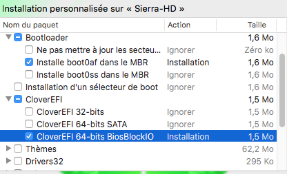

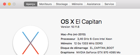

ptnyc Posted May 20, 2016 Share Posted May 20, 2016 After many hours of kernel panics trying to boot into El Capitan setup on the external hard drive, I bought, under a couple of people's recommendation a new video card, GTX970, which seemed to immediately help the installation process. I ended up switching to the TonyMac clover installer and got Clover loaded via a USB stick on to a new SSD. After a bunch of trial and error, my system is working well based on @ROBASEFR's config.plist and DDST.aml. I was even able to update via Software Update from 10.11.4 to 10.11.5 in App store. I'm using a MacPro 5,1 base definition. Also, I'm using a short list of kexts based on @ROBASEFR's screenshot from post 4597: AHCIPortInjector.kext FakeSMC.kect realtekALC.kext REaltekRTL8111.kext AppleIntelE100e.kext AtherosE2200Ethernet.kext Three big problems remain, however: 1) Cannot shutdown. Fix Shutdown and Halt Enabler are checked in config.plist, but don't seem to help. Sleep works, though it takes a couple of minutes for everything to turn off. And sometimes a drive on white south bridge SATA port will not remount after sleep. 2) My OWC PCIE Mercury Accelsior E2 SSD does not mount, even though I am booting from one "external" SSD drive attached to it and the other "external" 6G SATA connected SSD is mounting on desktop as well. The board shows on the System Hardware list, but the internal drive is not visible on desktop. I can see the drive in Disk Utility and repair it, but don't see drive on desktop, nor can I mount it. It seemed to mount with 10.11.4, but disappeared after 10.11.5 update. EDIT: After consulting with OWC, repaired with Disk Warrior and all is fine now. 3) Cannot boot with software RAID created by Disk Utility in 10.9.5. This is 2 SATA drives connected to the northbridge (blue) SATA ports on mobo. I need the data so can't reformat and recreate. May have to boot in 10.9.5, copy the data off and then try recreating in 10.11.5. But if anyone has a solution as is for 10.11.5, it would be greatly appreciated. EDIT: Had to remove drives and place in external SATA RAID box and they were readable via ESATA card. Too afraid to create another RAID on UD5 SATA ports. Thanks to all for the generous help on this forum. Link to comment https://www.insanelymac.com/forum/topic/185097-guide-scripted-yosemitemavericks-install-on-gigabyte-mobos/page/185/#findComment-2239334 Share on other sites More sharing options...

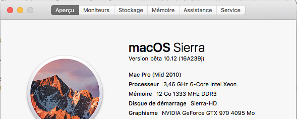

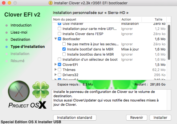

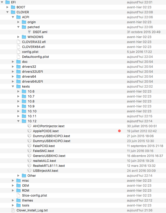

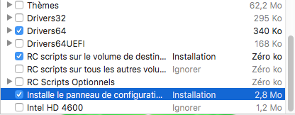

@ROBASEFR Posted June 18, 2016 Share Posted June 18, 2016 Who tries Sierra first for us UD5-users? I am currently out of the loop - still haven't gotten around to install El Capitan on my main drive. So I might just fast forward to Sierra Maybe @ROBASEFR goes first? Big Thanks! I took up the glove ! Up in macOS Sierra ! Yes Success here 1: Build the USB 8Mb install key with latest Clover v2.3 K special edition v3 ( r3661) Thanks Chriss1111 ! 2: Copied from 10.11 EFI my kexts files, config.plist and DSDT to the same place on USB/EFI/CLOVER ( changed the 10.11 config.plist only for my Nvidia card ( Boot arguments/nv_disable=1) and Boot default =USB "keyname" 3: ReBoot on USB key via F12 /Harddisks/my USB "keyname" 4: Once Install 10.12 Sierra up : Disk Utility and Format a sata HD "Sierra-HD" 5: Install 10.12 on "Sierra-HD" 6: reboot on 10.11 disk and relaunch Clover v2.3 K special edition v3 for Clover r3661 install on "Sierra-HD" 7: Mount "Sierra-HD" EFI 8: Copy from 10.11 /EFI my kext files in CLOVER/kexts/10.12;ACPI/patched/DSDT to EFI/CLOVER ;took the config.plist from USBkey/EFI and changed only BOOT/DefaultVolume 9: Installed extra software to 10.12 users/shared (ie: Nvidia WebDriver Updater 1.4;ESP mounter Pro;Cloverconfigurator 4.29) 10: ReBoot on Sierra-HD via F12 /Harddisks/HD name 11:Finish install and launch WebDriver Updater 1.4 and install beta drivers 12: Mount "Sierra-HD" EFI and change in config.plist Boot arguments/ nv_disable=1 to nvda_dvr=1 13.reboot and Voilà you'r in It took me all less then 2 hours. I did some tests and remember this is beta ! Geekbench and Cinebench R15 are lower, specialy on singlecore ! - Cloverconfigurator 4.29 crashed ! Sleep is ok Ethernet is ok USB is ok Audio ( not tested but I used Apple Audio patcher 1.3 beta from Mirone and Mickey1979 ) (I use Audio via USB ) Here are some captures: Stage :1 Final USB/ EFI: Stage 6: Test results: Final: One last precision: To launch an app for any developper you have to enter in Terminal: sudo spctl --master-disable Goodluck to all GA-EX58-UD5 owners .... 2 Link to comment https://www.insanelymac.com/forum/topic/185097-guide-scripted-yosemitemavericks-install-on-gigabyte-mobos/page/185/#findComment-2244204 Share on other sites More sharing options...

VirusX Posted June 22, 2016 Share Posted June 22, 2016 I am currently posting this from my Sierra install. Went fine so far - I took your config.plist. Quite mean: your standard language is french - I had to use my high school french to get through the installation haha I have trouble right now to install audio. There are so many options now with Toleda's patcher, one from Mirone and then there's clover patches, a patched HDA and DSDT patches. I don't even know where to start. And I also have my usual graphic card problems where my card boots into a white screen and dies. I have to boot with a monitor attached and plug it in after a while and hope that the computer is done booting to show me the log in window. The Bios update went fine too as far as I can see. Haven't tested all the options yet and my overclock is gone too ^^ oh well... Link to comment https://www.insanelymac.com/forum/topic/185097-guide-scripted-yosemitemavericks-install-on-gigabyte-mobos/page/185/#findComment-2245234 Share on other sites More sharing options...
@ROBASEFR Posted June 22, 2016 Share Posted June 22, 2016 I am currently posting this from my Sierra install. Went fine so far - I took your config.plist. Quite mean: your standard language is french - I had to use my high school french to get through the installation haha I have trouble right now to install audio. There are so many options now with Toleda's patcher, one from Mirone and then there's clover patches, a patched HDA and DSDT patches. I don't even know where to start. And I also have my usual graphic card problems where my card boots into a white screen and dies. I have to boot with a monitor attached and plug it in after a while and hope that the computer is done booting to show me the log in window. The Bios update went fine too as far as I can see. Haven't tested all the options yet and my overclock is gone too ^^ oh well... Ok. For audio: I think You should try Clover kext first For Overclock: In bios settings : MB Intelligent Tweaker (M.I.T.) -> Find the best equation for your Processor toggling with CPU Clock Ratio and x BCLK Frequency(Mhz) 1 Link to comment https://www.insanelymac.com/forum/topic/185097-guide-scripted-yosemitemavericks-install-on-gigabyte-mobos/page/185/#findComment-2245240 Share on other sites More sharing options...

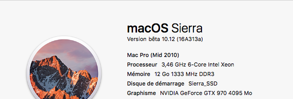

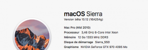

@ROBASEFR Posted July 9, 2016 Share Posted July 9, 2016 Sierra DP2 is ok now. with latest Clover r3601 and Nvidia WebDriver-367.05.10.05b07 Updated Cloverconfigurator 4.30.1 is working also ! 2 Link to comment https://www.insanelymac.com/forum/topic/185097-guide-scripted-yosemitemavericks-install-on-gigabyte-mobos/page/185/#findComment-2249833 Share on other sites More sharing options...

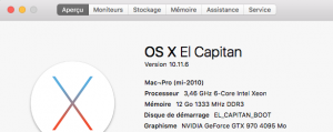

@ROBASEFR Posted July 20, 2016 Share Posted July 20, 2016 OSX 10.11.6 is Ok here with latest Nvidia webdriver manager 1.5 and Webdrivers version 346.03.15f01 346.03.15f02 Update: macOS10.12 beta 2 with latest Clover r3657 and Webdriver 367.05.10.05b07 2 Link to comment https://www.insanelymac.com/forum/topic/185097-guide-scripted-yosemitemavericks-install-on-gigabyte-mobos/page/185/#findComment-2255398 Share on other sites More sharing options...
jhrfc Posted August 19, 2016 Share Posted August 19, 2016 OSX 10.11.6 is Ok here with latest Nvidia webdriver manager 1.5 and Webdrivers version 346.03.15f01 346.03.15f02 Capture d'écran 2016-07-20 20.56.37.png Update: macOS10.12 beta 2 with latest Clover r3657 and Webdriver 367.05.10.05b07 Capture d’écran 2016-07-23 à 17.38.35.png Great thanks! Updated to 10.11.6 Jon Link to comment https://www.insanelymac.com/forum/topic/185097-guide-scripted-yosemitemavericks-install-on-gigabyte-mobos/page/185/#findComment-2267640 Share on other sites More sharing options...

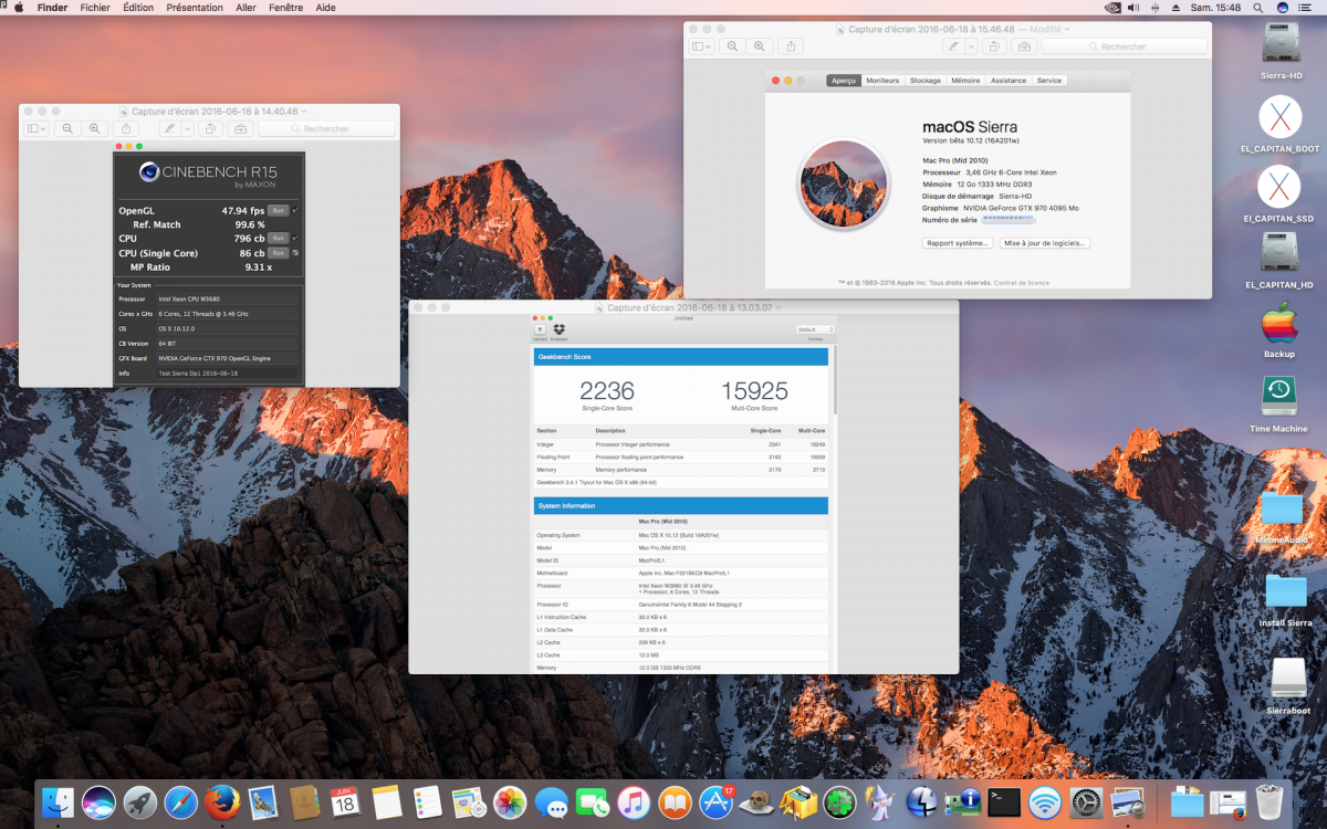

pkdesign Posted September 7, 2016 Share Posted September 7, 2016 Well I got Core i7-920 before i switched to Xeon W3680 6 core ( = Core i7-980x) Of coarse a Core i7-975 Extreme Edition is 4 core ! but you could push it to 4.5ghz with a good cooler ! Look to my Geekbench results in my signature and compare yours ... (I overclocked it not much (3.46Ghz)) Your type of Processor has nothing to do with type of machine ! Just don't modify anything in your SMBIOS (MacPro 5,1) Hmm, since I have my machine overclocked to 3.5Ghz already it seems unnecessary to upgrade my CPU to 975. I guess I could over clock that chip closer to 4Ghz but not sure I'd be gaining that much extra speed. Especially for the extra wattage that would be required to run the 975 overclocked. Link to comment https://www.insanelymac.com/forum/topic/185097-guide-scripted-yosemitemavericks-install-on-gigabyte-mobos/page/185/#findComment-2274894 Share on other sites More sharing options...
