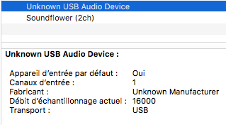

It seems the Logitech USB webcam (don't remember the model) microphone is not responding after resuming the system from sleep. I just found out this morning, the speaker is still functioning :(
Need more investigation on this.

Well I tried mine (logitech quickcam pro 9000 ) wich is on USB 3, and No problem here after sleep !

attachicon.gifCapture d'écran 2016-09-27 22.18.14.png attachicon.gifCapture d'écran 2016-09-27 22.24.22.png
Mine is Logitech HD Webcam 270, connected to a USB2 port.
Did you try it with Siri after resume from sleep?
I just tried and it works this time, so it is intermittent, I need to check some of the USB parameters in Clover which I saw you have it but I don't.
When it didn't work, the device is still listed in System Information and System Preferences, only it doesn't responding. I notice also there was a lag on System Preferences that time.
