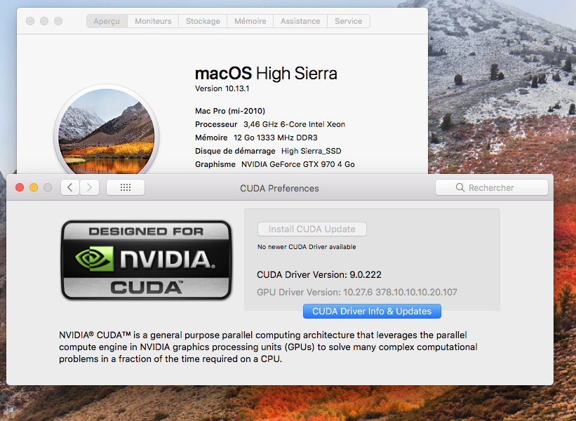

Succes update 10.13.1 on this old MOBO (2009) with Nvidia GTX 970
