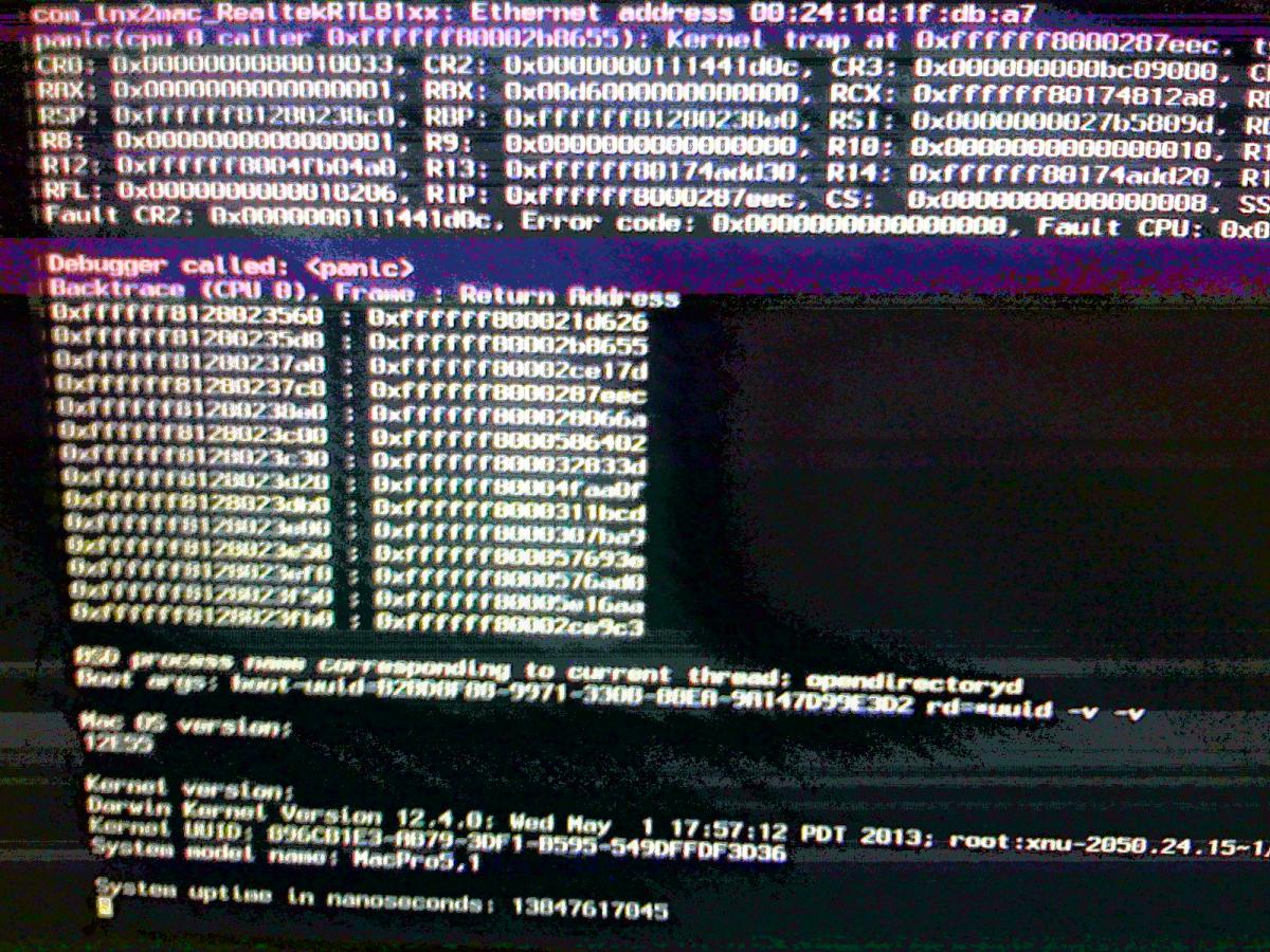

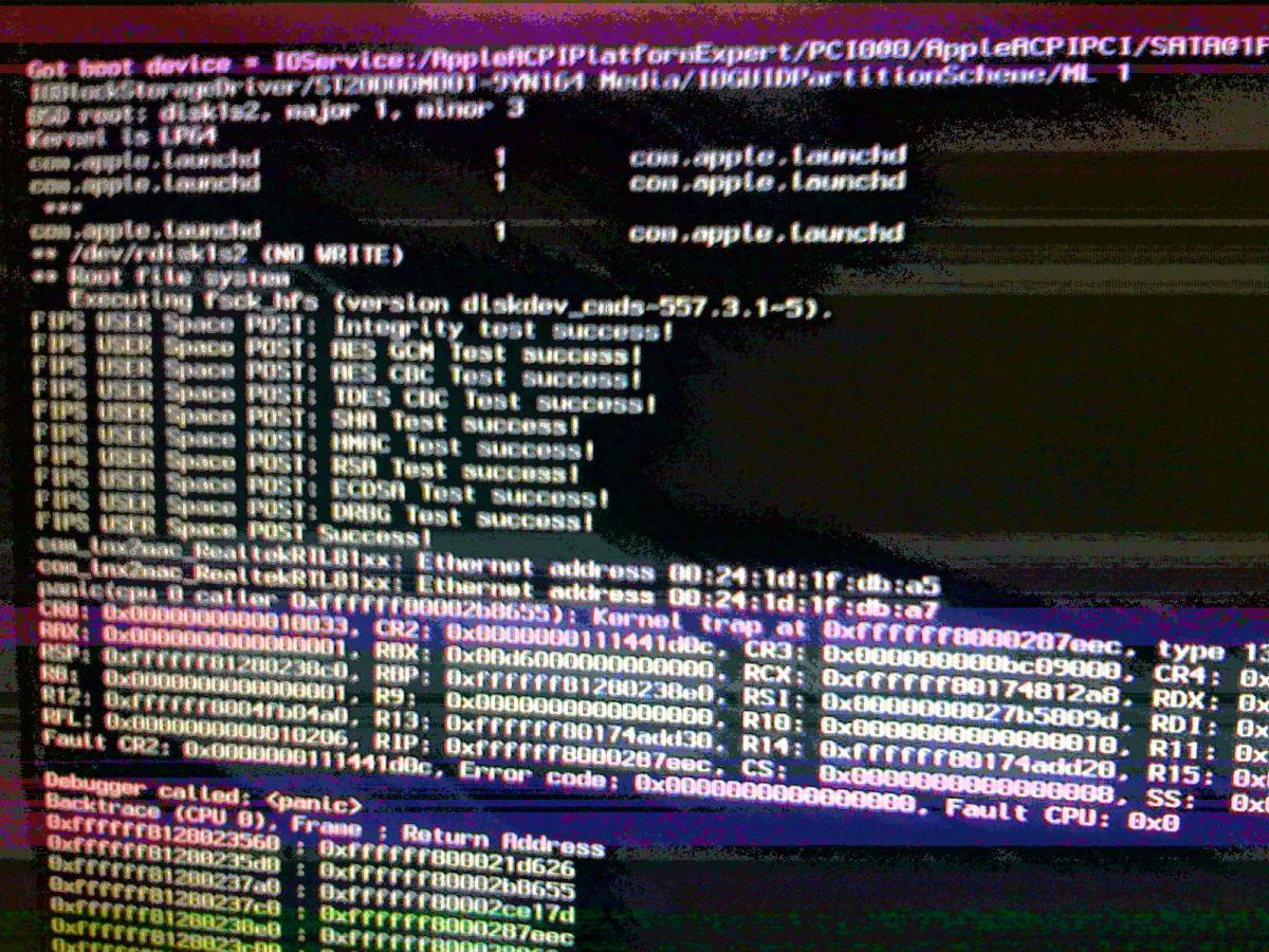

Hello folks,
I have a problem with my system.. first of all i have the following specifications :
Motherboard: GA-EX58-UD5
Video : XFX 512mb
Intel i7-920
10GB memory ram corsair 1600Mhz  ( 3 x 2GB  and 1 x 4GB)
2 x Seagate 2TB and 1 x Western Digital 650 GB @ 7200 rpm
OSX 10.8.4 ( Mountain Lion )
Everything was working fine under BIOS F12 but one day my system recognized only 4GB of ram, it didn't recognized all my ram under F12 bios ( Yes i did try to change the slots and to leave only the 6gb ram but bios recognize only 4GB.) When i am trying to update my BIOS to F13 it recognizes all the ram.. but now the computer stuck at the following point that i am showing in the picture...  ( Yes i changed the default bios settings after updating to F13, and use AHCI etc..)
 Sorry for the bad quality of photos...

@The K man: I'm not an expert and can't read anything from your screenshots. But I once had troubles with my DSDT after a BIOS update / had to update my BIOS first in order to use a specific DSDT. Maybe you need a different one now?
