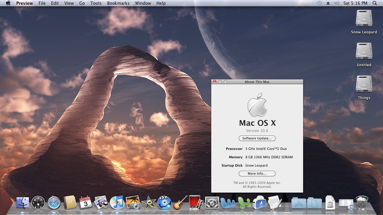

First off I want to thank everyone that helped! Doom42 for this wonderful guide, crashalert for posting his DSDT file and Insanely Mac as a whole!!!
Used Dooms Guide:
http://www.insanelymac.com/forum/index.php?showtopic=181903
**NOTE: REMEMBER TO CHANGE YOUR SMBIOS FILE, UUID'S, AND EFI STRINGS FOR YOUR OWN HARDWARE!
System:
Intel Core 2 Duo E8400 3GHz
Gigabyte EP45-UD3P
8GB DDR2 RAM
2x 320GB HD
eVGA nVidia GeForce 9400 GT 1GB
Install Method: 2 Hard Drives. 1 blank, 1 with leo
Doom's guide. SL installed within a Leo setup, via image file.
My special steps to Doom42's guide.
Used 3 outs 2 ins audio kext from the SL pack on doom42's guide to get my digital working. the green legacy kext. (ALC889A)
Used a DSDT.aml file posted by crashalert in this forum for this motherboard.
(Tried to manually create a dsdt file but i kept getting errors)
**changed UUID's, EFI strings for video card, and SMBIOS for MY HARDWARE!
(COPIED VIDEO CARD EFI STRINGS DIRECTLY FROM MY LEO INSTALL, NO PROGRAM NEEDED, SIMPLE COPY AND PASTE)
after install, and modifications to the new drive
first boot with -v -x32.
went through setup quickly, after intro video, to get to spot light before the panic.... too late, still panic!
2nd reboot, -v -x32, setup was done, went directly to desktop, got to spotlight and hid my drives under privacy.
still got another panic.
3rd reboot -v -x32, went back to spotlight and took the privacy off my drives and typed a word in the search box on the upper right hand corner of the spotlight window to index my drives... NO PANIC.
4th reboot. Normal boot, no boot flags. STABLE NO PANICS!!!! UP FOR ALMOST 12 hours. did some updates, installed all my programs. everything seems stable! SL is flying!!! xbench looks good, everything seems to be in working order.
Once again. Thank everyone for all the hard work! Hope this helps someone!

I just wanted to say thanks lifehacker everything went smooth the only problems i have is my hdd's don't show up on my desktop, cd/dvd drive is not recognized at all and my graphics card won't lett me get qe/ci enabled but other than that install went great the easiest one ever....
hackintosh specs are:
motherboard ep45 ud3p
cpu: q8400 quad core 2.66 ghz
vidcard gts 250 512mb
hdd 2 750g western digital
cd/dvd memorex
mem 2x2 gig patriot 800mhz
oh and i don't know how to oc any help would be fantastic thanks

I believe you can add your HD's to the desktop by going in the finder preferences and checking the box that says something to the effect of "show hard drives on desktop"
Also, for your gfx card, you might want to look into either adding an EFI string to your com.apple.boot.plist or using the GraphicsEnabler in the new Chameleon (I'm using it and it works great). Since your card is different from the one in the guide you followed to install my guess would be that's why you don't have qe/ci.
