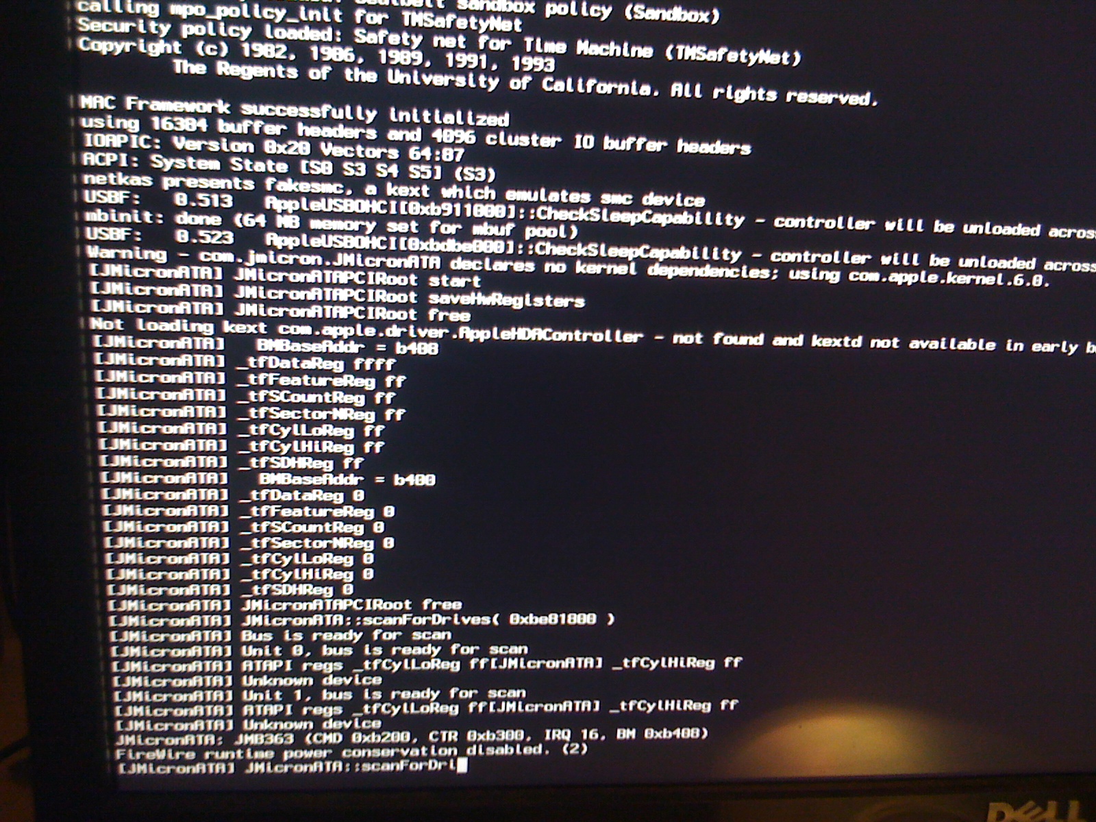

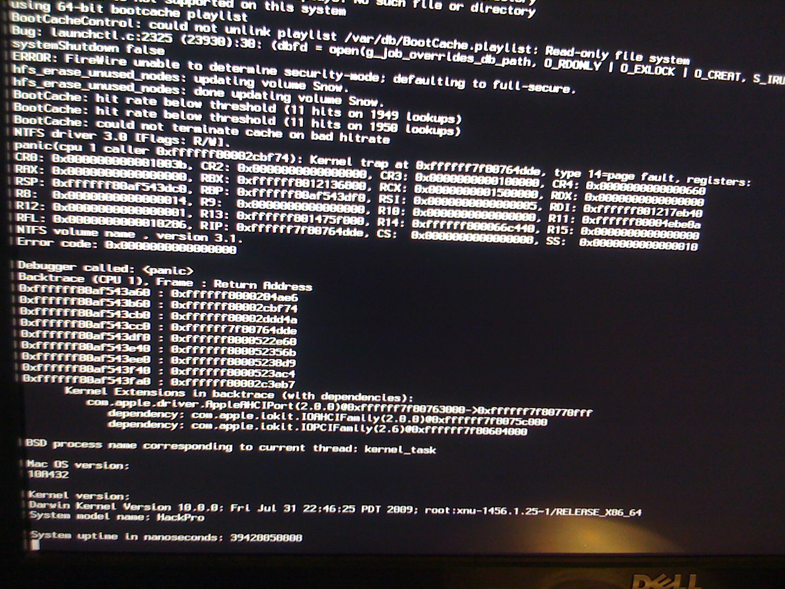

leglez Posted September 11, 2009 Share Posted September 11, 2009 Can someone help me. I set everything up just like in the first post. Only thing I did differently was add an EFI string for my 3870. Whenever I boot I with -v arch=i386 it stops loading at JMicron ATA: ScanForDri Not sure what that means. If I boot with just -v it stops at System Uptime in Nanoseconds. Any ideas as to what I am doing wrong? Link to comment Share on other sites More sharing options...
scho Posted September 11, 2009 Share Posted September 11, 2009 Can someone help me. I set everything up just like in the first post. Only thing I did differently was add an EFI string for my 3870. Whenever I boot I with -v arch=i386 it stops loading at JMicron ATA: ScanForDri Not sure what that means. If I boot with just -v it stops at System Uptime in Nanoseconds. Any ideas as to what I am doing wrong? You could try bypassing the JMicron's altogether by only using the non-purple SATA ports and disabling the front SATA's (i think this is in the bios). Also, I got my 4870 to work by using the evoenabler method without any device_id/EFI strings (i deleted the one that came in this pack in com.apple.boot.plist) Here's my reference for my 4870: http://www.insanelymac.com/forum/index.php?showtopic=183064 Good luck Link to comment Share on other sites More sharing options...

leglez Posted September 11, 2009 Share Posted September 11, 2009 You could try bypassing the JMicron's altogether by only using the non-purple SATA ports and disabling the front SATA's (i think this is in the bios). Also, I got my 4870 to work by using the evoenabler method without any device_id/EFI strings (i deleted the one that came in this pack in com.apple.boot.plist) Here's my reference for my 4870: http://www.insanelymac.com/forum/index.php?showtopic=183064 Good luck Dang I'm using most of my SATA Ports and can't really disable most of them. I have 4 hard drives and a DVD drive. Any other ideas? Link to comment Share on other sites More sharing options...
scho Posted September 11, 2009 Share Posted September 11, 2009 Dang I'm using most of my SATA Ports and can't really disable most of them. I have 4 hard drives and a DVD drive. Any other ideas? That's only 5. I believe the JMicron's are the purple ones and the 6 orange ones are on another controller. Link to comment Share on other sites More sharing options...
leglez Posted September 11, 2009 Share Posted September 11, 2009 That's only 5. I believe the JMicron's are the purple ones and the 6 orange ones are on another controller. You are right. I have done some searching through the bios and can't find anything about disabling JMicron. Any idea where it is? Link to comment Share on other sites More sharing options...
