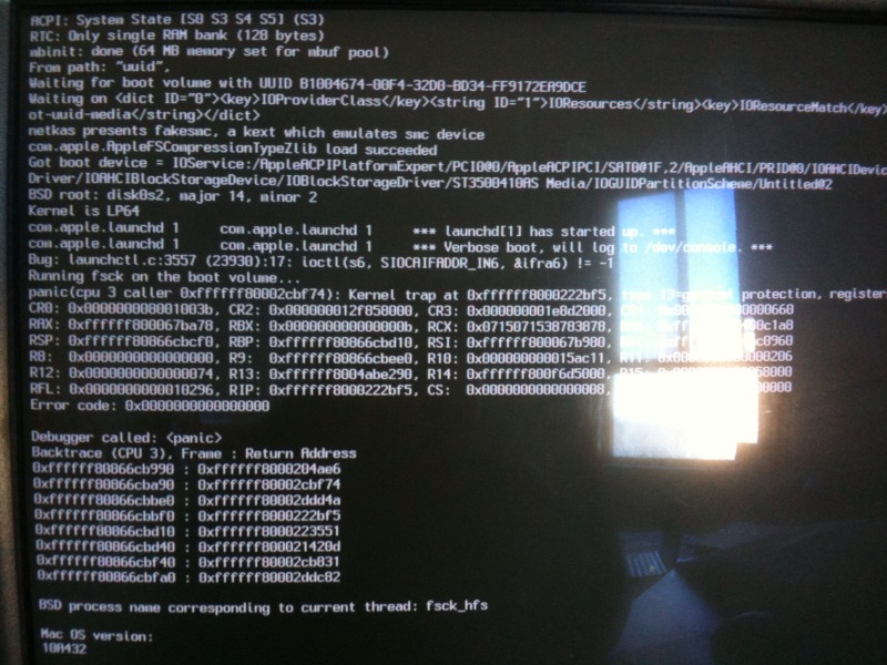

hackedintosh Posted September 9, 2009 Share Posted September 9, 2009 Just wanted to post my success story.. To anyone experiencing never ending kernel panics: the way I fixed it was by deleting the dsdt.aml supplied in this post, its no good even with same hardware. You must go into bios, disable HT and enable 1 core, and at boot type "cpus=1 -x -v" then use dsdt patcher gui to make yourself a dsdt.aml I am running successfully: Asus P6t Deluxe V2 Core i7 920 @ default speeds 12 GB OCZ 1600 ram nvidia gtx 285 Everything is working great except 1) I cant put it to sleep, still working on that.. fans just keep running 2) using Voodoo audio, surround sound works however i only get mono signal in headphones connected to speakers 3) stuck in IDE mode Thanks to everyone making this work Link to comment https://www.insanelymac.com/forum/topic/182978-how-to-guide-snow-leopard-retail-106-on-asus-p6t-deluxe-v2/page/2/#findComment-1258231 Share on other sites More sharing options...

daboat2xblx Posted September 9, 2009 Share Posted September 9, 2009 I'm stuck at single core w/o HT. When I boot up with all 4 enabled, I get the Still Waiting for Root Device. I am using my own DSDT.aml built with the patcher provided. I also can only boot when I add -v to the options. Suggestions? Link to comment https://www.insanelymac.com/forum/topic/182978-how-to-guide-snow-leopard-retail-106-on-asus-p6t-deluxe-v2/page/2/#findComment-1259344 Share on other sites More sharing options...
Dojomann Posted September 10, 2009 Share Posted September 10, 2009 What board do you have? Did you remember to remove the "alias" bits from the dsdt.dsl and then recompile it? Otherwise more than one core won't work. Link to comment https://www.insanelymac.com/forum/topic/182978-how-to-guide-snow-leopard-retail-106-on-asus-p6t-deluxe-v2/page/2/#findComment-1259406 Share on other sites More sharing options...
daboat2xblx Posted September 10, 2009 Share Posted September 10, 2009 What board do you have? Did you remember to remove the "alias" bits from the dsdt.dsl and then recompile it? Otherwise more than one core won't work. I have the Asus P6T Deluxe V2, I looked at the dsdt.dsl after the GUI ran and it looked like it automatically did the removal and recompile. Am I wrong? Link to comment https://www.insanelymac.com/forum/topic/182978-how-to-guide-snow-leopard-retail-106-on-asus-p6t-deluxe-v2/page/2/#findComment-1259410 Share on other sites More sharing options...
Dojomann Posted September 10, 2009 Share Posted September 10, 2009 If it looks like this: Scope (_PR) { Processor (P001, 0x01, 0x00000810, 0x06) {} Alias (P001, CPU1) Processor (P002, 0x02, 0x00000000, 0x00) {} Alias (P002, CPU2) Processor (P003, 0x03, 0x00000000, 0x00) {} Alias (P003, CPU3) Processor (P004, 0x04, 0x00000000, 0x00) {} Alias (P004, CPU4) Processor (P005, 0x05, 0x00000000, 0x00) {} Alias (P005, CPU5) Processor (P006, 0x06, 0x00000000, 0x00) {} Alias (P006, CPU6) Processor (P007, 0x07, 0x00000000, 0x00) {} Alias (P007, CPU7) Processor (P008, 0x08, 0x00000000, 0x00) {} Alias (P008, CPU8) Processor (P009, 0x09, 0x00000000, 0x00) {} Alias (P009, CPU9) Processor (P010, 0x0A, 0x00000000, 0x00) {} Processor (P011, 0x0B, 0x00000000, 0x00) {} Processor (P012, 0x0C, 0x00000000, 0x00) {} Processor (P013, 0x0D, 0x00000000, 0x00) {} Processor (P014, 0x0E, 0x00000000, 0x00) {} Processor (P015, 0x0F, 0x00000000, 0x00) {} Processor (P016, 0x10, 0x00000000, 0x00) {} } it isn't patched. if it looks like this Scope (_PR) { Processor (P001, 0x01, 0x00000810, 0x06) {} Processor (P002, 0x02, 0x00000000, 0x00) {} Processor (P003, 0x03, 0x00000000, 0x00) {} Processor (P004, 0x04, 0x00000000, 0x00) {} Processor (P005, 0x05, 0x00000000, 0x00) {} Processor (P006, 0x06, 0x00000000, 0x00) {} Processor (P007, 0x07, 0x00000000, 0x00) {} Processor (P008, 0x08, 0x00000000, 0x00) {} Processor (P009, 0x09, 0x00000000, 0x00) {} Processor (P010, 0x0A, 0x00000000, 0x00) {} Processor (P011, 0x0B, 0x00000000, 0x00) {} Processor (P012, 0x0C, 0x00000000, 0x00) {} Processor (P013, 0x0D, 0x00000000, 0x00) {} Processor (P014, 0x0E, 0x00000000, 0x00) {} Processor (P015, 0x0F, 0x00000000, 0x00) {} Processor (P016, 0x10, 0x00000000, 0x00) {} } it is. (just to clarify, the 2nd set is what you want it to look like) Anyhows I posted my DSDT.aml a page ago and i have the same board... so if nothing else you might want to give that one a shot. Link to comment https://www.insanelymac.com/forum/topic/182978-how-to-guide-snow-leopard-retail-106-on-asus-p6t-deluxe-v2/page/2/#findComment-1259424 Share on other sites More sharing options...
daboat2xblx Posted September 10, 2009 Share Posted September 10, 2009 Your dsdt.aml combined with switching my SATA ports seems to have gotten that up, but only with the -v flag set. It won't work otherwise. Ideas? Link to comment https://www.insanelymac.com/forum/topic/182978-how-to-guide-snow-leopard-retail-106-on-asus-p6t-deluxe-v2/page/2/#findComment-1259536 Share on other sites More sharing options...
