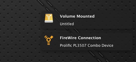

dummy15 Posted October 10, 2009 Share Posted October 10, 2009 Hi all, as I was receiving couple of the PM's with questions I thought to share the way I installed Snow Leo on my Asus P6T deluxe. My system specs: - ASUS P6T Deluxe - core i7 920 @2.66Ghz - 12 GB Kingston value ram 1066MHz (6*2GB) - 3 SATA hard drives Samsung HD642JJ (3*640GB) - 1 SATA DVD burner Pioneer 216D - 1 IDE DVD-RAM burner Panasonic SW-9576 (Mat{censored}a, cartridge slot) ==> not working in 64-bit mode - Asus 138g wireless card (Broadcom 4318) - Powercolor ATI Radeon 4850 So far only IDE DVD drive is not working. The external Firewire hard drive is working fine, however I can not boot from it (I can not choose it in BIOS as boot device, as well Chameleon does not see it). The attached guide is based on the files from the post #123. No other changes to SnowLeo were done apart of the changes in the guide. Snow_Leo_installation_on_Asus_P6T_Deluxe.rtf Link to comment https://www.insanelymac.com/forum/topic/182978-how-to-guide-snow-leopard-retail-106-on-asus-p6t-deluxe-v2/page/7/#findComment-1295357 Share on other sites More sharing options...
dummy15 Posted October 10, 2009 Share Posted October 10, 2009 Checked my firewire devices and can confirm that all are working fine: 1. external firewire harddrive 2. Panasonic NV GS-150 MiniDV camcorder Link to comment https://www.insanelymac.com/forum/topic/182978-how-to-guide-snow-leopard-retail-106-on-asus-p6t-deluxe-v2/page/7/#findComment-1295590 Share on other sites More sharing options...
