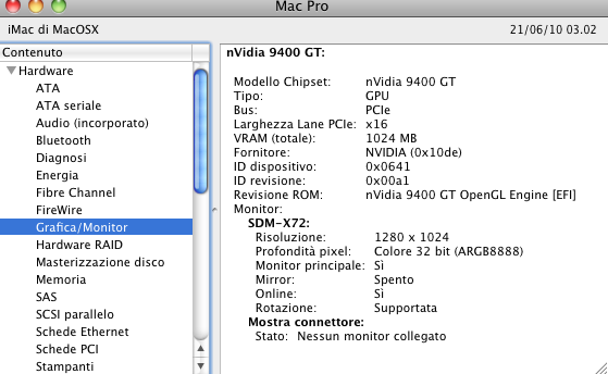

> With GraphicsEnabler by default my VGA is recognized correctly as GeForce 9400 GT (0x064110de) but it not work properly. Apparently VGA is accelerated but i can't see QE/CI Supported in System Information and occasionally crashes.
> Removing GraphicsEnabler and copy NVENABLER64 in /Extra/Extensions + Kexts Utility to repair permissions: my VGA isn't recognized (Unknow nVidia Card), Apparently VGA is accelerated but i can't see QE/CI Supported in System Information and occasionally crashes.
> Then i tried an EFI String removing NVENABLER64 and GraphicsEnabler: apparently VGA is accelerated and don't crash but i can't see QE/CI Supported in System Information.

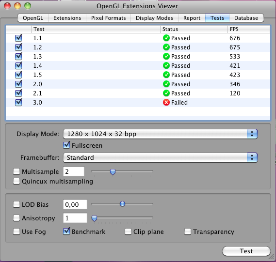

So i found some ways you can check to see if your card is fully accelerated.
  1. Open Front Row. If it opens and is functional, QE/CI are enabled.
  2. Open Dashboard and add a widget. If you see cool ripples, QE/CI are enabled.
  3. Open Chess and play. If you can make more of a move, QE/CI are enabled.
It's right? Your Gigabyte's Theme is cool but how i can start -x -v -f ?

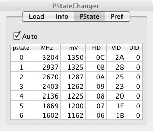

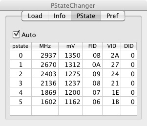

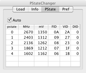

Hi Ridgeline,
Could you make another DSDT? This is a QX6700. I'm using an 11x multiplier, since this CPU is unlocked.
I don't understand why it's not working, here's the DSDT I used:
 Processor (CPU0, 0x00, 0x00000410, 0x06)
           Method (_PSS, 0, NotSerialized)
               Return (Package (0x[color="#006400"]06[/color])
                   Package (0x06)
                       Zero,
                       Zero,
                       0x10,
                       0x10,
                       0x[color="#FF0000"]0B2A[/color],
                       Zero
                   Package (0x06)
                       Zero,
                       Zero,
                       0x10,
                       0x10,
                       0x[color="#FF0000"]0A27[/color],
                       One
                   Package (0x06)
                       Zero,
                       Zero,
                       0x10,
                       0x10,
                       0x[color="#FF0000"]0924[/color],
                       0x02
                   Package (0x06)
                       Zero,
                       Zero,
                       0x10,
                       0x10,
                       0x[color="#FF0000"]0821[/color],
                       0x03
                   Package (0x06)
                       Zero,
                       Zero,
                       0x10,
                       0x10,
                       0x[color="#FF0000"]071E[/color],
                       0x04
                   Package (0x06)
                       Zero,
                       Zero,
                       0x10,
                       0x10,
                       0x[color="#FF0000"]061B[/color],
                       0x05
I tried compiling with DSDTSE & iASLMe. When I say it doesn't work, it means I have a 'popping' sound when playing music or movies. When the DSDT it correct, I don't have that sound. Right now voodoopstate & a hidden/dockless PStateChanger is getting me everything I need, but it's the principle of the thing!
I guess you have the magic touch :(
QX6700, 11x:
And if you wanted to compile more DSDTs:
QX6700, 10x multiplier:
QX6700, 12x multiplier:
