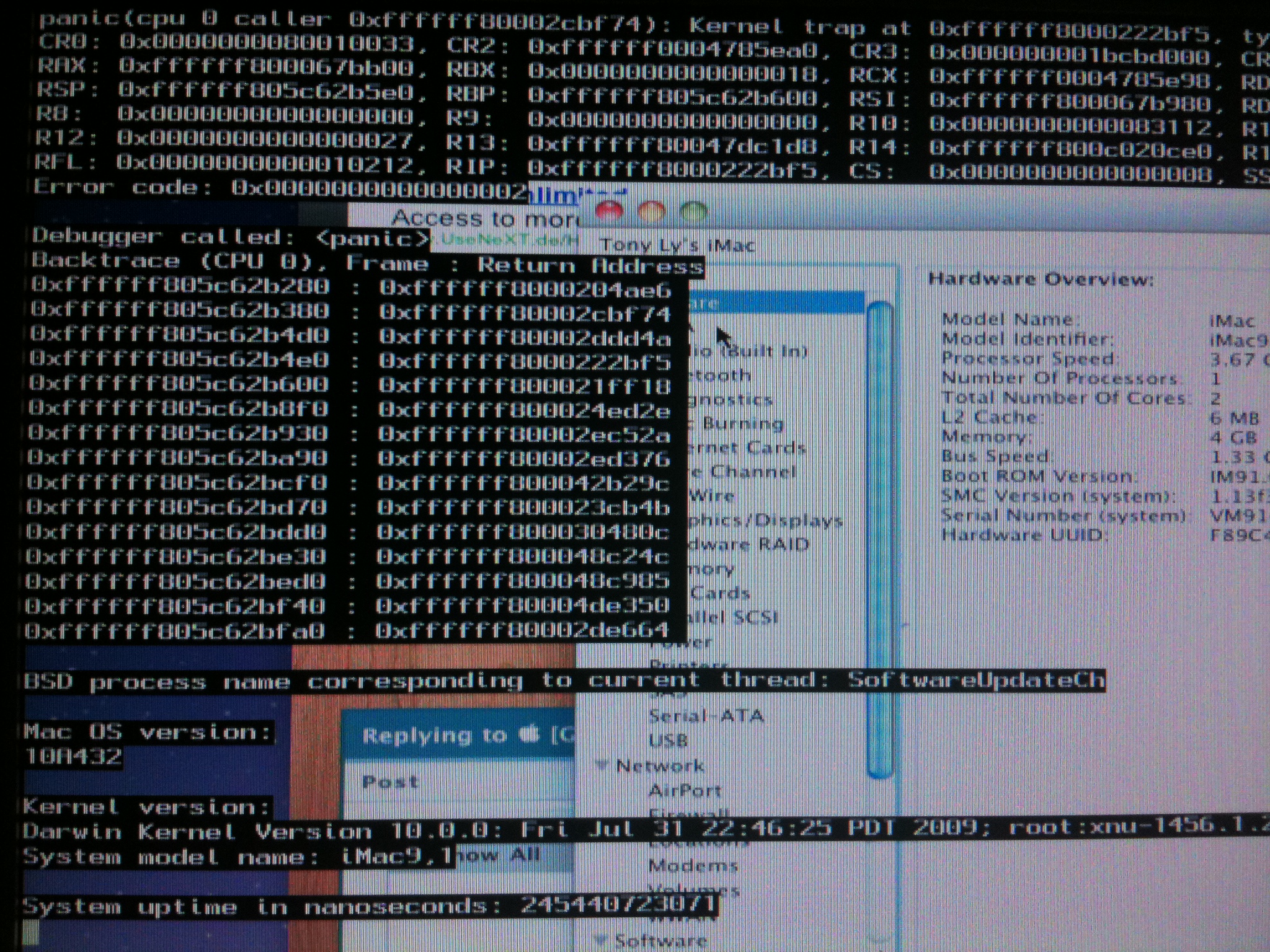

2ndx Posted September 12, 2009 Share Posted September 12, 2009 Hi Ricola, i follow your guide but still having this problem... see pic... i tried installing it few times and even boot with -v arch=x86_32... on some install when i boot with -x i can get through... do you have any ideas... my computer build: Abit IP35 Pro Intel Core 2 Duo E7600 Wolfdale 3.06GHz Memory 2 x 2GB DDR2 EVGA 7950 GT 512mb dual dvi 2 seagate 300gb hd sata Link to comment https://www.insanelymac.com/forum/topic/182123-%EF%A3%BF-guide-snow-on-abit-ip35-pro-ich9-r/page/8/#findComment-1263458 Share on other sites More sharing options...

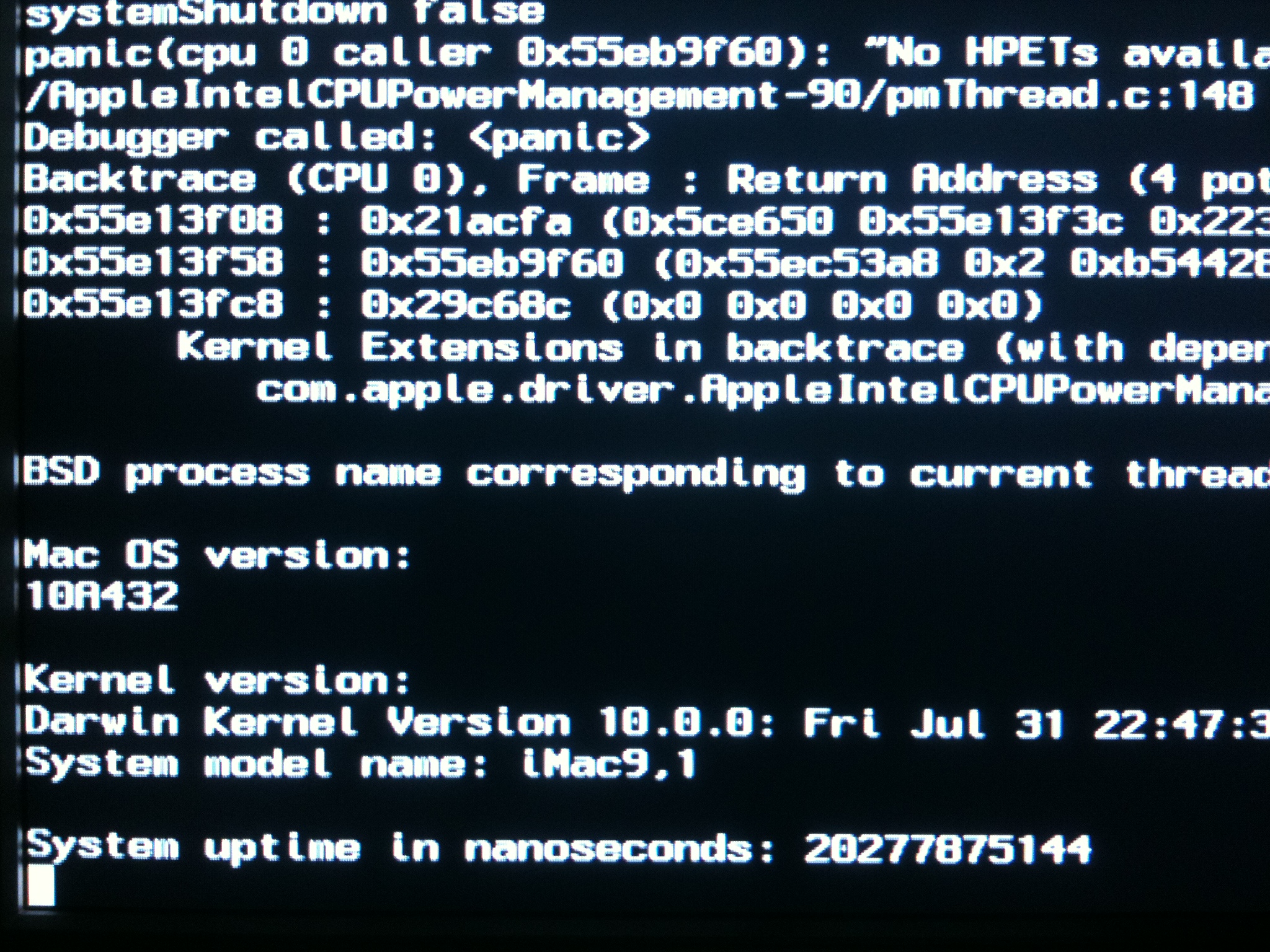

2ndx Posted September 12, 2009 Share Posted September 12, 2009 Hi Ricola, I was able to boot up in safe mode again... and as i was about to post a reply i got a kp... see pic... thanks in advance especially this is a weekend too... 2ndx Link to comment https://www.insanelymac.com/forum/topic/182123-%EF%A3%BF-guide-snow-on-abit-ip35-pro-ich9-r/page/8/#findComment-1263562 Share on other sites More sharing options...
Arial Posted September 12, 2009 Share Posted September 12, 2009 Hi Ricola, i follow your guide but still having this problem... see pic... i tried installing it few times and even boot with -v arch=x86_32... on some install when i boot with -x i can get through... do you have any ideas... my computer build: Abit IP35 Pro Intel Core 2 Duo E7600 Wolfdale 3.06GHz Memory 2 x 2GB DDR2 EVGA 7950 GT 512mb dual dvi 2 seagate 300gb hd sata open terminal: diskutil list and post here to see your partitions order. what if: - using GPT (not MBR) - and there is Leo on first/top partition - and Leo using Chameleon then: - move Leo to other partition and install SL on the top partition - or install Boot Think 2.3 on Leo and put SL extra kext in there (/Darwin/System/LibrarySL/Extensions) Link to comment https://www.insanelymac.com/forum/topic/182123-%EF%A3%BF-guide-snow-on-abit-ip35-pro-ich9-r/page/8/#findComment-1263574 Share on other sites More sharing options...

ricola Posted September 13, 2009 Author Share Posted September 13, 2009 2ndx - Run Kext Utility and BSD.pkg from your snow.dmg or DVD under System/Installation/Packages/ -ricola Link to comment https://www.insanelymac.com/forum/topic/182123-%EF%A3%BF-guide-snow-on-abit-ip35-pro-ich9-r/page/8/#findComment-1263760 Share on other sites More sharing options...
2ndx Posted September 13, 2009 Share Posted September 13, 2009 So ricola, should I do this while in 10.5 or when I boot up in 10.6 I'm safe mode? Thanks, 2ndx Link to comment https://www.insanelymac.com/forum/topic/182123-%EF%A3%BF-guide-snow-on-abit-ip35-pro-ich9-r/page/8/#findComment-1263783 Share on other sites More sharing options...
ricola Posted September 13, 2009 Author Share Posted September 13, 2009 So ricola, should I do this while in 10.5 or when I boot up in 10.6 I'm safe mode? Thanks, 2ndx 10.6 safe mode Link to comment https://www.insanelymac.com/forum/topic/182123-%EF%A3%BF-guide-snow-on-abit-ip35-pro-ich9-r/page/8/#findComment-1263803 Share on other sites More sharing options...

Arial Posted September 13, 2009 Share Posted September 13, 2009 Hi Arial Macintosh:~ 2ndx$ diskutil list 2009-09-12 14:56:01.384 diskutil[170:10b] _CFGetHostUUIDString: unable to determine UUID for host. Error: 35 2009-09-12 14:56:01.403 DiskManagementTool[171:10b] _CFGetHostUUIDString: unable to determine UUID for host. Error: 35 /dev/disk0 #: TYPE NAME SIZE IDENTIFIER 0: GUID_partition_scheme *279.5 Gi disk0 1: EFI 200.0 Mi disk0s1 2: Apple_HFS leopard 10.5 279.1 Gi disk0s2 /dev/disk1 #: TYPE NAME SIZE IDENTIFIER 0: GUID_partition_scheme *279.5 Gi disk1 1: EFI 200.0 Mi disk1s1 2: Apple_HFS snow 279.1 Gi disk1s2 /dev/disk2 #: TYPE NAME SIZE IDENTIFIER 0: CD_partition_scheme *46.2 Mi disk2 1: CD_ROM_Mode_1 ISOEN 40.2 Mi disk2s0 Macintosh:~ 2ndx$ here is my partition order... thanks thanks. when boot to SL, make disk1 (SL) as first boot sequence in BIOS. just for sure Link to comment https://www.insanelymac.com/forum/topic/182123-%EF%A3%BF-guide-snow-on-abit-ip35-pro-ich9-r/page/8/#findComment-1264057 Share on other sites More sharing options...
2ndx Posted September 13, 2009 Share Posted September 13, 2009 Hi -arail i already have my snow drive setup to boot up first in my bios... Any other ideas? -ricola when i boot up in safe mode and run the kext utility it's runs fine... But when I open up the bsd.pkg it gives me a KP... When I try to boot it normally it goes all the way to the aqua screen where the mouse comes up but it's just stays there with no mouse... Thanks 2ndx Link to comment https://www.insanelymac.com/forum/topic/182123-%EF%A3%BF-guide-snow-on-abit-ip35-pro-ich9-r/page/8/#findComment-1264727 Share on other sites More sharing options...
ricola Posted September 13, 2009 Author Share Posted September 13, 2009 -ricolawhen i boot up in safe mode and run the kext utility it's runs fine... But when I open up the bsd.pkg it gives me a KP... When I try to boot it normally it goes all the way to the aqua screen where the mouse comes up but it's just stays there with no mouse... Thanks 2ndx Try this : boot with -x -v Mount your snow.dmd/DVD, Terminal : sudo -s chown 0:0 / open /Volumes/Mac\ OS\ X\ Install\ DVD/System/Installation/Packages/BSD.pkg diskutil repairpermissions / If still can't install BSD.pkg ... try to install it from leopard (target snow) -ricola Link to comment https://www.insanelymac.com/forum/topic/182123-%EF%A3%BF-guide-snow-on-abit-ip35-pro-ich9-r/page/8/#findComment-1264762 Share on other sites More sharing options...
