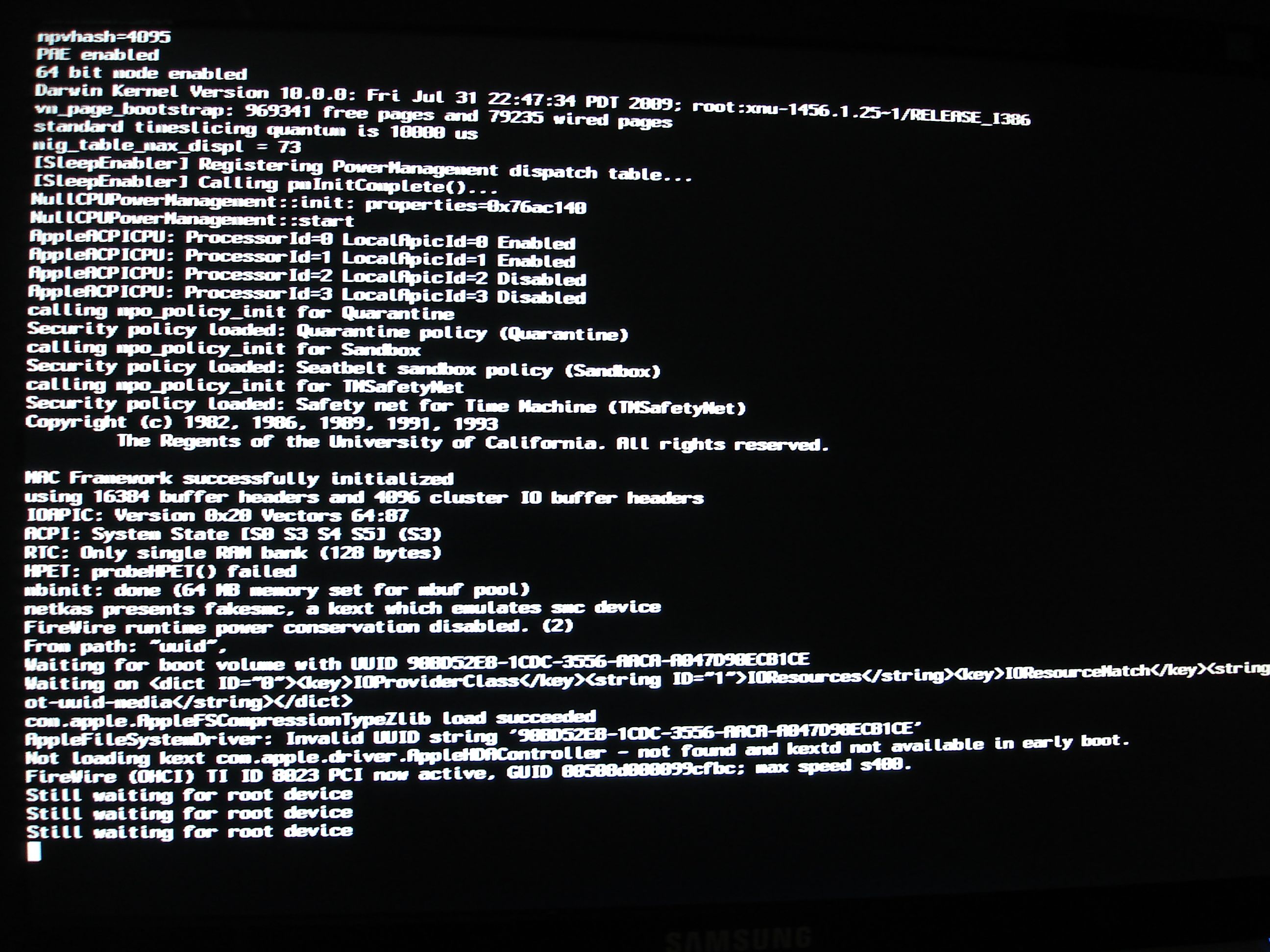

Now I get this error on my Desktop PC (SATA = AHCI) via eSATA, running -v -f -x32 (attached foto)
So I guess this UUID it is searching for must be in one of your files, because the uuid of the partition I installed SL is:
508B9686-CDE1-3A43-BE3F-3BB028F764C4
and this uuid is in the .plist files u mentioned.
Please help me ! ;)
My last attampt was to make all like you said in guide, with the exception to delete boot.plist, change the uuid in smbios.plist and in info.plist in the platform.kext. making a new .mkext, ...
Why would you delete Boot.plist? insert 508B9686-CDE1-3A43-BE3F-3BB028F764C4 to com.apple.Boot.plist and place it to /Extra folder.

I tried without it because I read it wasn't needed, somewhere in this thread. Also I tried it with the boot.plist before.
Sorry for me stupidness, this wrong uuid came from another partitionen where I tried it in a diffrent way, its now formated, and now it is waiting for the right UUID, but there is still the error
"Still waiting for root device"
I guess you are using External Drive via eSata port at computer back panel. Not sure this gonna help but worth to try :

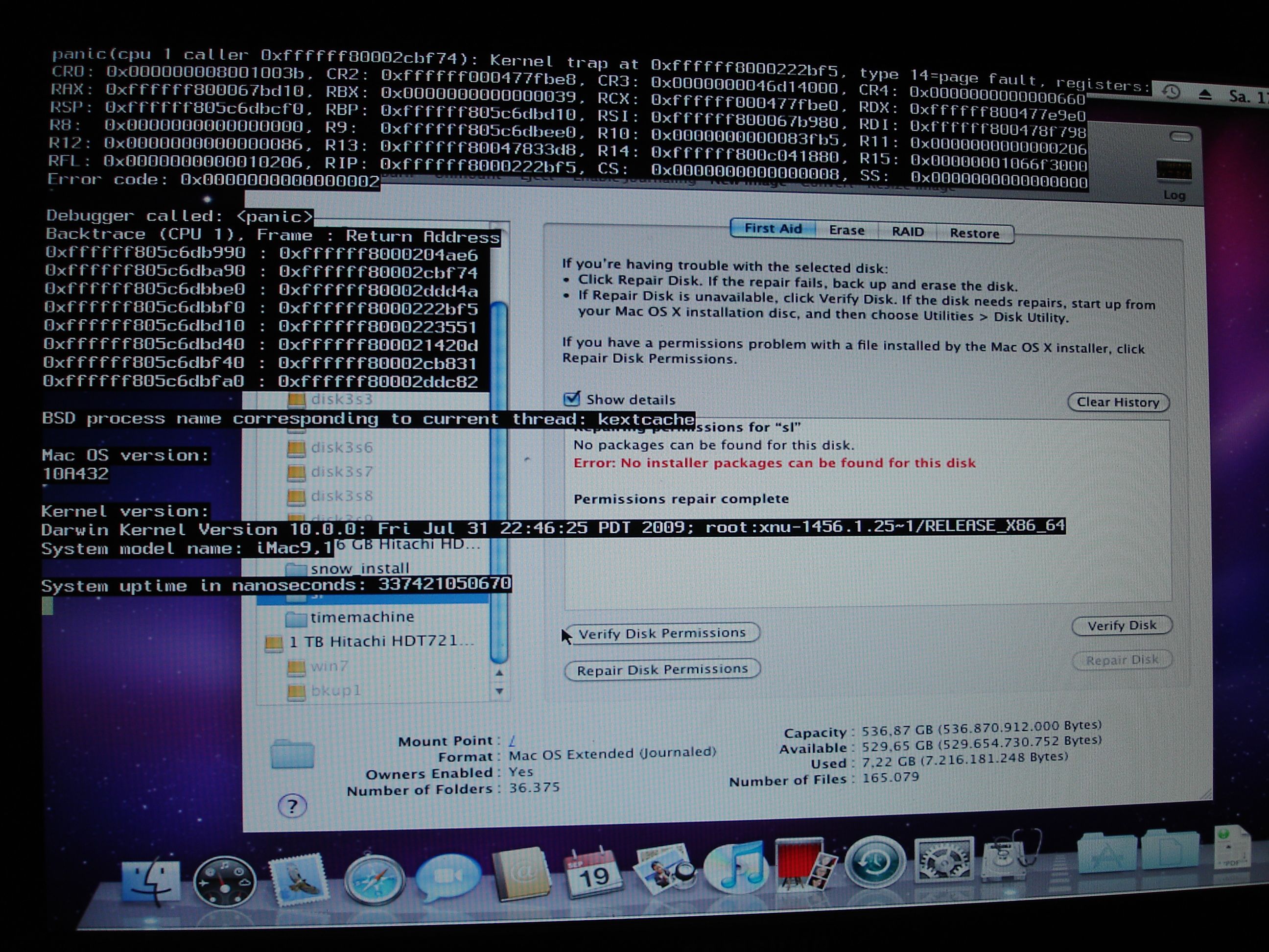

Excellent guide ricola, thank you I now have SL up and running on my Abit IP35 Pro XE after generating my own DSDT.aml in Windoze and copied it to /Extras . The only thing I needed to do differently was reinstall BSD.pkg from my existing Leopard system with Snow as the target. This is because SL was kernel panicing before I could get the BSD.pkg to complete its install. So after doing that and repairing disk permissions in SL then rebooting the system seems to be stable.

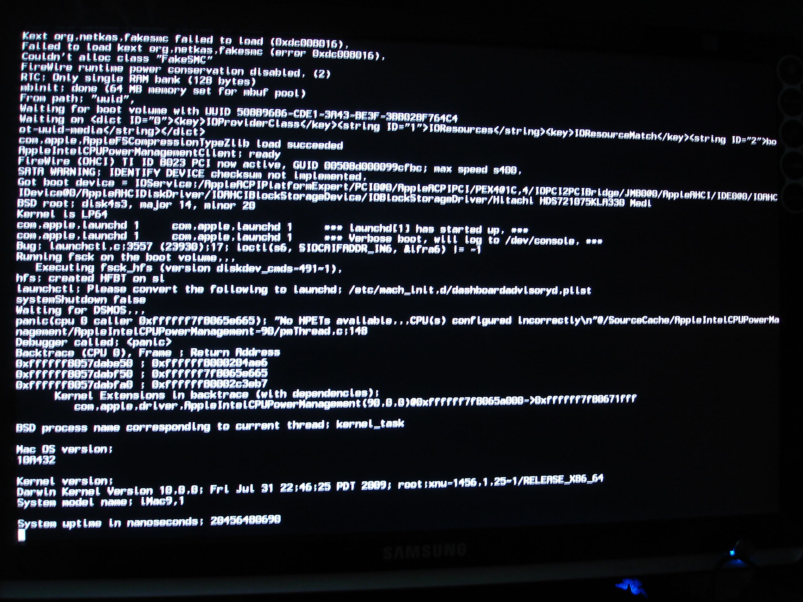

I do have an Abit IP35pro like yourself but when I tried your DSDT.aml I got a Kernal Panic after a couple minutes of booting into SL. I even tried everything from scratch again. The Kernal Panic seems to have to do with CPU 1 which is probably cause we don't the same CPU.
When I used my own DSDT.aml everything worked oob, no Kernal panics no crashing nothing. The only thing was the bios reset everytime i restarted. I have attached my own dsdt.dsl I compiled myself. If you can please try to compile it with the bios reset fix I would appreciate it.
Update:
Well, after using my own DSDT.aml I was still getting the same kernal panic. This never happened the first time I installed SL. I was able to figure out that it was my extensions.mkext somehow and it wasn't allowing me SL to run in 64 bits. I booted into 32 bit mode and ran kext utility and that fixed the kernal panic with my DSDT.aml. I'm going to try your DSDT.aml again to see if it'll work and update back. Thanks.
