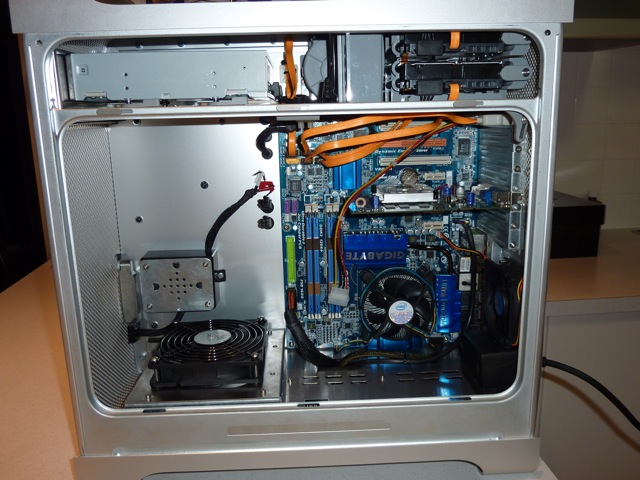

For any interested I built my PC into a G5 case, if you are planning to do the same I'm happy to share some tips. PM me.
