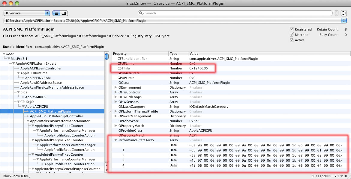

So, here's mine current situation. Finally, I managed to implement my CPU's 6 P-states in the DSDT (actually i modified your DSDT dated Nov 9th 2009) successfully :(
screenshot
I think i have implemented the C-states too, but I'm not quite sure, though.

So, here's mine current situation. Finally, I managed to implement my CPU's 6 P-states in the DSDT (actually i modified your DSDT dated Nov 9th 2009) successfully :D
Well done rednous, don't worry about it. We're all busy people :)
I am trying my best to learn how these DSDT's are pieced together and how the data corresponds to what?.. So at the moment my DSDT is a copied, hashed together and edited version of all the info I can gather. Mostly MasterChief's from the P5K Pro thread, mm67's and others from the Gigabyte Fix thread.
Your ioreg PerformanceStateArray shows 6 x P-States.

Your C-States look okay (as far as I can tell) and I see the data you have used in your SSDT. And I see you have used the data from the 'If (And (CFGD, 0x80))' section which gives you 414 and 416. Your SSDT table is exactly the same as mine and I didn't know what set of data to use (see my post here). So I ended up using 414 and 415 as others were using.
I don't know it if makes a difference or not, as as far as I can tell, my processor only seems to enter C1 so I don't know if the C2 & C3 data really comes in to play.

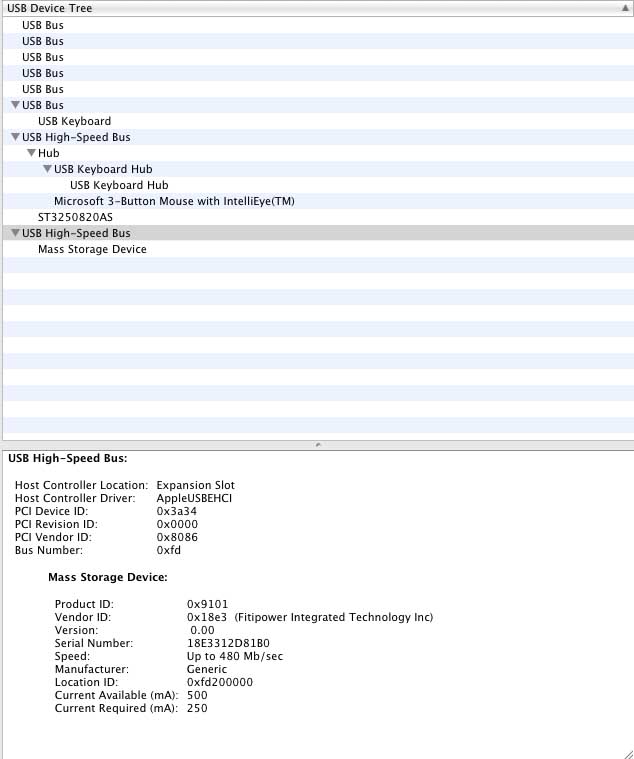

Everything works with one small exception.
I have sleep, wake, shutdown, restart, Video 8600GTS LAN, and even USB as well as Speedstep both pstate and cstate working.
My minor glitch remaining is with the external hd giving me an error after waking from sleep.
The USB Ports are showing up as built in with the exception of the one that the drive is plugged in to regardless of which usb port it's plugged into it still shows up as Expansion Slot AppleUSBEHCI So i'm just a tad confused.
I've posted my dsdt.dsl file hopefully someone can take a peek and tell me what i've done wrong.

Well done Capt_Boom ;)
Check your Return (MCID.... device ID's at the bottom of EHCI and UHCI. They both read 0x3A34. Mine report as 0x293A and 0x293C. See if that helps :)
Oddly enough i tried your suggestion and it had absolutely no change.

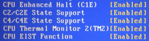

• I also went in to my Advanced BIOS Features screen and made sure I had the following enabled.
EDIT: Since writing this, there have been some advancements posted in the Gigabyte DSDT Fix Thread:
This one is regarding BIOS settings as a result of a discussion about SSDT tables.
This one is regarding C-States thanks to mm67 for his findings.

• You can see if P-States and C-States are working using IORegistryExplorer and looking at the data for ACPI_SMC_PlatformPlugin. CSTInfo shows C-States are loaded and PerformanceStateArray shows your P-States. Here's what mine looks like.
Hope that helps give a little insight? But remember this is a basic outline to help with FormerlyKnownAs' thread and you can find all answers and a hell of a lot more information there. http://www.insanelymac.com/forum/index.php?showtopic=181631
