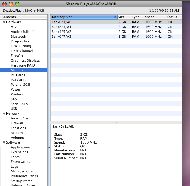

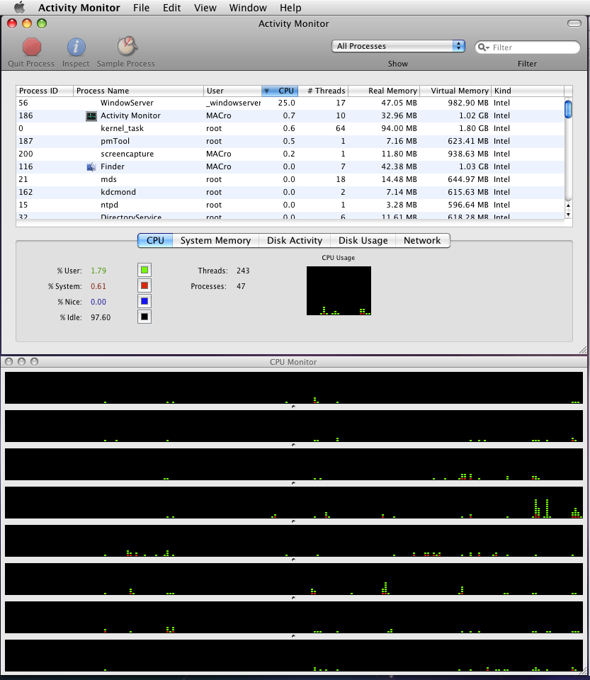

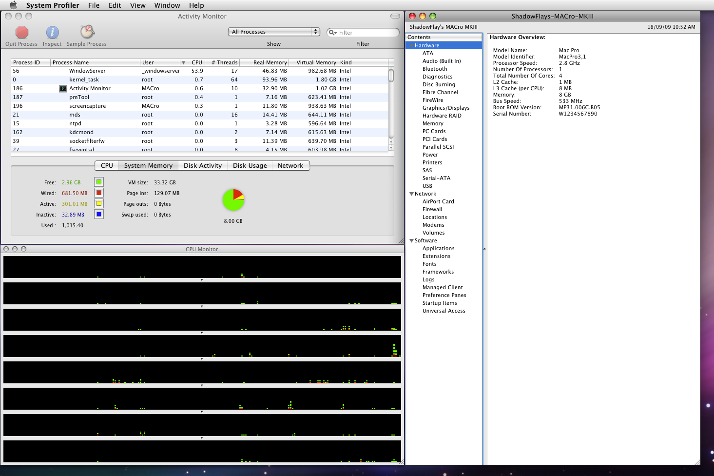

Shadowflay Posted September 18, 2009 Share Posted September 18, 2009 Here are the screen shots of the RAM displaying 8GB but the numbers in Activity monitor don't add up. However System Profiler shows 4x2GB DIMMS. In BIOS it says there are 2GB sticks in the second two slots however it also says they are not enable and I can't see for the life of my how to enable them. RTFM I hear you yelling.... I did, perhaps I am blind And here is how activity monitor sees the CPU. My question to all you guys with i7s of any kind is, is it usual to only have a single graph of CPU usage representing all the cores in the main activity monitor window as seen here while having 8 in the history window? I'll post results of changing voodoo power kext. Currently crashes on boot with -x (safe mode). Link to comment https://www.insanelymac.com/forum/topic/176155-new-intel-p55-mobos-core-i7-860-i5-750-cpu-lga1156/page/3/#findComment-1270973 Share on other sites More sharing options...
