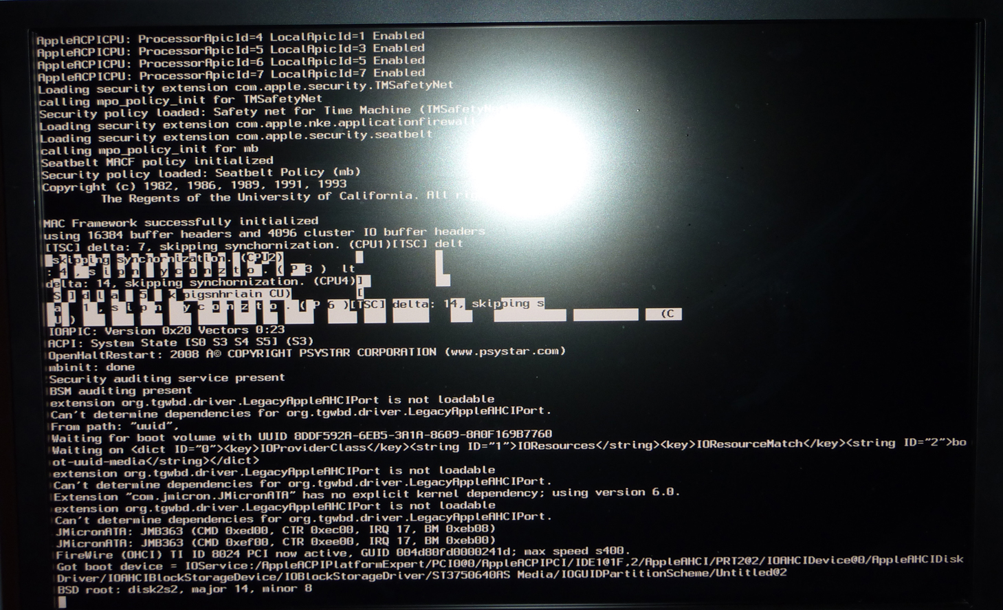

xkelly Posted September 20, 2009 Share Posted September 20, 2009 SOLVED WITH A WORKAROUND NOT SOLVED Just did a fresh install to see if my bus problems persist. They do. There is something odd with AHCI. It doesn't happen every time, but almost every time. When I reboot after making a system change or tweak (install application or pretty much anything), the system does not boot. It stops at this line... 'BSD root: disk2s2, major 14, minor 8' (I've attached a pic of the full screen.) And just sits there, mocking me. or this... 'The IOUSBFamily was not able to enumerate a device' (this line comes right after the BSD root line), sits there and eventually reboots. Rarely I can get back in without doing anything. But mostly I have to repair disk permissions by booting from the installer disk. After that, it usually goes straight into OS X and it works fine until I make some other change. I can't work like this. I spend most of my time using the installer disk and repairing permissions. See UPDATE 1. I'm still checking around the forums for similar problems, but if anyone has a handle on this, let me know. I think this is the only problem I have left as far as stability is concerned. Other than Sleep, that is. These are the options I selected on the iATKOS v7 install regarding AHCI & SATA: ---AHCI ---Intel SATA/IDE ---JMicron SATA/IDE I'm using the Qoopz 9.8 Voodoo variant. Thanks. UPDATE 1: repairing disk permissions wasn't fixing the problem. It was simply booting to the installer disk or Vista, then I can boot straight into OS X. The installer disk or Vista must reset something, but I don't know what. So here is is in a nutshell... -Get into OS X. -Restart or Shutdown -Can't get into OS X -Boot Vista or Installer Disl -Get into OS X, again. It must be hardware and some kext. I have three partitions of my initial install of iATKOS v7. Getting into one, borks access to the others until I boot into Vista or installer disk. Again: WTF UPDATE 2: My continuing saga with a work around. More info: I use an IOGEAR DVI 4 Port KVM, a powered 7 port USB hub and a Razer gaming mouse plugged into three USB ports on the back of the system. Following-up on the IOUSBFamily message and some ideas from other posts, I disconnected the KVM and hub, then moved the keyboard and mouse to the front ports. The reboot problem becomes less persistent, but was still there. Then I found an interesting post where some USB KVM problems were solved by plugging the KVM into a powered hub (fyi - my KVM is also powered). So I plugged everything into my powered hub (KVM and mouse)... and now everything works. I've rebooted, shutdown and have been able to get back into OS X without having to go into Vista first. So that means what? There are instabilities with my install and USB? I wonder if there is a kext or kernel fix for this? I'll dig around a bit more, this week. ------------ In case anyone was wondering why I don't plug my mouse into the KVM... it's because most KVM's won't support gaming mice. When I switch back and forth between systems, the gaming mouse would freeze. So since I game on my Vista/Hack system, I keep the Razer plugged into there and use another mouse for my Macbook Pro. Link to comment Share on other sites More sharing options...

f_ender Posted September 22, 2009 Share Posted September 22, 2009 SOLVED WITH A WORKAROUND NOT SOLVED Just did a fresh install to see if my bus problems persist. They do. There is something odd with AHCI. It doesn't happen every time, but almost every time. When I reboot after making a system change or tweak (install application or pretty much anything), the system does not boot. It stops at this line... 'BSD root: disk2s2, major 14, minor 8' (I've attached a pic of the full screen.) And just sits there, mocking me. or this... 'The IOUSBFamily was not able to enumerate a device' (this line comes right after the BSD root line), sits there and eventually reboots. Rarely I can get back in without doing anything. But mostly I have to repair disk permissions by booting from the installer disk. After that, it usually goes straight into OS X and it works fine until I make some other change. I can't work like this. I spend most of my time using the installer disk and repairing permissions. See UPDATE 1. I'm still checking around the forums for similar problems, but if anyone has a handle on this, let me know. I think this is the only problem I have left as far as stability is concerned. Other than Sleep, that is. These are the options I selected on the iATKOS v7 install regarding AHCI & SATA: ---AHCI ---Intel SATA/IDE ---JMicron SATA/IDE I'm using the Qoopz 9.8 Voodoo variant. Thanks. UPDATE 1: repairing disk permissions wasn't fixing the problem. It was simply booting to the installer disk or Vista, then I can boot straight into OS X. The installer disk or Vista must reset something, but I don't know what. So here is is in a nutshell... -Get into OS X. -Restart or Shutdown -Can't get into OS X -Boot Vista or Installer Disl -Get into OS X, again. It must be hardware and some kext. I have three partitions of my initial install of iATKOS v7. Getting into one, borks access to the others until I boot into Vista or installer disk. Again: WTF UPDATE 2: My continuing saga with a work around. More info: I use an IOGEAR DVI 4 Port KVM, a powered 7 port USB hub and a Razer gaming mouse plugged into three USB ports on the back of the system. Following-up on the IOUSBFamily message and some ideas from other posts, I disconnected the KVM and hub, then moved the keyboard and mouse to the front ports. The reboot problem becomes less persistent, but was still there. Then I found an interesting post where some USB KVM problems were solved by plugging the KVM into a powered hub (fyi - my KVM is also powered). So I plugged everything into my powered hub (KVM and mouse)... and now everything works. I've rebooted, shutdown and have been able to get back into OS X without having to go into Vista first. So that means what? There are instabilities with my install and USB? I wonder if there is a kext or kernel fix for this? I'll dig around a bit more, this week. Hi xkelly, You probably want to check this topic: http://www.insanelymac.com/forum/index.php?showtopic=117029 I had issues with my USB Audio recording interface so I had to upgrade the IOUSBFamily.kext driver to the new version. Regard, f_ender Hi there, Just an update, The Sound works great with both INs and OUTs http://www.insanelymac.com/forum/index.php?showtopic=140941 USB Patch http://www.insanelymac.com/forum/index.php?showtopic=117029 I have also few errors in the log reported in the thread below but this could be just effect of trying different kexts to get HD audio working properly. http://www.insanelymac.com/forum/index.php?showtopic=129058 FIREWIRE does not work. ....yet. It's just matter of time with great support of developers out there. Thanks for making MAC OSX more affordable for testing. Regards, f_ender Link to comment Share on other sites More sharing options...

tonymacx86 Posted September 22, 2009 Share Posted September 22, 2009 About This Mac shows '8 GB 1333MHz RAM'. Update- it now shows 4GB 1333Mhz RAM- played with different smbios files. When I reboot after making a system change or tweak (install application or pretty much anything), the system does not boot. It stops at this line... 'BSD root: disk2s2, major 14, minor 8' (I've attached a pic of the full screen.) And just sits there, mocking me. I am getting this same boot freeze about 1 in every 10 boots. Seems like it is something to do with my IDE HD and DVDRW drives or 2nd partitions on SATA drives. For now, I'm just resetting, and more often than not, it is fine. I think I can live with it, as I don't reboot very often. Link to comment Share on other sites More sharing options...
