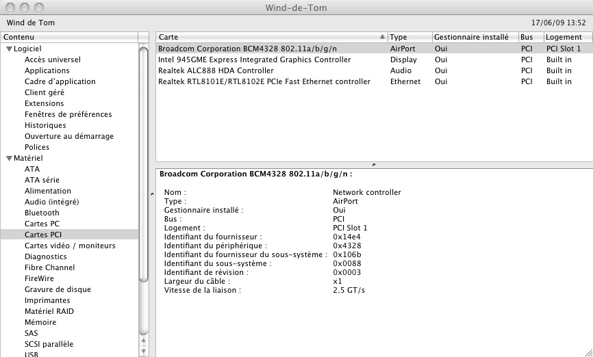

Flashe Posted October 19, 2009 Share Posted October 19, 2009 Hi, The problem I encounter is that in the information system there is nothing that appears. No PCI card seems to be installed on this computer. This Ethernet cards not to reference in info system: Adaptateur Ethernet (en1) Built-in Serial Port (1) Ethernet I have: Marvell Yukon 88E8056 PCI-E Gigabit Ethernet Controller Realtek RTL8169/8110 Family Gigabit Ethernet NIC Realtek RTL8187 Wireless 802.11g 54Mbps USB 2.0 Network Adapter Analog Devices AD1988B @ Intel 82801IB ICH9 - High Definition Audio Controller Possible to fix the dsdt more information about devices(Pci/Pcie) ect ect....... I know this is cosmetic but would know when one connects those who are multiple Ethernet ports on which it is plugged in info system and about how such slot pci card and each other are connected . Thanks a lot for the help, you can give me, I attached files to this poste . My dsdt is what post above,sleep work for me fixe by Don Quijote. Example of devices injecter pci and other,me i don't have. Ioreg_P5K_Premium.rtf Lspci.rtf Link to comment https://www.insanelymac.com/forum/topic/168014-dsdt-trick-retail-drivers-by-changing-device-id-eg-usb/page/11/#findComment-1303490 Share on other sites More sharing options...
