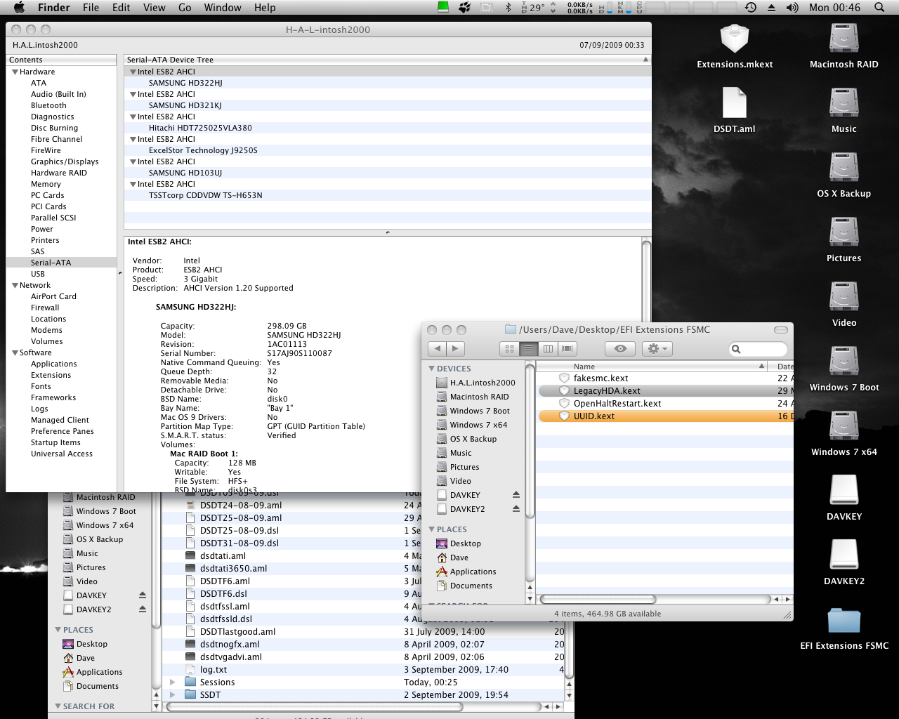

FKA Posted September 6, 2009 Share Posted September 6, 2009 Look at my posting.Ist doesnt really matter WHICH device-id you inject in the dsdt. I got the abolut same (good) results with dsdt ICH9(my real id) and ESB2 (macPro id). I will get back to ICH 9 because that also worked like it should. I don't know if you've tried with ICH9 mitch but with my ICH9-R if I inject ICH9 or ICH10 id I still need IOAHCIBlockStorageInjector.kext If I inject ESB2 I don't need either IOAHCIBlockStorageInjector.kext or AHCIPortinjector.kext D. ESB2 is the southbridge in MacPro circ' 2006.##edit## post#5 http://www.insanelymac.com/forum/index.php?showtopic=23896 It seems some people hvae had sucsess with ESB2 in RAID mode on the MacPro. here I wonder how this would work with ICH-9 in RAID mode on a Hack? I'll give it a go later on. D. Just tried to boot my none raid back-up drive with boot132 and IHC9 in RAID mode. Didn't work! "waiting for root device" worth a pop though Link to comment https://www.insanelymac.com/forum/topic/168014-dsdt-trick-retail-drivers-by-changing-device-id-eg-usb/page/9/#findComment-1254769 Share on other sites More sharing options...

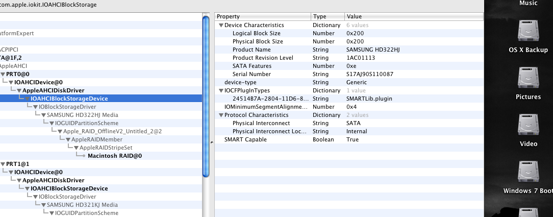

mitch_de Posted September 7, 2009 Share Posted September 7, 2009 "I don't know if you've tried with ICH9 mitch but with my ICH9-R if I inject ICH9 or ICH10 id I still need IOAHCIBlockStorageInjector.kext If I inject ESB2 I don't need either IOAHCIBlockStorageInjector.kext or AHCIPortinjector.kext " Ok, i only testet without AHCIPortinjector.kext , - ICH 9 dev id or ESB2 dev-id - both worked in DSDT. I havent not tested to remove also the orange HD icon fix = IOAHCIBlockStorageInjector.kext with ICH 9 dev id or ESB2 dev-id in DSDT. Theoretical if the Port injection works with both id´s also the Block storage injection should be not needed anymore with one of the dev-ids. Link to comment https://www.insanelymac.com/forum/topic/168014-dsdt-trick-retail-drivers-by-changing-device-id-eg-usb/page/9/#findComment-1255447 Share on other sites More sharing options...
FKA Posted September 7, 2009 Share Posted September 7, 2009 "I don't know if you've tried with ICH9 mitch but with my ICH9-R if I inject ICH9 or ICH10 id I still need IOAHCIBlockStorageInjector.kextIf I inject ESB2 I don't need either IOAHCIBlockStorageInjector.kext or AHCIPortinjector.kext " Ok, i only testet without AHCIPortinjector.kext , - ICH 9 dev id or ESB2 dev-id - both worked in DSDT. I havent not tested to remove also the orange HD icon fix = IOAHCIBlockStorageInjector.kext with ICH 9 dev id or ESB2 dev-id in DSDT. Theoretical if the Port injection works with both id´s also the Block storage injection should be not needed anymore with one of the dev-ids. Theoretically, yes but in practice (for ICH9-R) removing IOAHCIBlockStorageInjector.kext with id set to ICH9 or ICH10 gives orange icons. Only with id set to ESB2 are the icons gray without IOAHCIBlockStorageInjector.kext . ICH10 ESB2 D. Additional: You can see the IOAHCIBlockstorage and IOAHCIDevice are seen as external with ICH9 or ICH10 and internal with ESB2 ICH10 ESB2 So as both ICH10 and ESB2 have native support in OS X why is this? D. Link to comment https://www.insanelymac.com/forum/topic/168014-dsdt-trick-retail-drivers-by-changing-device-id-eg-usb/page/9/#findComment-1255512 Share on other sites More sharing options...

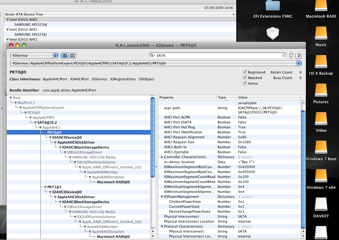

ApexDE Posted September 7, 2009 Share Posted September 7, 2009 I guess AHCI Port Hotplug = True / False is making the difference Link to comment https://www.insanelymac.com/forum/topic/168014-dsdt-trick-retail-drivers-by-changing-device-id-eg-usb/page/9/#findComment-1255578 Share on other sites More sharing options...

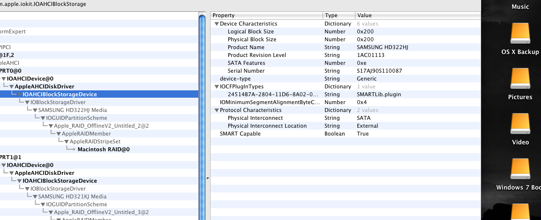

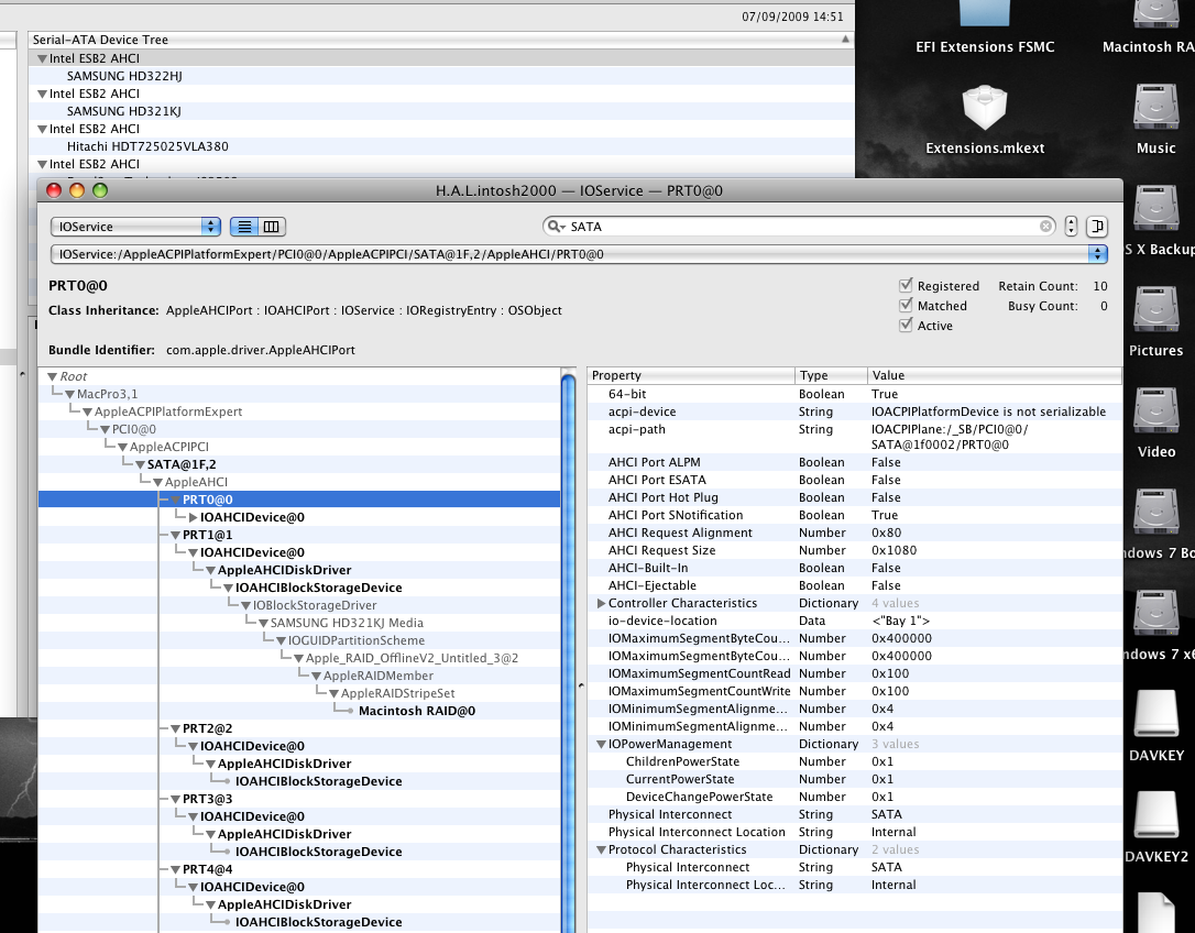

FKA Posted September 7, 2009 Share Posted September 7, 2009 Please note this does NOT work - For reference ONLY Ok I've tried applying the Method (_DSM ...) to the route SATA device as well as to each port (bay) and setting id to ICH9. Thus: Device (SATA) { Name (_ADR, 0x001F0002) Name (_SUN, One) } [b][color="#ff0000"]Method (_DSM, 4, NotSerialized) { Store (Package (0x03) { "Physical Interconnect Location", "Internal", Buffer (0x01) { 0x01 } }, Local0) DTGP (Arg0, Arg1, Arg2, Arg3, RefOf (Local0)) Return (Local0)[/color][/b] Device (PRT0) { Name (_ADR, Zero) Method (_GTF, 0, NotSerialized) { Name (PIB0, Buffer (0x07) { 0x00, 0x00, 0x00, 0x00, 0x00, 0xA0, 0xF5 }) Return (PIB0) } Method (_DSM, 4, NotSerialized) { Store (Package (0x06) { "Physical Interconnect", "SATA", "Physical Interconnect Location", "Internal", "io-device-location", Buffer (0x06) { "Bay 1" } }, Local0) DTGP (Arg0, Arg1, Arg2, Arg3, RefOf (Local0)) Return (Local0) } This doesn't work but could it be the right way to go??? **EDIT** it does compile and show device as ICH9 but drives still listed as external D. Link to comment https://www.insanelymac.com/forum/topic/168014-dsdt-trick-retail-drivers-by-changing-device-id-eg-usb/page/9/#findComment-1255656 Share on other sites More sharing options...
kdawg Posted September 7, 2009 Share Posted September 7, 2009 Please note this does NOT work - For reference ONLY Ok I've tried applying the Method (_DSM ...) to the route SATA device as well as to each port (bay) and setting id to ICH9. Thus: Device (SATA) { Name (_ADR, 0x001F0002) Name (_SUN, One) } [b][color="#ff0000"]Method (_DSM, 4, NotSerialized) { Store (Package (0x03) { "Physical Interconnect Location", "Internal", Buffer (0x01) { 0x01 } }, Local0) DTGP (Arg0, Arg1, Arg2, Arg3, RefOf (Local0)) Return (Local0)[/color][/b] Device (PRT0) { Name (_ADR, Zero) Method (_GTF, 0, NotSerialized) { Name (PIB0, Buffer (0x07) { 0x00, 0x00, 0x00, 0x00, 0x00, 0xA0, 0xF5 }) Return (PIB0) } Method (_DSM, 4, NotSerialized) { Store (Package (0x06) { "Physical Interconnect", "SATA", "Physical Interconnect Location", "Internal", "io-device-location", Buffer (0x06) { "Bay 1" } }, Local0) DTGP (Arg0, Arg1, Arg2, Arg3, RefOf (Local0)) Return (Local0) } This doesn't work but could it be the right way to go??? **EDIT** it does compile and show device as ICH9 but drives still listed as external D. I've tried this and every other combination you can think of. I've been poking around and noticed the _removable or _ejectable attributes in Apple's open source for IOStorageFamily>IOBlockStorageDriver.cpp, check out line 1649 on. This is where it actually defines what icon to use. I've played around with trying to inject properties for those two attributes with no luck. The answer has to be in there somewhere! attributes |= _ejectable ? kIOMediaAttributeEjectableMask : 0; // <--Does this attribute trigger Internal/External?? attributes |= _removable ? kIOMediaAttributeRemovableMask : 0; // <--Does this attribute trigger Internal/External?? result = m->init( base, /* base byte offset */ byteSize, /* byte size */ blockSize, /* preferred block size */ attributes, /* attributes */ true, /* TRUE if whole physical media */ !_writeProtected, /* TRUE if writable */ ""); /* content hint */ if (result) { char *picture = "External.icns"; if (_removable) { picture = "Removable.icns"; } else { OSDictionary *dictionary = OSDynamicCast(OSDictionary, getProvider()->getProperty(kIOPropertyProtocolCharacteristicsKey)); if (dictionary) { OSString *string = OSDynamicCast(OSString, dictionary->getObject(kIOPropertyPhysicalInterconnectLocationKey)); if (string) { if (string->isEqualTo(kIOPropertyExternalKey)) { picture = "External.icns"; } else { picture = "Internal.icns"; } } } } IOBlockStorageDriver.cpp.zip http://www.opensource.apple.com/ Link to comment https://www.insanelymac.com/forum/topic/168014-dsdt-trick-retail-drivers-by-changing-device-id-eg-usb/page/9/#findComment-1255845 Share on other sites More sharing options...

kdawg Posted September 8, 2009 Share Posted September 8, 2009 I've experianced a KP since adding ESB2 id.Repaired permissions and all appears OK since - However I think mitch_de is right in using the motherboards native SATA driver id and IOBlockStorageinjector.kext. D. Yeah I'm back to using ICH10. Link to comment https://www.insanelymac.com/forum/topic/168014-dsdt-trick-retail-drivers-by-changing-device-id-eg-usb/page/9/#findComment-1256834 Share on other sites More sharing options...
