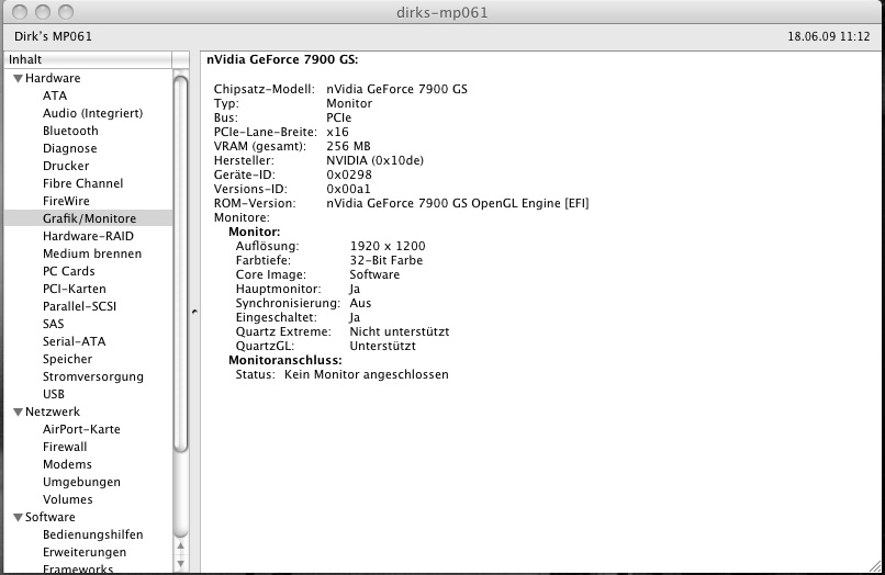

TheGreatDeceiver Posted June 24, 2009 Share Posted June 24, 2009 Well, I have also an Inspiron 9400 with T7200 and a GeForce Go 7900 GS.I also have the OpenGL-Problem. I tried cogombo's way and it didn't work. I tried your way and it also doesn't work, my system knows now, that my videocard has OpenGL but I cannot use it (see picture). I tried nearly everything now, I can't count how many kext's I tried before but every time it tells me, that QE is disabled. I forced QuartzGL to work via OSX86Tools. I have no clue what I can do else to make OpenGL work and I really need it for Aperture, CS4 and my Videos. I really need help. I apologize about my bad English, I'm German. So long, Dirk Edit: Ups, forgot to say that I'm working with 10.5.6 sorry, silence doesn't mean people are ignoring you. I have no clue how to help. Maybe you were already able to fix it by now. Your english is perfectly fine Mensch, kein Grund sich zu entschuldigen bis spaeter Bad news guys, I have a fatal issue: suddenly when I was on MAC, the system freezes and only I could see the death's spinning pizza wheel!!! I rebooted the system and in -v loading it shows a BAD FAILURE: Bsd root: disk0s2, major 14, minor 2 Disk0s2: I/O error I've tried to boot with -x or -f and nothing, tried to repair disk with disk utility (from DVD install) and fails in verification. Fortunately I can boot in XP, but if I explore my HFS partition with HFSExplorer, there are some folders that I can't access, like "system", the program says there's an error. (But fortunately I can access to my user's documents folder). I have a HD Hitachi 7200rpm 80Gb (HTS721080G9SA00). What happened? ¿How can I solve that? Is my hard disk broken? Can OSX86 break hard disks? Can fix it reinstalling OSX? in that case, how can I prevent this? OSX will not break your disk per se. Here is what I would do. You say you got dual boot with XP. Use Acronis True image and make a backup image of the entire OSX partition (byte by byte, no compression). It may fail because of the same reason. It may work. If it works, go into XP Administrative Tools/disk management and delete that OSX partition you just backed up. Create a FAT32 or NTFS partition and format. Run checkdisk on it or some other disk tool that scans the surface of your drive. If there are bad sectors it will mark them and make them not usable (basically invisible to the system). This may however prevent you from putting the OSX image back onto the same partition using Acronis TrueImage. That would be the next step. you see there are a lot of ifs. You may want to image the entire hdd, wipe it clean, scan it (Hiren's Boot CD) and put the image back using Acronis TrueImage. good luck. is it possible to make a retail install of leopard with boot 123 usb stick on a Dell Inspiron 6400 with an intel 945GM?I can boot it but I can get keyboard and trackpad working.. where i have to put the kext? in the usb stick or in the installation volume? Sonotone has a boot 132 for Dells already in his thread. It puts the correct kexts into the Extra folder and everything is working (at least was on mine). Link to comment https://www.insanelymac.com/forum/topic/15474-guide-dell-inspiron-6400940015201720e1405e1505e1705-intel-core-duo/page/88/#findComment-1184532 Share on other sites More sharing options...
country1706 Posted June 24, 2009 Share Posted June 24, 2009 sorry, silence doesn't mean people are ignoring you. I have no clue how to help. Maybe you were already able to fix it by now. Your english is perfectly fine Mensch, kein Grund sich zu entschuldigen bis spaeter Yep, I was able to fix it, I went back to Windows I just gave up after three weeks There was no way to fix it anyhow. At least I had one more problem, with the new EFI from sonotone my CPU temp raised to high, so my Mac OS told me to shut down the notebook with the Powerbutton, there was no other way any more, cause I couldn't do anything with my system when this happened. I had a Mac OS Greyscreen (don't know how it's told, but it's similar to the Windows-Bluescreen). I never thought that nobody wants to help me and ignores me. I think nobody could help me. I know its hard to help when you're not personal at the Computer. But I appreciate that so many members are trying Ach ja, danke für das Kompliment Ich werd mich erst mal hier ausklinken, bringt ja nichts mehr mit einem Windoofs System Thanks everybody who tried to help me. Link to comment https://www.insanelymac.com/forum/topic/15474-guide-dell-inspiron-6400940015201720e1405e1505e1705-intel-core-duo/page/88/#findComment-1184801 Share on other sites More sharing options...
