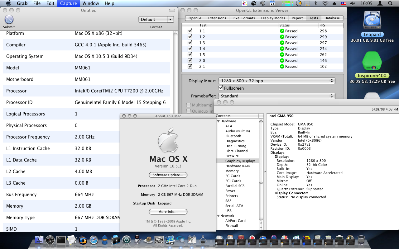

valkenmaster Posted June 15, 2008 Share Posted June 15, 2008 Hi, I have a Inspiron 6400 and I have problems with my video ( Intel 945 ) Everything works perfect, but in 'About my Mac' he said that I have 64 MB of video. But it should be 128 mb. Now I would like to install Apple Logic Studio. In the instalation I get a error because I have 0 MB video and 64 mb is recommend. This is very strange because I did have 64 mb of video Strange enough that had to be 128 MB. Now I can not skip that step and the program quit the installation because I have not enough video ram. Does anyone know how to fix this? Thank you! Link to comment https://www.insanelymac.com/forum/topic/15474-guide-dell-inspiron-6400940015201720e1405e1505e1705-intel-core-duo/page/61/#findComment-784299 Share on other sites More sharing options...

TheGreatDeceiver Posted June 16, 2008 Share Posted June 16, 2008 Hi,I have a Inspiron 6400 and I have problems with my video ( Intel 945 ) Everything works perfect, but in 'About my Mac' he said that I have 64 MB of video. But it should be 128 mb. Now I would like to install Apple Logic Studio. In the instalation I get a error because I have 0 MB video and 64 mb is recommend. This is very strange because I did have 64 mb of video Strange enough that had to be 128 MB. Now I can not skip that step and the program quit the installation because I have not enough video ram. Does anyone know how to fix this? Thank you! 64mb is all that you will see in OSX, has been reported in other posts as well. Not sure about your Logic Studio problem. Apparently Logic Studio does a hardware check and has no clue about the hackintosh video hardware and reports 0. Hope somebody can help you. good luck Link to comment https://www.insanelymac.com/forum/topic/15474-guide-dell-inspiron-6400940015201720e1405e1505e1705-intel-core-duo/page/61/#findComment-785164 Share on other sites More sharing options...

auqs10 Posted June 28, 2008 Share Posted June 28, 2008 Hi all you Dell lovers. Finally I had enough time and I was able to update my Inspiron 6400/E1505 from 10.5.2 to 10.5.3 with the Combo Update. http://forum.insanelymac.com/index.php?s=&...st&p=653838 I used the indications that were also used for updating to 10.5.2. http://forum.insanelymac.com/index.php?s=&...st&p=761779 First problem with the Intel 945GM card was solved by replacing the AppleIntelIntegratedFrameBuffer.kext and then for system correct recognition (as it was produced by Dell with factory associated code MM061) by replacing AppleSMBIOS.kext and finally I repaired permissions. How to change it was not difficult but a bit tricky. I used MacDrive from Windows Vista to replace the first kext for Intel 945GM and then I used install DVD Leo4All-v3 to repair the permissions for it. I chose this way because the laptop entered in a black screen after the gray apple boot screen, without possibility to make any changes in the system. I forgot to mention that sound (Sigmatel9200) was solved using Taruga's v1.20 and the dumpcode specifically for this on-board card. So, I succeeded to have the up-to-date version and everything is working fine. The screen capture for those non-believers is attached. Link to comment https://www.insanelymac.com/forum/topic/15474-guide-dell-inspiron-6400940015201720e1405e1505e1705-intel-core-duo/page/61/#findComment-799356 Share on other sites More sharing options...
