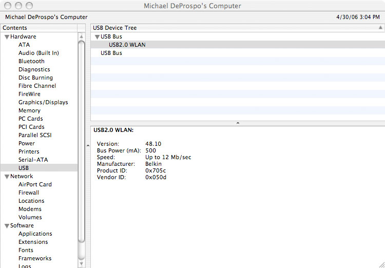

I went out and bought this card...i installed the drivers...doesnt show up ne where. although in system prefs..., it reconizes it as a usb WLAN, and it knows its made by Belkin. I am now running 10.4.5. I down graded from 10.4.6 cause i figured well maybe it will only work under 10.4.5....PLEASE help, i need wireless! i hate windows with a passion now. lol.

One thing ive noticed is it is ver 4000, not 3000. And, i how do u check the ver num? I have this. post-17496-1146538866_thumb.jpg
You're looking at the wrong numbers there. It's not a matter of 3000 or 4000. Look at the adapter itself to see if it's B1 or C1. I seriously doubt it's anything other than C1, as that's the version currently stocked at most suppliers.
