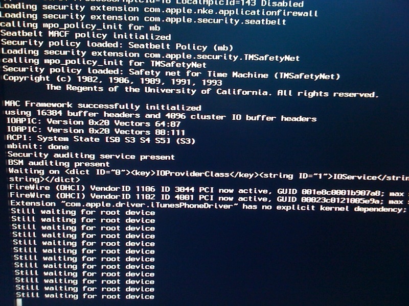

quick info for the people that are stuck with "still waiting for root device" before installing: make sure your Optical and Hard Drive are plugged into SATA Port 1 & 2 (thats the port-stack closest to the RAM on my P6T-D V2).
I got these errors for the longest time because my drives were plugged into 3 & 4.
Not sure I agree, as the disk I installed to is on S-ATA3, and the optical drive I installed it from is on S-ATA5.. Did you have any other devices connected to ports 1 and 2 and that time?

Hi,
During installation im stuck (Step C.4. Install Leopard) with
"Error Fire Wire..."
etc.
using OSX Leopard 10.5.6 Backup DVD
i also tried rd=disk1s2 instead rd=disk1s3 as mentioned above for Backup DVD. But same result.

Hi,
etc.

With other chipsets you can not use a backup DVD, you need to use a retail DVD. I doubt an i7 install would be different.
I have the P6T-D V2 as well but am stuck on C.3 with the "Still waiting for root device" message. I have my bios settings set according to B.
I have a samsung sata dvd and velociraptor sata hd. I have tried them on SATA ports 1 & 2, 1 & 6, 2 & 6 but no luck. I have tried multiple rd=diskXsY combinations using disk1s3, disk1s2, disk1s1, disk0s2, disk0s3. None have been successful. I have also tried putting in the boot-uuid with no luck. I am using a retail 10.5.6 retail DVD.
Any suggestions?
Edit: I switched my DVD to SATA port 1 and HDD to SATA port 2 and for some reason this made everything work using disk1s3... installing now
